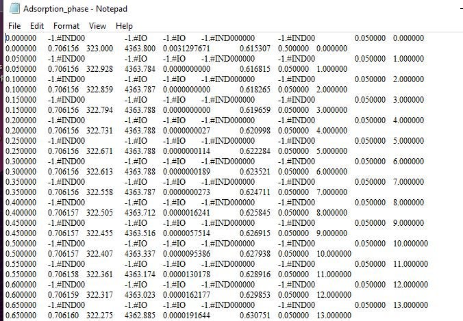

      Hello all,
      I am using udf to print the variables in a text file. It is printing the results but for each timestep, it is printing two times. First, it is showing the correct values and next time it is printing  -1#IND00 values. I don't know the reasong for printing like this. I am attaching the image of the printing file. Please reply if anyone knows about the issue.
      Thank you...
      How many nodes are you running on? How many phases are there?
    • Raheem Shaik (IIT KGP)
      Parallel (local machine)
      solver processes: 1
      Fluent is running on 6 CPU cores.
      Domain is having 12000 nodes and only single phase is there.
      OK, so it's not likely to be a parallel issue. If you set up a report for those values in Fluent how does the plot look?
      Plots are normal. It is taking correct values only for every time step. Only problem is with printing.

      First error in printing now got resolved. Actually problem is with udf Define_execute_at_end where i gave file open pointer inside the macro. Now I have kept it before the macro. It is printing correctly now without -1#IND00 values..
