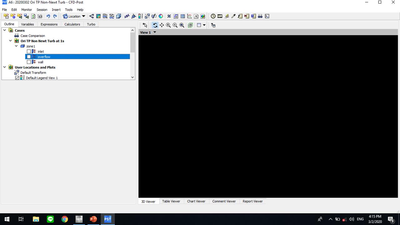

      I am using Ansys Student Version R3. Imported file into Design Modeler in '.agdb' format.
      Simulating a dimension of 200mm x 100mm x 50mm object with default meshing parameter.
      Under 'Setup' panel, several models were activated
      - Energy model
      - Melting and Solidification model
      - k-e model
      I had tried several times, but the end result of simulation couldn't show at 'Result' panel.
      Kindly advise me on this matter, Thank You.

      My apologies for the attachment error, here is the image.

      Don't think it's a Flash problem. Have a look on here for "black screen" as you're not the first to encounter it. From memory it's something to do with your graphics card.

      Dear Sir, thank you for the suggestion.
      It is working now, Thank You
