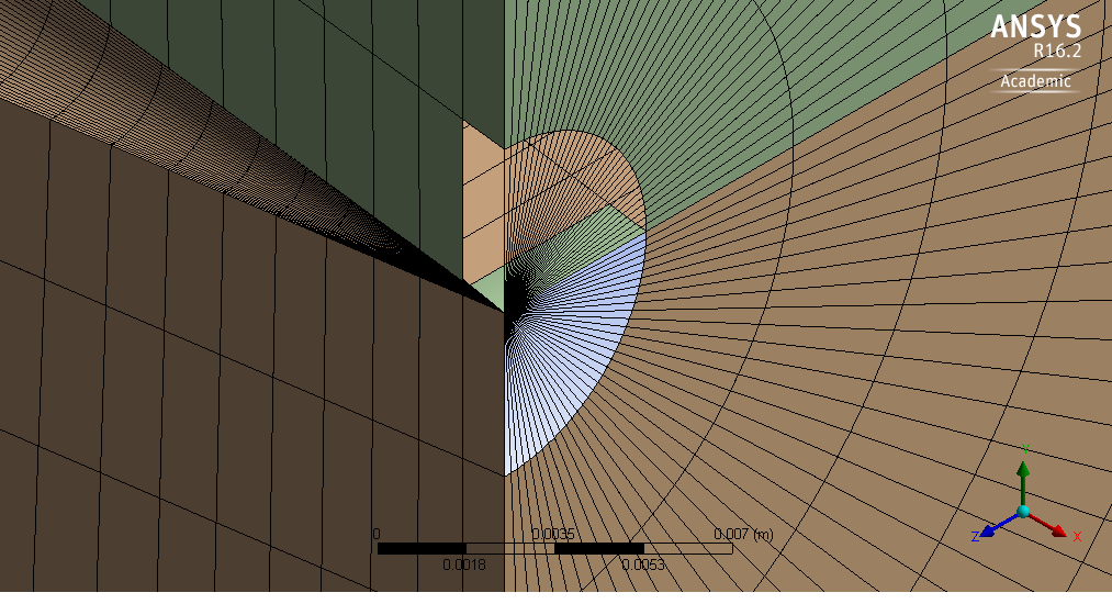

SubscriberHi, I am meshing two spherical body with multizone mesh method. Meshing is completed but getting bad quality elements near the discontinuity and because of which, getting error while transferring mesh in Fluent. how can I improve mesh quality.

November 9, 2020 at 6:28 amKeyur Kanade
Ansys EmployeeI am not sure how did you use multizone. nCan you please use tetrahedron method with inflation? nIt should be good for Fluent. nRegards,nKeyurnGuidelines for Posting on Ansys Learning ForumnHow to access ANSYS help linksnnNovember 9, 2020 at 1:23 pmak_thawait
SubscriberThank you very much for your response. I am not using inflation. Using only edge sizing with bias factor. I am using automatic source target selection for multizone method. Actually these are not complete parts for the analysis, there are more parts. I am meshing flow domain around a 3D finite wing. These parts contain tip portion of the wing. Remaining parts I have meshed with Hex elements, So I want to use Hex mesh for these two parts also. Is is not possible to use Hex elements? nThanks.nNovember 10, 2020 at 5:09 amKeyur Kanade
Ansys EmployeeFrom 3 images you have uploaded it is not clear about how your geometry is. So can not comment on hex mesh. nYou can always get hex mesh with wing geometries. You will need to decompose the geometry in SpaceClaim or DM. There are many videos on the same on youtube. nRegards,nKeyurnGuidelines for Posting on Ansys Learning ForumnHow to access ANSYS help linksnnJanuary 6, 2021 at 10:07 amak_thawait
