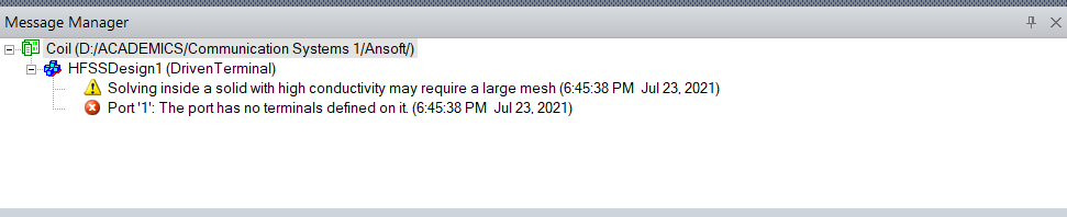

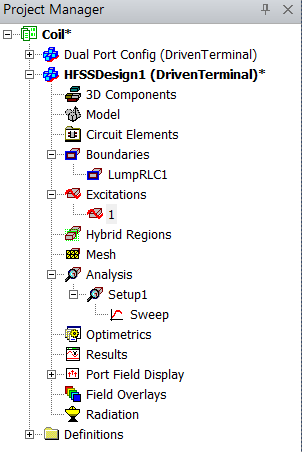

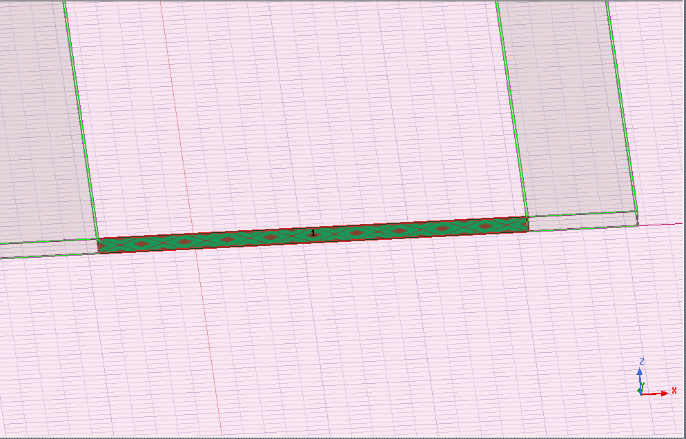

Ansys Employee.Hi AbhishekKM,
Do you have any conductors defined in your model?
Please provide more details about your model to help us serve you better.
All the very best.
.July 26, 2021 at 1:09 amAndyJP
Subscriber.The Lumped Port is a lumped resistor (type of a boundary) on a dielectric beneath, with two opposite sides contacting a conductor (or a conductive boundary), and two other sides contacting a dielectric. The integration line (applied voltage vector) should be defined. A lumped resistor should be located inside the model, and not on its outer boundary; contrary tho the wave port.
