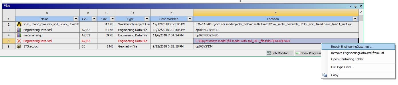

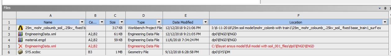

Subscriber There is also another question How can I know which material is material 21?
December 24, 2018 at 1:41 pm
Rana Nasser
The previous pictures was taken from the model before changing the base excitation file and resolve the model (it was a solved model then I made a save as file to make some changes then i tried to solve it again when the mentioned error appeared and stopped the solution)
the first pic. appeared when I opened he file after it was solved and closed, the second one is the files from view menu.
when I hit repair as shown in the 3 rd pic. a browsing window was opened and I followed the location bath and selected the ".xml" file of the engineering data folder after that the text in row 5 become black like the other rows, but when I close the project and open it again I find the same message. Also when I was trying to make an archived file a there is warning message talks about the missing file. Is there a relation between that and the error in the previous post?    Â
December 24, 2018 at 2:16 pm
peteroznewman
SubscriberI know that when the Geometry file is missing, that doesn't affect the ability of the solver to run. It does affect the ability to edit the geometry. I don't think this missing file has anything to do with your error.
The model stopped with the same error on the material: The material solution failed for element 18862 with material 21.
If you are using a material model that has an equation that becomes undefined if tensile stress is applied to the element, then there is no solution after that point. I believe this may be happening in your model.
I don't know how to find out which material is 21.
