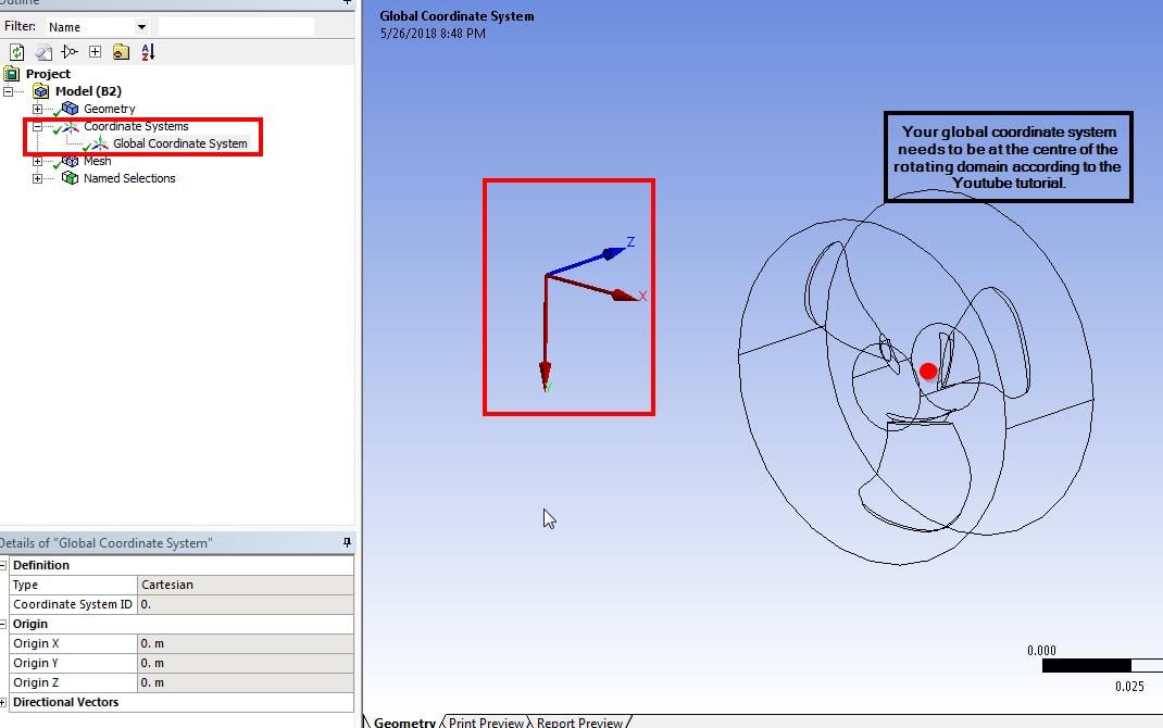

      Hello, i saw this tutorial: https://www.youtube.com/watch?v=tBOFspg0sdU in youtube, but i can't do the final part, the solution, because those errors appears: "The ANSYS CFX solver exited with return code 1. No results file has been created." and "Update failed for the Solution component in CFX. The solver failed with non-zero exit code of 2". Can someone help me, please?

    • raul.raghav
      Denis, I looked into your setup. Your global coordinate system is not located at the center of the rotating domain and since you were defining the rotation about the Global Z axis, you were getting the error. If you're just learning from this tutorial and don't want to go back to the geometry or mesh and fix the global coordinate system, you can follow the steps mentioned below that will help you fix the error and run the simulation. All you'll be doing is going to the CFX-Pre setup and defining a new coordinate system "Coord 1" which would be centered at the rotating domain. You'll then define the rotation w.r.t this new coordinate system. And your rotation speed (1500 rad/s) is really high compared to the value used in the tutorial (300 rev/min). So your timescale might be much smaller than that shown in the tutorial.
