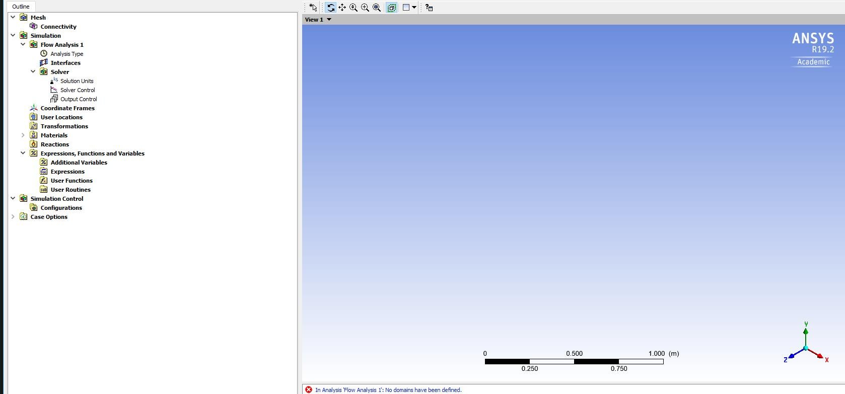

      For several days, I have been trying to simulate the air flow through this hood expecting to accuaretely determine the pressure drop. At first I try simulating an imported geometry from Solidworks, then I substracted this geometry into a cubic domain and finally I try modeling the hood in Design Modeler; all with the same result (or error). Once the geometry complement is checked, I logically move on to the meshing, in which the automatic meshing throws an acceptable skewness. Everytime I try to open the "Setup", this error appears:

      I pretend to apply a border mass flow condition to one end of the duct, then an opening condition to the hoods, and last but not least, the simmetry condition at the longitudinal cut. Nevertheless, in the "Setup" after the error message pops-up I can only visualize this:
      Setup

    • fad6995
      Rwoolhou, thank you for reviewing the case and reply to it.
      Indeed, it is not quick and I happened to have rushed a little bit into this simulation. I will take a deeper look in the mesh.
      On the other hand, the problem was solved by changing the folder where the archive was beed saved, maybe it had something to do with the original folder was auto-uploadable to the cloud.
      Kind regards.
