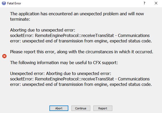

      I tried to create a chart and got the following error.
      I will point out that I have managed to produce a chart, in the same way, two weeks ago.
      I will be happy to solve the mistake.

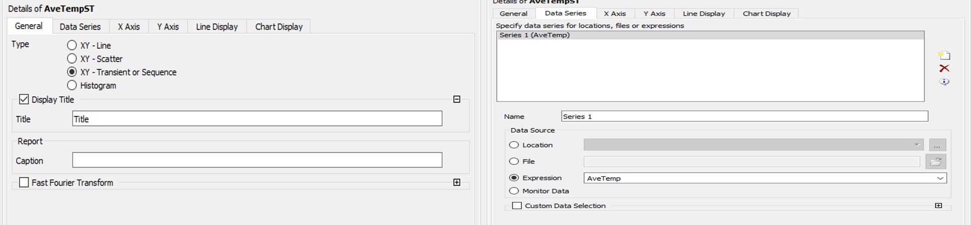

      Are you reading a State file? Is it the same result file as two-weeks ago? Can you post the chart definition? Any other information is welcome here.

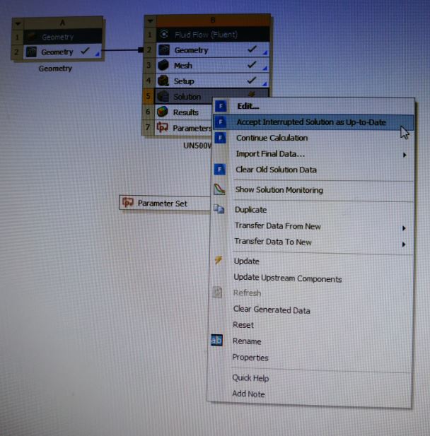

      I've taken the following steps:
      1. Update the results (Figure 1)
      2. I entered the results.
      3. I created a chart (Figure 2).
    • tubiy

      Can you just use transient sequence for a variable at a point?
    • tubiy
      That's really what I tried to check, and also a transient sequence at a point it gave me the same error.

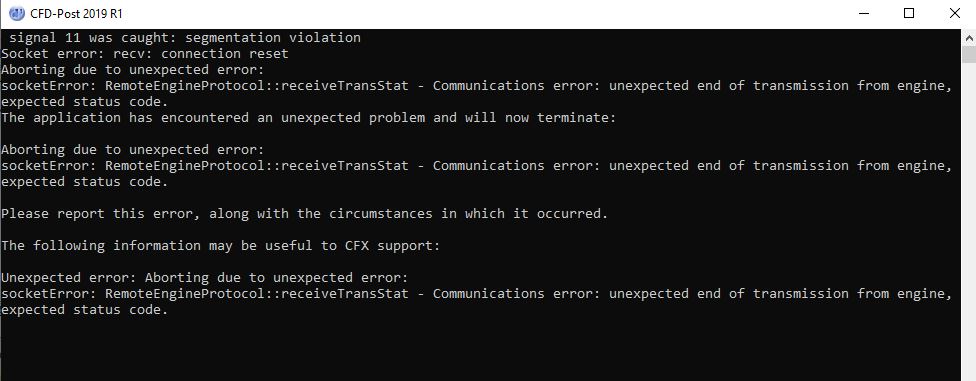

      Have you tested with CFD Post outside the workbench. Here pay attention to what is printed in the command prompt of Post.
    • tubiy
      I tried, and I get a message almost identical.
      Best regards,
      Tubiy
