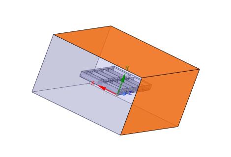

      I am trying to do a simulation on a battery pack As I finished all my physical setup in fluent and try to initialize it, it gives me "Error floating point exception Error Object: #f" error. As I checked in some other threads it might be due to the mesh, i made it refine and I had like 13 million faces which it said couldn't be solved. So, I am not sure this is happening for rough mesh or due to some other reason?
      Anyone can suggest me to sort this problem? Thanks

      I think I got a little idea that I might be able to solve it. Can you please let me know how can I hide those faces so I can select parts to name which can be used later on in meshing and fluent solver? When I select and try to hide them it hide the whole thing? I was watching a video in ANSYS version 19 in which option of faces comes and you can simply hide them from there?

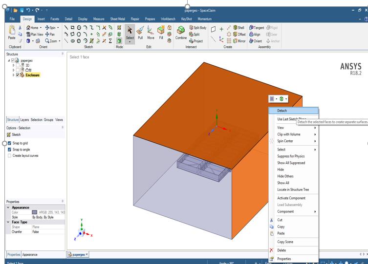

    • UmairAfzal
      This is what I am getting. I am using ANSYS version 18.2. I even checked in help but no luck
    • DrAmine
      You need to update.
    • UmairAfzal
      That's a great suggestion but unfortunately with the student version I can only have 512K cells/nodes so I am not sure once I uninstall this the new version is going to help me to achieve what I am aiming for. Is there no other way to hide a face in ANSYS version 18.2?
    • Keyur Kanade
      move the mouse
      press ctrl + scroll mouse.
      this will highlight inner face. then select face with left mouse button
      use ctrl to select more than one face.
      you can also make use of box selection.
