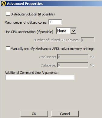

      This is easy to fix. Start ANSYS Workbench and open the project you built.  Double click on Model to start Mechanical. In Mechanical, Tools, Solve Process Settings...
      You will see My Computer highlighted. Click the Advanced Button to show this dialog where you will uncheck Distribute and type 1 for Max number of utilized cores.
      You only have to do this once (unless you reinstall).

      The error message clearly states that the max number of utilized cores is currently set to 5, whereas you have only two physical processors. Therefore you need to set the number of processors to 2(or 1).nThis thread might be of help!n
