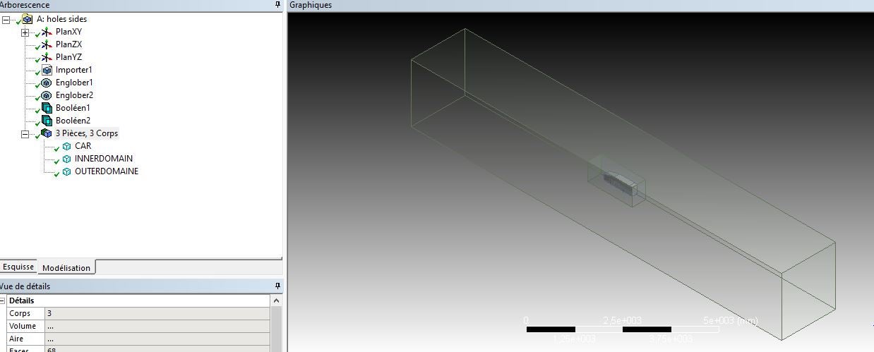

SubscriberHello i am a student, I want to simulate a flow over a ahmed body, while i am intializing i have faced a problem, and the iterations did not start...please any help of my problem

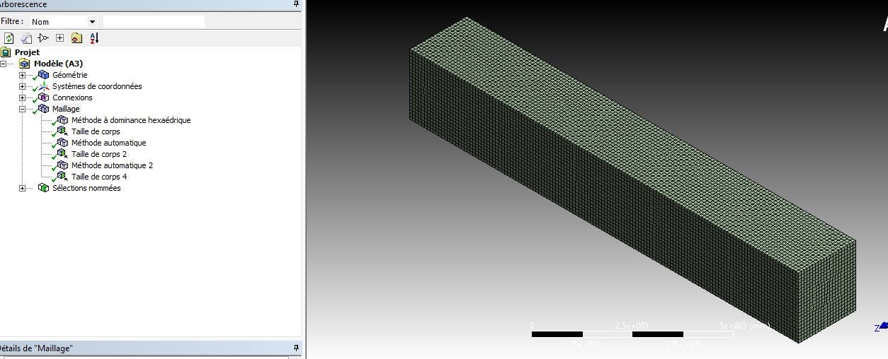

I'm tryin to simulate the beheviour of an external flow around a winsdor (Ahmed Body model).
My objectif is to visualise how the parameters that i want to calculate change around the vehicle,So
I have createdan outer fluid domain and inner fluid domain near to the geometry for minimise the mesh elements.
the pictures as follows shows the methods that i have used for meshing and fluid domain.
cordialment!
August 31, 2021 at 1:43 pmSeptember 2, 2021 at 2:19 pmKarthik Remella
AdministratorCould you please check the quality of your mesh, especially at the Ahmed Body? You should be able to do this in Ansys Meshing.
Click on the Mesh -> Properties -> Statistics.
Check for Orthogonal Quality & Skewness.
Karthik
