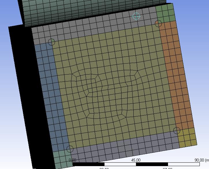

      I am analyzing a reinforced concrete frame. The connection between the elements is made through a system formed by a screw and steel plate. The connection region is filled with grout, but for initial analysis, I suppress the grout. Taking the advantage of symmetry, I modeled just half of structure.
      For the numerical simulation, the following conditions were adopted:
      -Element Solid65 for concrete and Link180 for reinforcement.
      -The contact between the elements was defined as bonded, with Auto-Asymmetric behavior and Pure Penalty formulation (the only exception is for the region between the load suport and beam, in which the formulation is MPC).The contact tool did not indicate gap or penetration.
      - For the mesh, Multizone method was employed and contact sizing option were used to refine the mesh in the contact regions.
      - The load was applied  in form of displacements that gradually increase with each load step (20 mm divided in 10 steps). Also, the bolt was pre-tensioned.

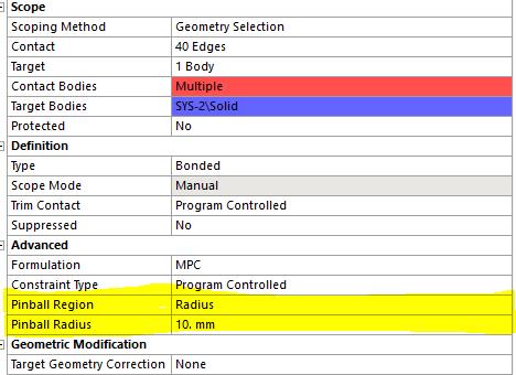

      Hi Daiasena,
      Could you please try changing the pinball region to "radius" and manually define a contact search radius? It looks to me like the node is not within the vicinity of elements.
      Did you use "contact-bonded-MPC" to bond the reinforcement rebars to concrete as well? Or did you manually inserted a command "CEINTF" to tie them?

      I did you suggestion.
      Before, the pinball was 2 mm because i  realized that just with values smaller than 2 mm i do not have initial gap and penetration.
      I changed to 10 mm, but now i have a inital gap and the warning message is not gone.

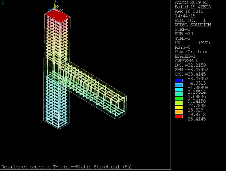

      Hi Daiasena,
      I have not looked into CEINTF command much, but I have tested out REINF command, that works well in generating reinforcements for concrete. That may be a workaround for your situation.
      To use REINF, you need these steps:
      1. Create base elements (In your case you have SOLID65)
      2. Create beam elements (in your case it's LINK180)
      3. Use EMODIF to change the beam elements' ename to MESH200
      4. Select both MESH200 elements and base elements
      5. Use EREINF. It will generate reinforce elements REINF264 that connects your solid element at your previously defined link element location.
      I attached below my command file, in which I use SOLID185 and BEAM188, but I don't think that matters. These commands are inserted in the analysis module.
      ! Procedure to create reinfocement in concrete:
      !   1. create base elements
      !   2. create Mesh200 elements. Define proper reinf section for mesh200
      !   3. select both base and mesh200 elements
      !   4. use ereinf to generate reinforce elements
      finish
      /prep7
      ! Define material properties
      matid = 1001
      mp,ex, matid, 1000
      mp,prxy,matid, .3
      mp,dens,matid, .0001
      ! Define a new section id
      sectypeid = 1002
      secarea   = 10          !mm^2
      ! Define a new element type id
      etype_id  = 1003
      ! Define a new section and new element type
      sectype, sectypeid, reinf, discrete  ! Define a discrete reinf section
      secdata, matid, secarea, mesh        ! Define the section properties
      ! Define a new element type Mesh200
      et, etype_id, 200, 2
      ! Change the Beam188 to Mesh200
      esel,s,ename,,188
      emodify, all, type, etype_id        ! Define a
      emodify, all, secnum, sectypeid
      ! Select both the Mesh200 and the base Solid185 element
      esel,all
      ! Generate reinf264 elements.
      EREINF
      ! Delete the mesh200 elements
      esel,s,ename,,mesh200
      edele,all
      FINISH

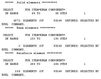

      ! To verify, we can print the the element types
      allsel,all
      /com,============================================
      etlist,all
      /com, =====  Solid elements =========
      esel,s, ename,, 185
      /com, =====  Beam elements =========
      esel,s, ename,,188
      /com, =====  Reinforce element =========
      esel,s, ename,, 264
      allsel,all
      ! Go to solution module
      /SOLU
      Note that REINF264 elements need to be post-processed using some commands as well. Below are my commands to visualize them in PNG images in Mechanical. I added this command object in the solution module.
      ! $$$$$$$$$$$$$$$$$$$$$$$$$$$$$$$$$$$$$$$$$$$$$$$$$$$$$$$$$$$$$$$$$$$$$$$$$$$$$$$$$$$$$$$$4
      ! Graphics power needs to be turned on to view the rebars
      /graphics,power
      ! Enter /post1 module
      /post1
      ! Show result as a png image
      /SHOW,png
      ! Set the frame as the last substep of the 1st step
      set,1,last
      ! Select the SOLID185 elements
      esel,s,ename,185
      /trlcy,elem,0.5     ! Change them to transparent level 0.5 (0 is solid, 1 is completely transparent)
      esel,all
      ! Set view angle
      /view,1,1,1,1
      /angle,1,-0.75
      ! Show the whole section of the reinforcement
      /eshape,1
      ! Plot displacement
      plnsol,u,x

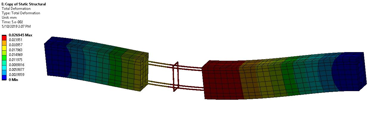

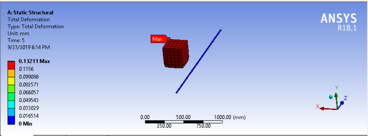

      And my output looks like this:
      For more information, you can refer to element type REINF264 and the ANSYS Structural Analysis Guide Chapter 14 "Reinforcing"
       https://ansyshelp.ansys.com/account/secured?returnurl=/Views/Secured/corp/v193/ans_str/Hlp_G_STRRFDEF.html
      Hope this helps.

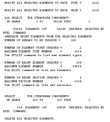

    • daiasena
      Hi, wenzhang!
      Thank you very much for your suggestion.
      Some comments:
      1) I tried using the REINF command to create the rebars, but apparently the problem continues, as you can see in the picture:
      I only changed the first line (matid = 2,relating to Solid 65) and the section area from your command, generating the following result:
      2) The solver file shows this warning message:
      *** WARNING ***
       Material table TB,CONC for material 2 cannot be used with element type  REINF264.  The table will be ignored.
      3)  I also followed the recommendation from @peteroznewman. I change the beam body into a multibody part to make the element size on the beam and rebar equal. I tried to put the rebar nodes at beams nodes.
      /forum/forums/topic/transient-structural-analysis-steel-concrete-girder/?order=all#comment-9627f783-e8c2-4193-a208-a9bb00d36488
      Any suggestion?
      I do not know if you have permission, but could you take a look at my archive file? Maybe i am doing something very wrong!
      Thanks!

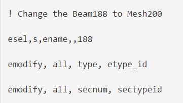

    • Wenlong

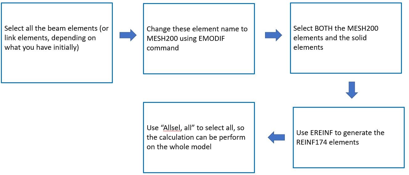

      The reason is probably that my selection was based on element names so you need to modify one more line. I have BEAM188 elements in my model while you have LINK180 initially.
      In the above lines, you can change 188 to 180, then it will select your link 180 elements and change the elements to MESH200 elements.
      Below is a flow chart of the whole procedure:
      Please try this and see if it helps.
      Best Regards,
      Wenlong

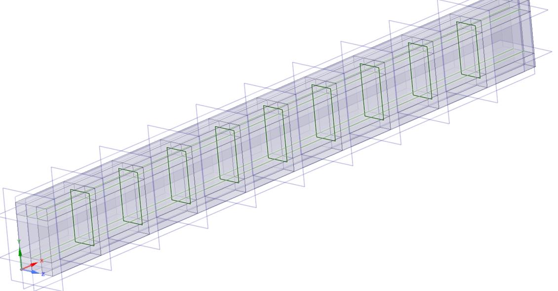

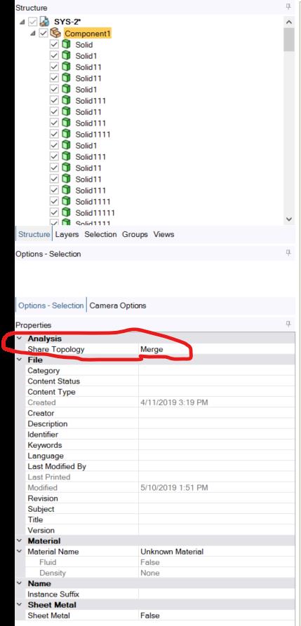

    • Wenlong
      Hi daiasena,
      Another way I recently found a way to model the reinforced concrete WITHOUT using a command object or contact. Here are the steps:
      1. When creating the geometry (in SpaceClaim), make sure the geometry is sliced in a way that the inner edges are aligned with the rebars (Figure 1)
      Figure 1.
      2. Move the concrete and rebars into the same component, and change the "Share Topology" to "Merge" (Figure 2)
      Figure 2
      3. Now, these reinforcement rebars will share the same nodes are the concrete and they can deform together (Figure 3). (Some solid elements are hidden to show the deformed shape of rebars)
      Figure 3.
      Hope this helps.
      Best Regards,
      Wenlong

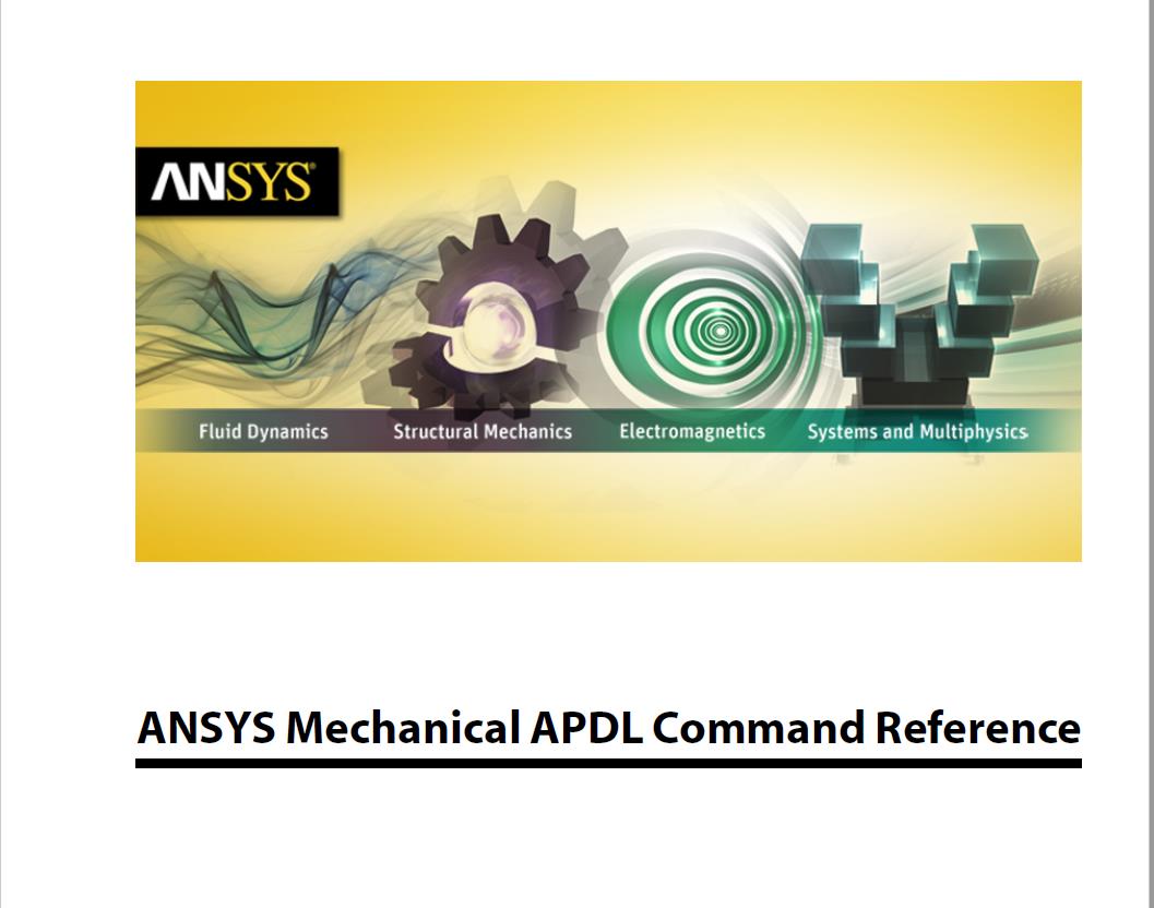

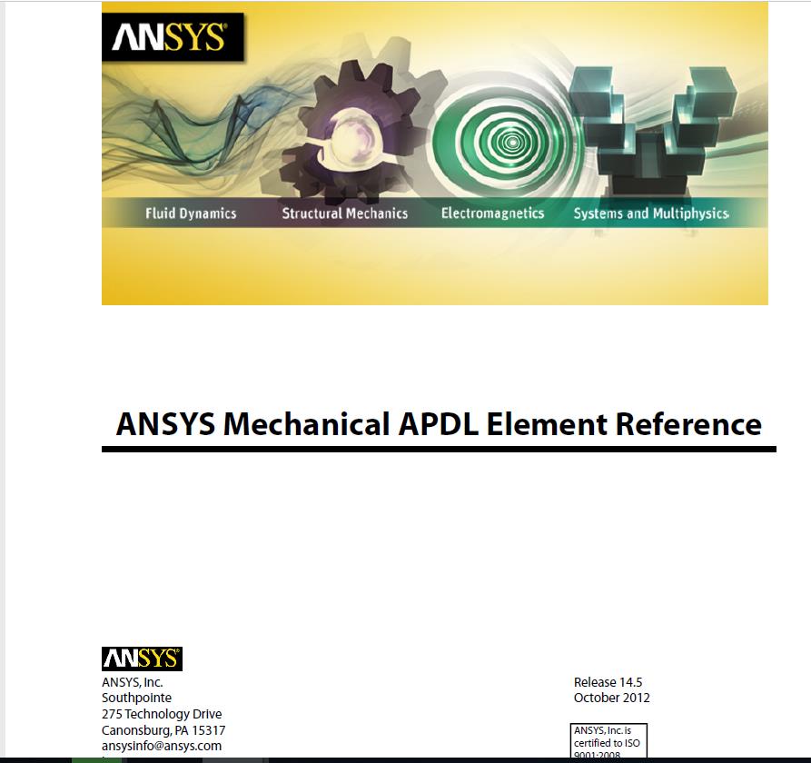

    • Wenlong
      This link has all the documentation of commands and will be very helpful: https://ansyshelp.ansys.com/account/secured?returnurl=/Views/Secured/corp/v194/ans_cmd/Hlp_C_CmdTOC.html
      You can also refer to this link, it has many examples about APDL commands:https://ansyshelp.ansys.com/account/secured?returnurl=/Views/Secured/corp/v193/ans_tec/tecintro.html
      Bests,
      Wenlong

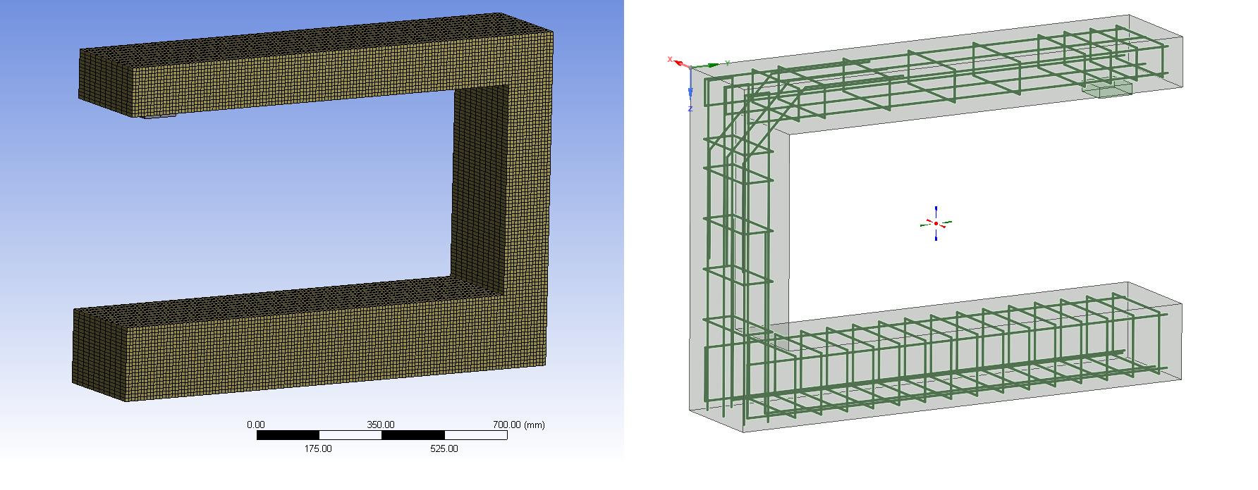

      Hello all,
      I´d like to please you for help.
      In my thesis, I have concrete U shape component reinforcered by steel, where we study behaviour of the corner while opening.
      Concrete is defined by library as nonlinear with softening.
      concrete - library
      + in command:

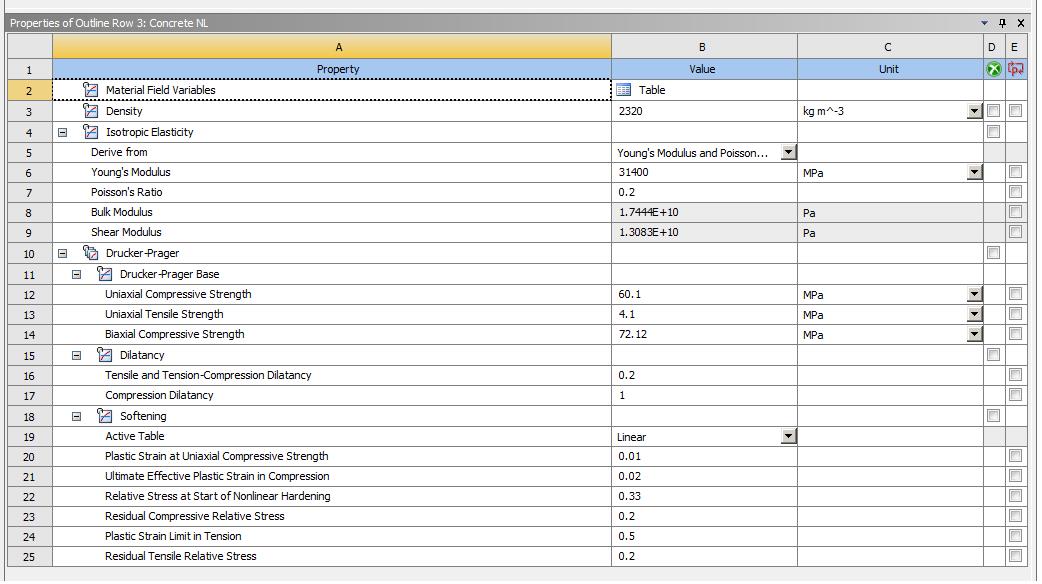

      So next I tried to use commands written by @Wenlongand and change few lines.
      finish
      /prep7
      matid = 10001
      mp,ex, matid,31400
      mp,prxy,matid,0.2
      mp,dens,matid,0.24e-5

      sectypeid = 10002
      secarea   = 20          !mm^2
      etype_id  = 10003
      ! Change the Link180 to Mesh200
      esel,s,ename,,180
      ! Select both the Mesh200 and the base Solid65 element
      esel,all
      EREINF
      edele,all
      FINISH
      allsel,all
      etlist,all
      esel,s, ename,, 65
      /com, =====  Link elements =========
      esel,s, ename,,180
      esel,s, ename,, 264
      allsel,all
      /SOLU
      This contact doesn´t work in my model.

    • israelcrawford
      What does this mean ?????
      Hi daiasena,
      Figure 1.
      Figure 2
      Figure 3.
      Hope this helps.
      Best Regards,
      Wenlong
    • Wenlong
      It is to model the solid and beams (rebars) in a way that they have merged geometries, so when you mesh them, they will have common nodes, and no command object is needed.
      Please let me know which part you don't understand. Thanks.
      Wenlong
    • israelcrawford
      Hello Wenlong
      The inner edges are sliced at the rebar?
      Israel
    • Wenlong
      Hi Israel,
      Yes, at both the rebars and the stir-ups.
      Wenlong
