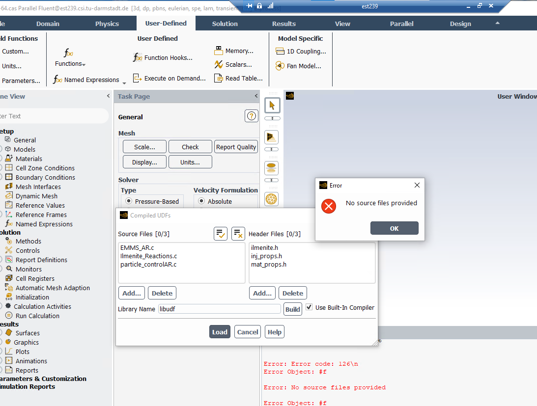

      I am using Fluent 2020 R1 on a Windows 10 Education to run a 3D transient circulating fluidized bed simulation. I created a UDF to predict the flow behavior for each cell in the simulation.
      Until last week, the UDF source code worked without any problems, but today it has failed. The issue I am having is when I try loading the UDF after building it, it gives me Error code: 126. Could you please help me resolve this issue?
      Thank you in advance.

      Is it same machine? Copy the case file into a new folder. Same with the *.c file. Start Ansys Fluent, compile but do not load, then read the case file. I am assuming you are using the built-in compiler.

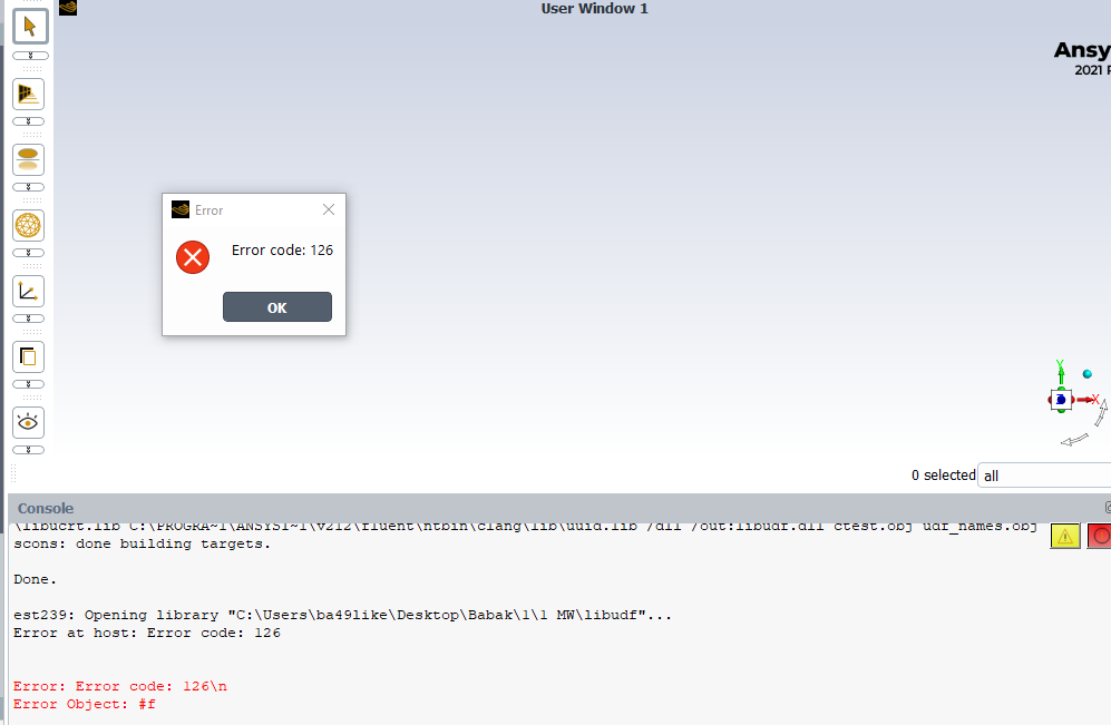

      The error appeared when I loaded although I can see some warnings during compiling. Before comparing the new UDF I usually remove it.

      You wrote that before you were able to compile and to load the compiled libudf. Then something happened on your computer and you cannot compile anymore. Is this correct? Can you check what happened to your computer? In an empty directly where you do just have the simple UDF file and if you compile with Ansys Fluent Built-In Compiler -> Any log files written?
    • babak.aghel
      Yes at the first I could compile but not now. Nothing new has happened on my computer, such as installing new software. I tried your suggestion but there is no log file written.
    • Amine Ben Hadj Ali
      It is bit hard at this stage to figure out what is going wrong on your machine without having to look into your machine and check what is going on. There should be something which changed from one day to another. Perhaps you paste the Fluent Launcher and where the UDF bat is located and perhaps a process explorer is required to check which processes are invoked and which are blocked.
