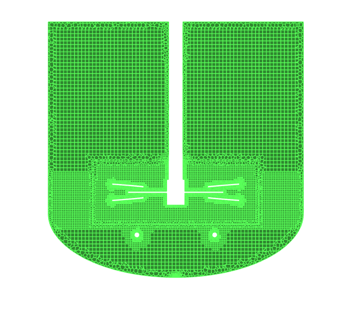

Subscriberwhen I simulated a stirred tank with MRF, I found significant difference on the border of station region and rotate region in attached picture. details about model and simulation were as follow:
TFM-RANS (mixture realizable k-e).
phase coupled simple scheme was adopted for the pressure-velocity coupling.
Quick and second-order upwind scheme for spatial discretization of volume fraction and momentum.
the simulated domain was meshed by poly-hex-core with fluent meshing shown in the attached picture. waiting for your reply, thank you sincerely.

Forum ModeratorThat does look odd. Given the likely flow field I'd tend to favour a pure poly mesh, but poly-hexcore should also be OK. Double check for stray wall between the rotating and stationary zones. How good is the convergence, and how long has the model been running? How does the air get out of the domain?Â

Subscriberthanks for your reply, is there another possible reason for this phenomenon?
August 18, 2022 at 3:05 pm
ztjia
Subscriberthanks for your reply,Bob. all the residual were below 10e-3, steady simulation was used about 100000 iterations, the air was defined as a velocity inlet, at this condition, the air velocity was 22 m/s, the stirred top was degassing condition. I have checked the mesh, the rotate region and station region have been shared topology in SCDM, the mesh were commom nodes.

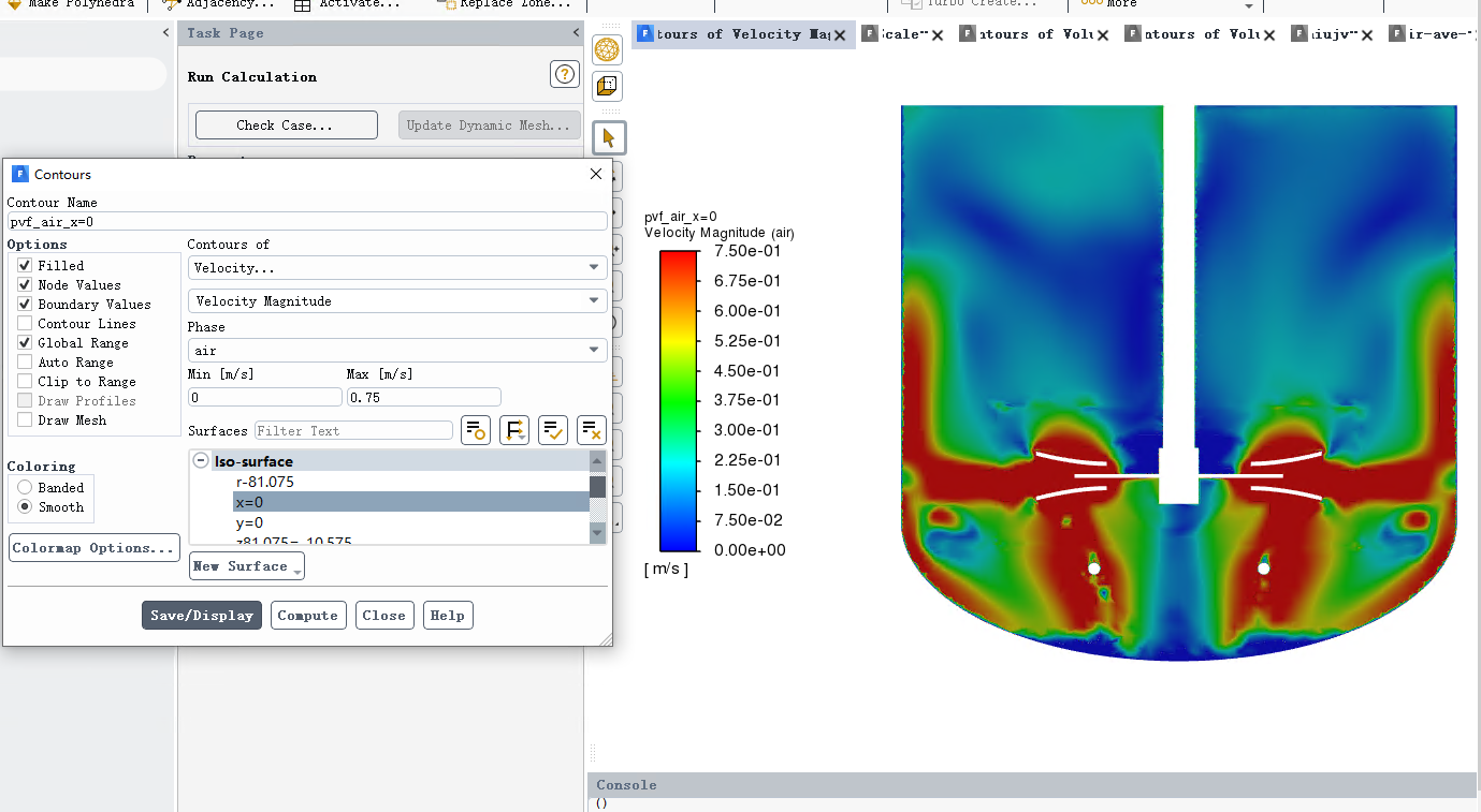

Rob
Forum ModeratorIf you look in 3d is there an explanation? Please post the velocity plot too.Â
August 20, 2022 at 2:50 am
August 22, 2022 at 3:58 pm
Rob
Forum ModeratorThat looks fairly sensible, and the water?Â
