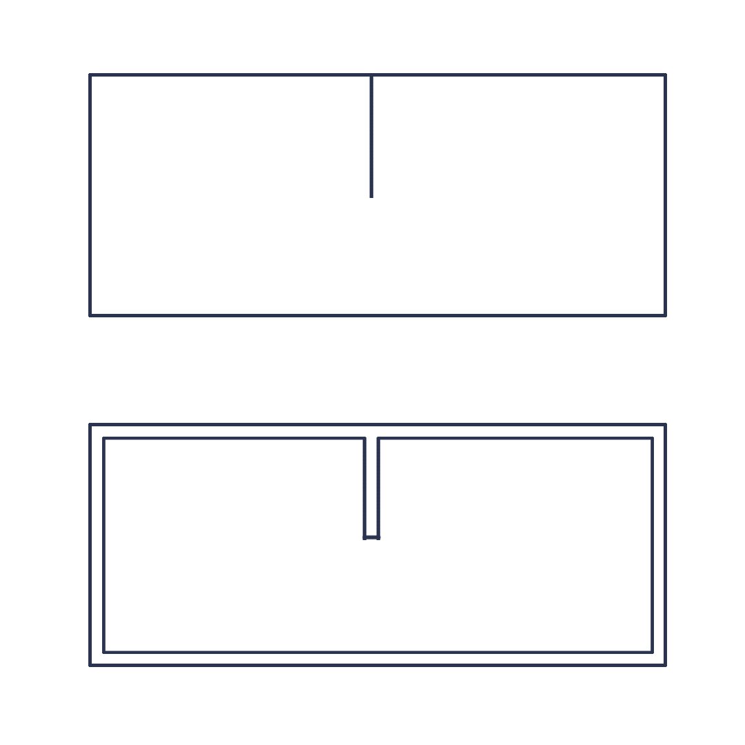

      I tried using a much simpler geometry (a box with a window) and everything runs smoothly until the result step, it happens when I use this geometry:
      I tried cleaning the geometry, recreating that geometry from scratch, but the error stays the same. Does it relate to the student version that I am using or there is something wrong with the geometry?

      Have you meshed the volume or the surfaces?  From the above it looks like you may only have a surface mesh. The transfer from Meshing will work as we use surface meshes in other ways but Fluent won't recognise it: in standalone mode Fluent will give a more diagnostic error as it fails.
    • ricardolion
      Yes, that is what I have done after I realised I should model the volume instead of 1-layer surface.
      This is what I did before and after
      This is the geometry after
      But then I still received the same error after that in Fluent. I am not sure if I am doing the volume modeling correctly. Could you please advise if my understanding of the geometry concept is correct or not?
