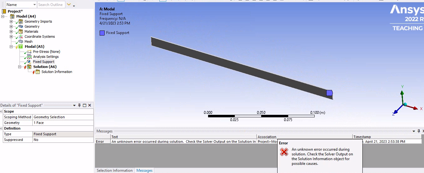

Error: An unknown error occurred during solution
    • Xabier Tamayo
      Hi everyone, Im trying a really simple modal simulation, but it always gives me an error message. I have tried to find out what the error is using the output solver, but I still don't know what it is. I attach some screenshots and the solver output.
      And the output solver says the next:

    • ErKo
      Hi
      So it is solving as you can see (frequencies are there and no errors), so there is something when opening results. Likely the result file does not exist or is not written (.rst file).
      Can you clear solution and data and untick the distributed solve box when solving, and solve again.
      If that does not work, try not to use any cloud related services/folders, just solve it locally on your lapotop/desktop.
      Thank you
      Erik
    • Xabier Tamayo
      I opened it again from another remote and this time it worked. Thank you very much.
