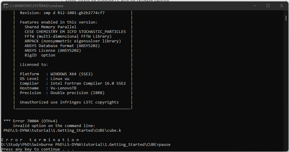

I am learning to use LS-Dyna as preparation for my research project and have started first with the tutorials provided with the installation file.
I've followed all the steps stated inside the folder 1.Getting_Started, and no error was found at the end prior to saving my .k file.
However, once I proceeded with LS-Run, I encountered Termination error 70004 as attached image. This is really frustrating as there is already a discrepancy between the tutorial file and the actual LS-Run interface and settings that are available for me.
November 15, 2021 at 1:55 pmRam Gopisetti
Ansys EmployeeNo spaces are allowed in the input file force path remove the space between your university name and PhD.
Cheers Ram
