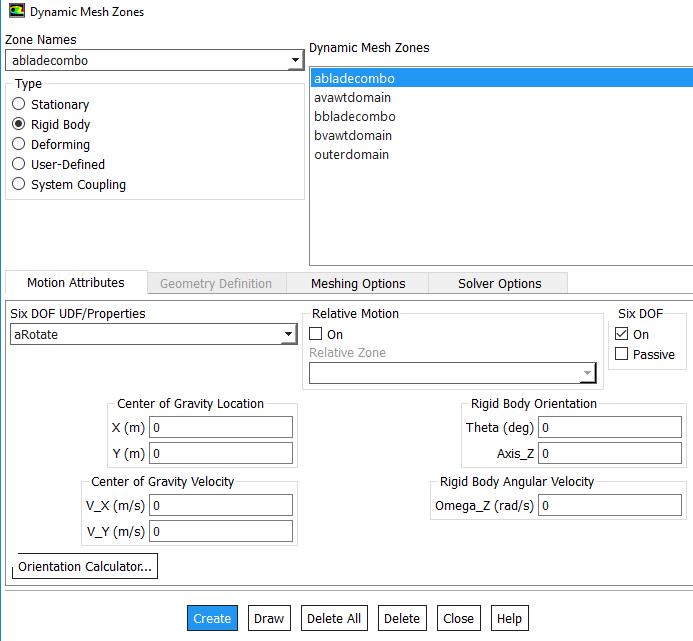

SubscriberAll right, so 1, 3, 4, and 5 have been confirmed. #2, I have tried, but couldn't - and honestly have never gotten the preview mesh motion to work - even though the turbines would rotate calculating - so I never really leaned on that at all. I attached the dynamic mesh zones pics. I have been trying to run calculations again, and am getting the original error, and can't get it to go away this time.Â

September 21, 2018 at 11:11 pm
klu
Ansys EmployeeTo create non-conformal interfaces, please go back to geometry editor and unshare topology between these three zones (I guess avawtdomain, bvawtdomain and outerdomain). Then re-generate the mesh and import it to Fluent again. You will see Mesh Interfaces in the Fluent tree panel. As mentioned in previous replies, next please activate Mesh Motion for the rotating zones avawtdomain and bvawtdomain and input rotation origins, axis and speed (double click the cell zone so you can open the panel). Now turn off the Dynamic Mesh and preview mesh motion should work.Â
After previewing the mesh motions, deactivate Mesh Motion for both rotating zones and turn on Dynamic Mesh again. Remove the outerdomain from DM zones panel. Then I think DM should work properly.Â
However I would suggest get a steady solution before turning on Dynamic Mesh. First it can check whether there is something else wrong in the model settings (for example zero velocity in the two rotating zones are suspicious). Second it can provide good initial conditions for DM simulations. Please try the above out and let us know.Â
