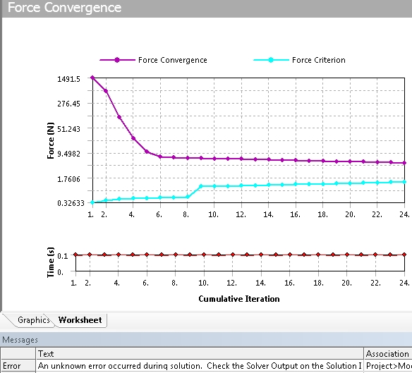

    • SJ123
      I also have Ansys 19.2. I have tried running this model immediately after restarting the computer using six core.
      After running for 2 hours, it suddenly stops giving an unknown error.

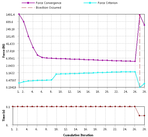

      I can see what your computer did, it got to iteration 24 and the solver stopped for an unknown reason.
      I opened the last model you provided. I forced it to run outofcore on 6 cores. It runs fine without stopping.
      There is nothing wrong with the model. There is something wrong with your computer.
      You can try uninstalling ANSYS and completely remove all traces of ANSYS before reinstalling.
