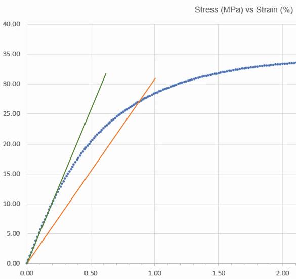

SubscriberI attached the data below for better discussion. I tried to use MISO and take the data up to max point as the following points after max stress show lower true stress. It is mainly due to the strain is very small. I have other case where the break point is 50% strain and true stress is much higher.Â
However, this way does not work. It does not converge... so I change to use BISO and use the tangent modulus at YS given instead of at the elastic limit from the chart. Any thoughts?

peteroznewman
SubscriberRead this discussion to help understand how to use Multilinear Hardening Plasticity.
- Discard the Yield Strain of 2.1% that the manufacturer provided. It is meaningless here.
- I drew an orange line for E=3,100 MPa. Look at how it is wrong. That is not the initial slope.
- I drew a green line through the linear portion of the curve to estimate the initial slope.
- It looks like the linear portion ends at 10 MPa, so that is the Yield Strength.
- From the plot, the strain at 10 MPa is about 0.002 so the Initial Modulus is 10,000/.002 = 5,000 MPa not 3,100 MPa.
- Make the Young's Modulus 5000 MPa.
The first row in the multilinear kinematic hardening plasticity column will look like this:

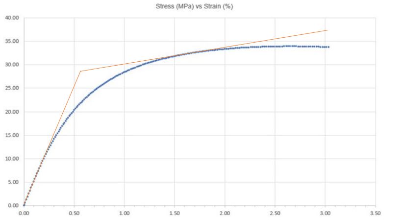

Autonewbie
SubscriberHi Peter,
I used BISO instead of MISO for better convergence issue... I draw two lines below... at this case, yield strength is approximately 28MPa...
I wonder if I assess for plastic deformation, I should use the yield strain following the bilinear chart below, which is 0.6%? And plastic strain calculated in ANSYS would be where the total strain exceeds 0.6%?Â
Lastly, when the part show largely plastic strain, it does not mean that the whole beam will not return to its original position, is that right?Â

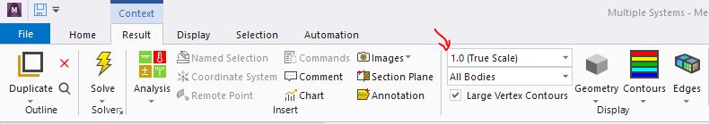

SubscriberBased on the bilinear above and assume 1% yield strain, I run a simulation and hope to see how the plastic deformation looks like...
The beam tip is being pushed by large displacement and released at last step... I notice some plastic deformation but not as severe as I expect although the area exceeds yield (>1%) seems to be very large area...
I was expecting if the root shows largely plastic deformation, the beam will not be returning back to original position...any idea? Thanks

SubscriberHow are you "releasing" the tip after using a Displacement to move it to the left?
If you had a Displacement of 10 mm in Step 1, and the Displacement in Step 2 is 0 mm, that is not releasing the tip, that is forcing the tip back to 0.
In order to release the tip after using a Displacement to move it 10 mm to the left in Step 1, you have to Deactivate the Displacement boundary condition in Step 2.
April 8, 2020 at 1:42 am
Autonewbie
SubscriberHi Peter,
I think I know the problem. I set it to 0 at step 2. It works now!
