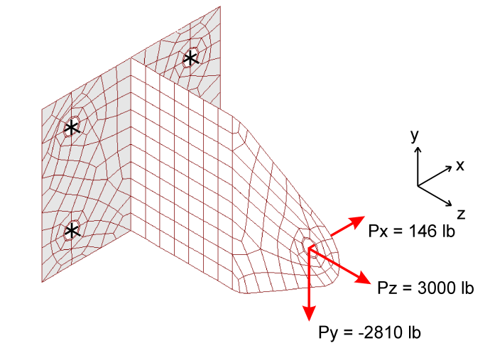

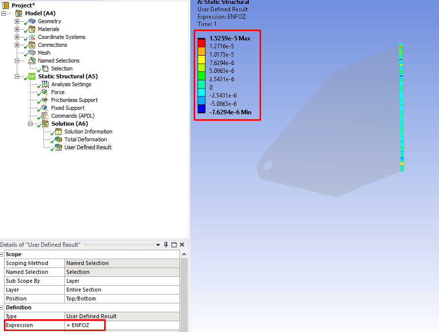

I'm trying to extract averaged internal nodal forces along an entity. They show values that are wrong. What could be the error? I have turned on nodal forces in the analysis settings.

Ansys EmployeeI hope you have checked the units. What is the direction and value of force on the bracket? Also, what does the command snippet do? Could you also try FZ (this works only on constraint nodes) instead of ENFOZ and see if anything changes?

The units are fine, the command snippet is to activate ENFO, since it is missing in the solver worksheet. The value of forces are as described below. I'm running a set of benchmarks with Ansys after moving from a Nastran environment. I dont think Fz helps. However, I was able to work with the stress tensor and take the longer route. I'm not sure why ENFO does not work in my case.

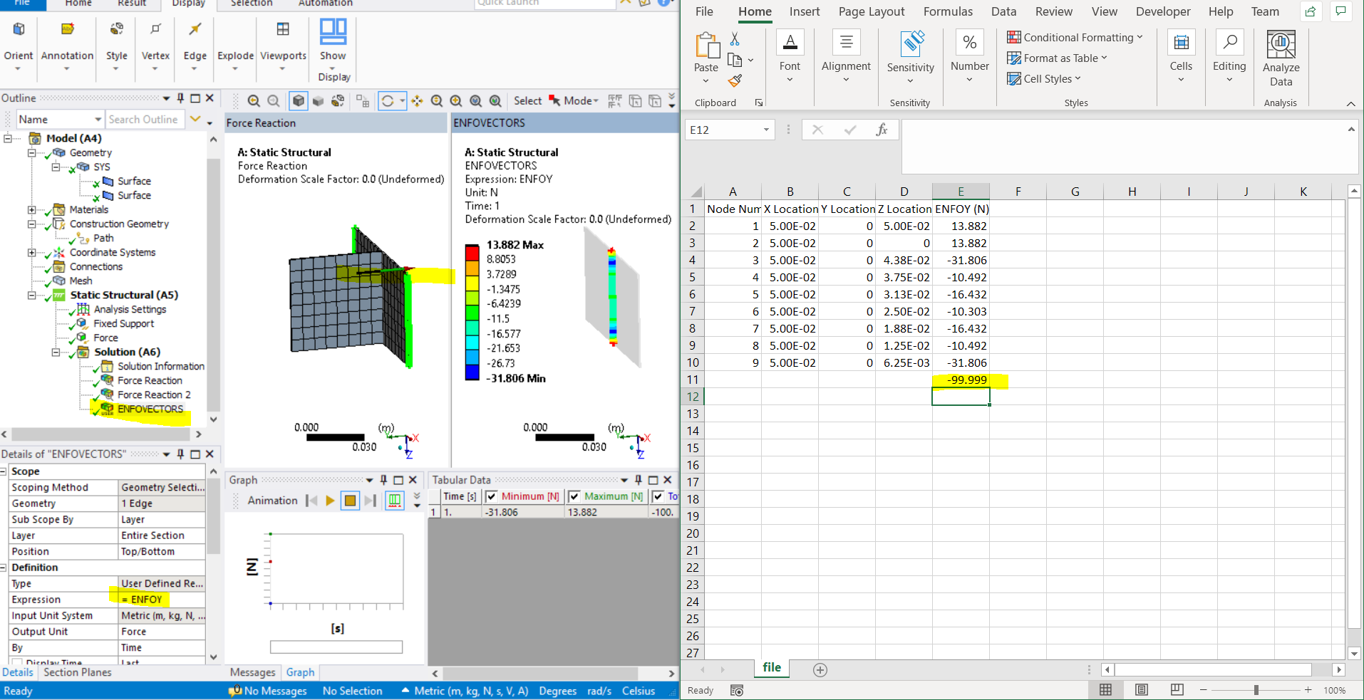

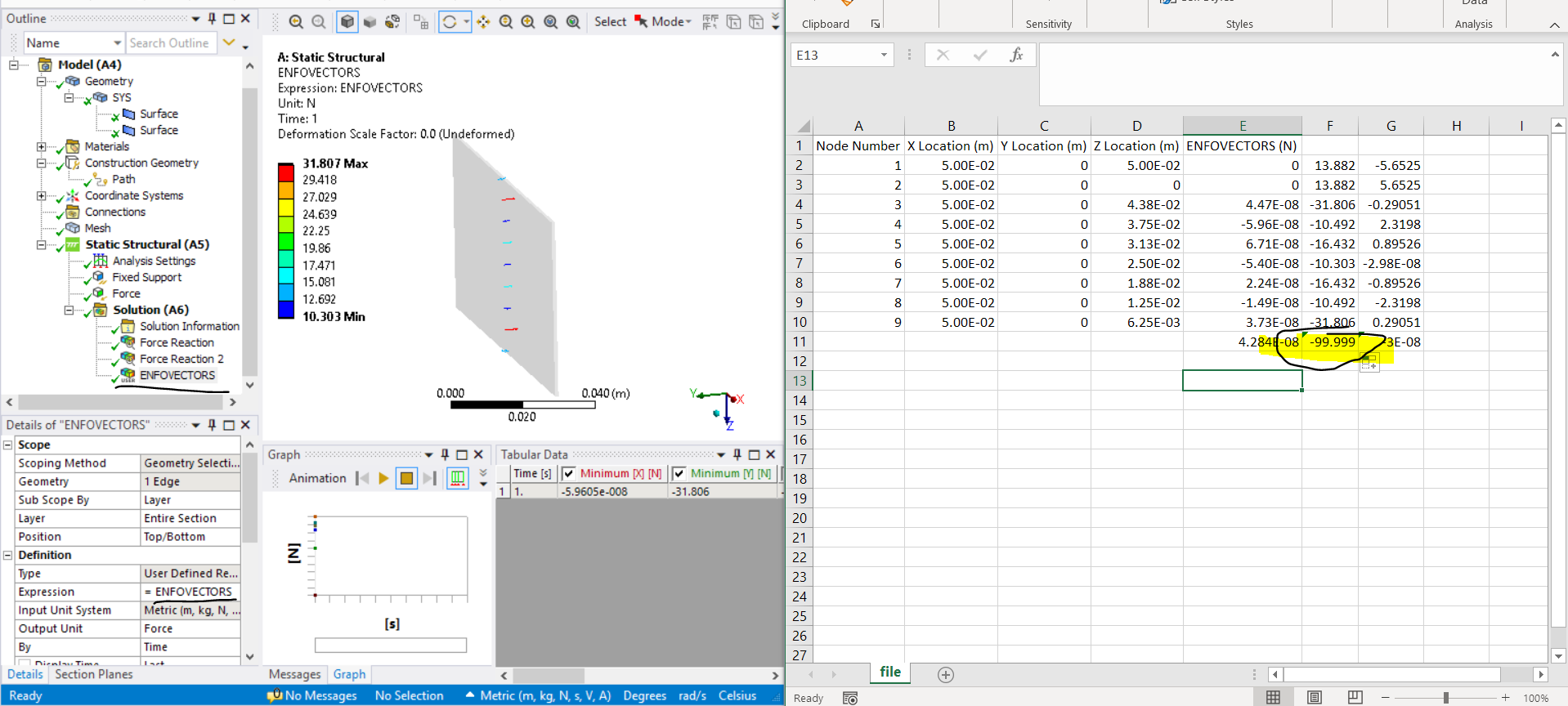

I have made a simple example to show how one can do this perhaps - I am used to working with the element-nodal force vectors when designing saying connections so that is the udr I have used as shown below. We can then export the results to excel and sum the element nodal force to obtain the total reaction which -100 N as shown, and is as expected equal and opposite to the applied load which is 100 N in this example. I think as shown it can be done also with ENFOY.
Should be said here, that mesh is fully compatible at the intersection of the two plates so no contacts - if we have contacts then we can get the reaction at the contact with a contact/force reaction probe (under the force reaction probe we can choose to look at the contact region).
Hope this helps

Ansys EmployeeNo worries - it is the internal forces between elements , so forces within the mesh (so not fixed boundary nodes) which I mean with element nodal force (ENFO)- it is a general term. not sure if it is described. ELement Nodal force is not interpolated as far as I know, they are "raw" and they are the internal forces that provide equilibrium.
Finally in the above example we need to sum (use SUM() function in excel) manually in order to get the total force (ansys provides the force at each node of the element so we need to sum them all)

Check this out - 1. Solution Output, 2. Interpolation.
The documentation states that "Interpolation primarily applies to degree of freedom results such as temperatures, displacements, and node-based element results like thermal flux, stress, and strain. Therefore, it is recommended that you not use interpolation for results such as node-based element reactions (EHEAT/ENFO). The application allows for these calculations, but they are not good candidates for interpolation. In addition, you should not sum interpolated results of these types; such as to calculate total heat or total force"
