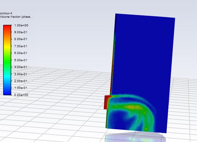

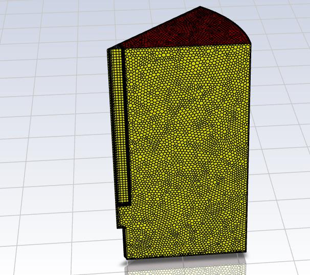

      Hi, i am trying to do the End quenching of steel rod which will be at 800 degrees initially and then by the application of the water jet at the end the steel rod will be gradually cooled by time, i have attemped with following parameters, i am simulation in 2 phase where air is surroded followed by thr jet impinging with phase 2 which is water, i have tuned the parameters multiple times but i am not gettign the soultioni have tried by usign the transient thermal module by the convection model calulated usign the published law whih had worked but in cfd it is not working can anyon help. i did patch the solid with 800 but of no use with the mesh interface to be an coupled

      Is it a continuous jet or kind of spray hitting the to cooled block?
    • ramgopisetti
      its an continous jet
