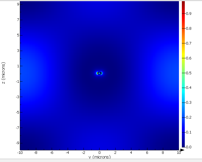

      I am simulating an optical fiber edge coupled to an silicon inverse taper in EME. I want to get the increase in the coupling loss as a function of the distance of the fiber to the taper. I think that the mode divergence must be considered. How can I set the cell between the fiber and the taper to consider the increase in the mode size?

      Do you mean you want to simulate the result with varying the distance between the input fiber and the edge coupler, where the gap is in air or other material without light confinement? In this case the gap part will need many modes to build up the fields accurately. you may also consider using import sourece for EME, with FDTD simulation of a fiber and air, and use farfieldexact to calculate the fields at any distance. The calcualted EH fields then can be imported into EME. Both methods work but need some time to experiment for a better results.

      I'm getting unphysical modes in the edge coupler cells. I wondering if these modes are leading me to incorrect results. Should I remove these modes from the simulation?

      The so-called unphysical modes are not propagating modes I guess. Instead they are radiation or leaky modes to help fulfilling field-continuity of the tangential components, which is the key principle of the EME method: the tangential fields are continuous.
    • Wender Daniel
      Yes, the modes are note propagation modes. It seems like modes created by the metalic boundaries. I only get results that make sense when I remove these modes from the simulation.
    • Guilin Sun
      Usually those modes are needed to have continuous tangential field. In some cases such modes contribute very little to the final results. You can play around to find the best condition for accurate result.
