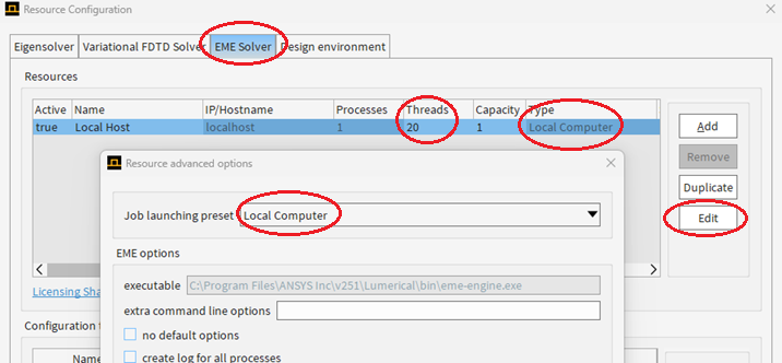

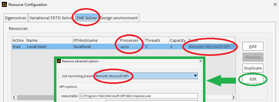

- Configure EME to run using “Remote: Microsoft MPI” and set processes to “auto” or to the number of threads/logical processors on the machine,
- Or set “Local Computer” as the Job launching preset and set threads to the number of threads/logical processors on the machine
- e.g. 20 processes for MS MPI or 20 threads for Local Computer if your machine has 20 logical processors.
- (see screenshots/images below)
- Try to run other EME simulations e.g. examples from our website; pol_converter, spot_size_converter, or fiber_bragg_gratings).
Microsoft MPI as job launching preset:
Local Computer (without MPI):

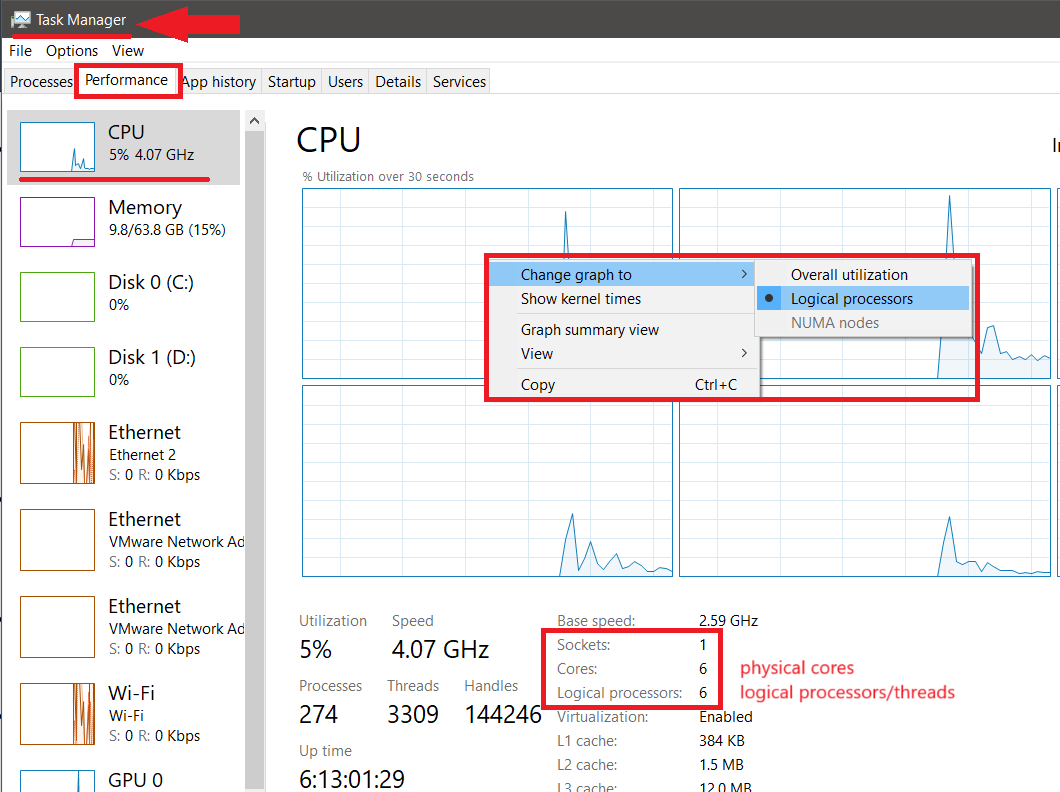

Task Manager > Performance > Number of Cores and Logical Processors:
