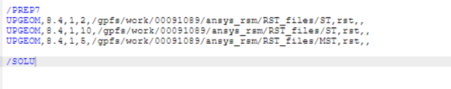

I am doing nonlinear buckling analysis with eigen mode imperfections. I have directly inserted a command in the static structural to update my model with UPGEOM command. Later, I gave run and I am getting the element shape error and warning. How to solve this issue?

You show the warnnings (due to shell thickness). Look at the error msgs at the end of the solve.out.
Likely the file rst can not be found , but look at the error msgs to confirm that
