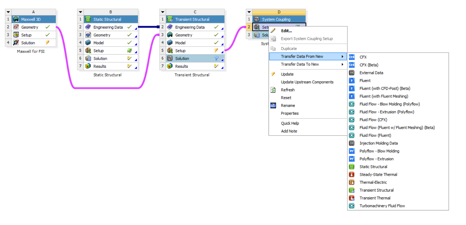

I am new to Ansys workbench and Maxwell. Can I please ask for help with electrostatic pull-in simulation for MEMS switch in the workbench? Because my structure has to use floating potential condition, Maxwell is the best option for me so far. Please let me know if I can apply this boundary condition in APDL ? (I have read both "Coupled-field analysis guide" and "MEMS Multiphysics simulation in Ansys workbench " tutorial, but nothing about floating potential condition there).
I can get deflection results from my simulation by using Maxwell and static structural analysis systems. However, my structure cannot simulate pull-in/collapse states. I have been told to use a two-way interaction method, like FSI (fluid structure interaction) tutorial, to transfer data between Maxwell and Transient structural in order to have "snaps down" mode. However, there is a Maxwell system coupling issue since my solution type for Maxwell is electrostatic. I believe that system coupling has limited support for Maxwell as shown in the following picture (not able to connect system coupling setup cell to Maxwell).

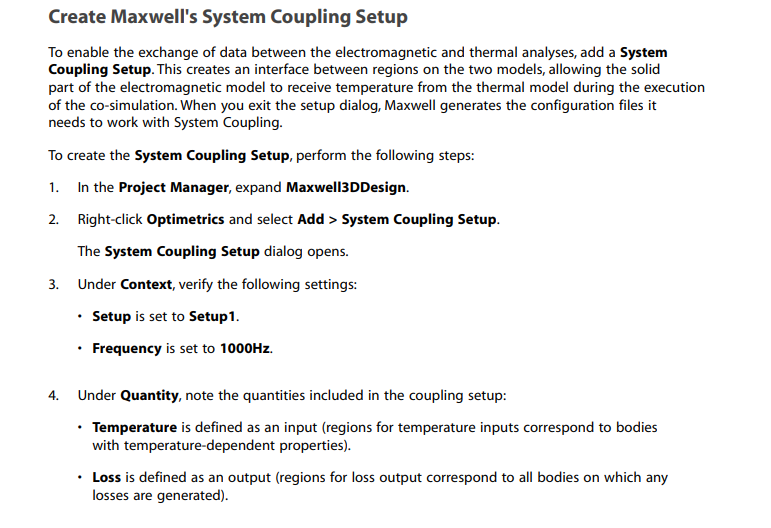

June 3, 2021 at 1:06 pmKarthik Remella
AdministratorHello Please take a look at this tutorial that uses System Coupling between Steady State Maxwell & Transient Mechanical (thermal). Please see if this answers your question.
https://ansyshelp.ansys.com/account/secured?returnurl=/Views/Secured/corp/v211/en/sysc_tut/sysc_tut_coilcore_mech.html

SubscriberDear Karthik Thanks for your help! I have tried to follow the attached tutorial, but I am now facing one problem.

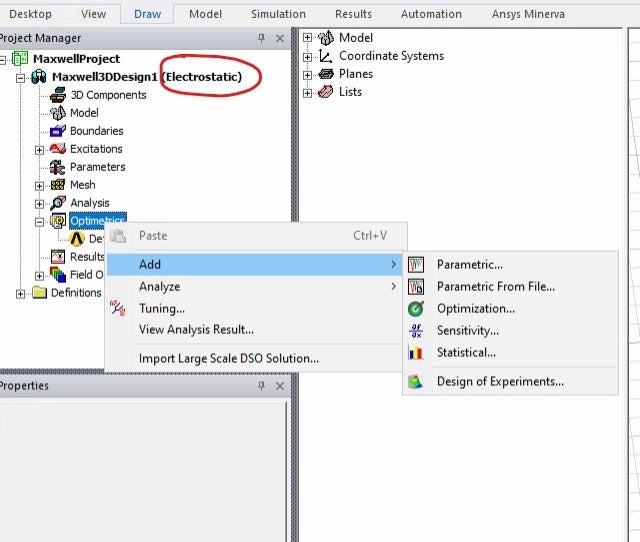

I could not find System Coupling Setup option after clicking Optimetrics. I have found that Maxwell does not support system coupling for some Solution Types, such as Electrostatic (which I am currently using). It seems to be a dead end to me to use system coupling method to simulate electrostatic pull-in/collapse states while applying floating potential boundary condition for MEMS structures.

SubscriberDear Karthik Yes, I have attached screenshots below. This is my currently WB connections. I want to connect Maxwell 3D to System Coupling.

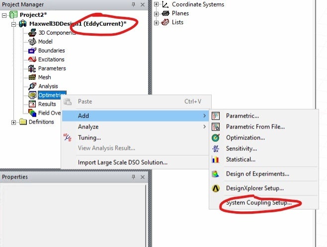

I have tried to use different Maxwell Solution Type's (both Electrostatic and Eddy Current). As shown below, I can find System Coupling Setup in EddyCurrent, but not in Electrostatic.
