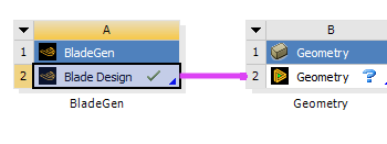

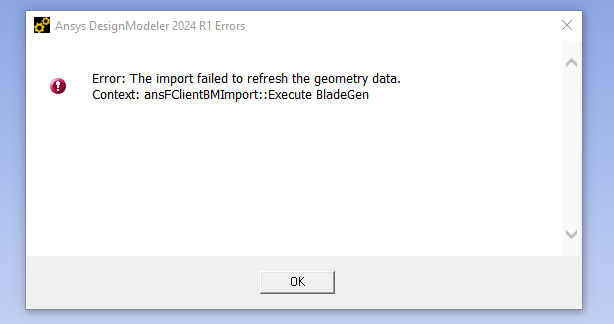

      i am trying to import a bladegen into designmodeler so i can edit the geometry. When I try to edit geometry in designmodeler it has error seen in screenshot. When I click generate it gices error: "Refresh fails: cannot open the ImportBGD file". How do I solve this?
    • CFD_Friend
      Try exporting a NDF file from bladegen and then importing it into DesignModeler using 'Load NDF' feature in BladeEditor toolbar.
