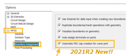

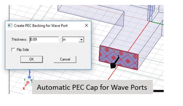

      If you want to place a Wave Port inside the analysis space, you can perform the analysis by touching one side of the Wave Port to a pec object.
      If you are using version 2021R2 or later, a setting has been added to automatically create a pec object.
