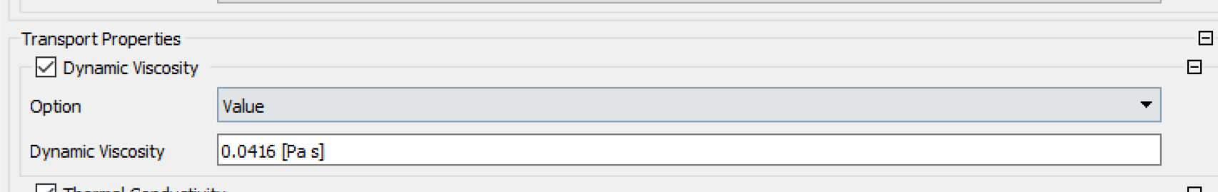

You can use CEL (CFX Expression Language) to define fluid property variation through an expression if it is required. For example, you could define Dynamic Viscosity to be a function of Temperature.
Chapter 31: Expressions (ansys.com)
