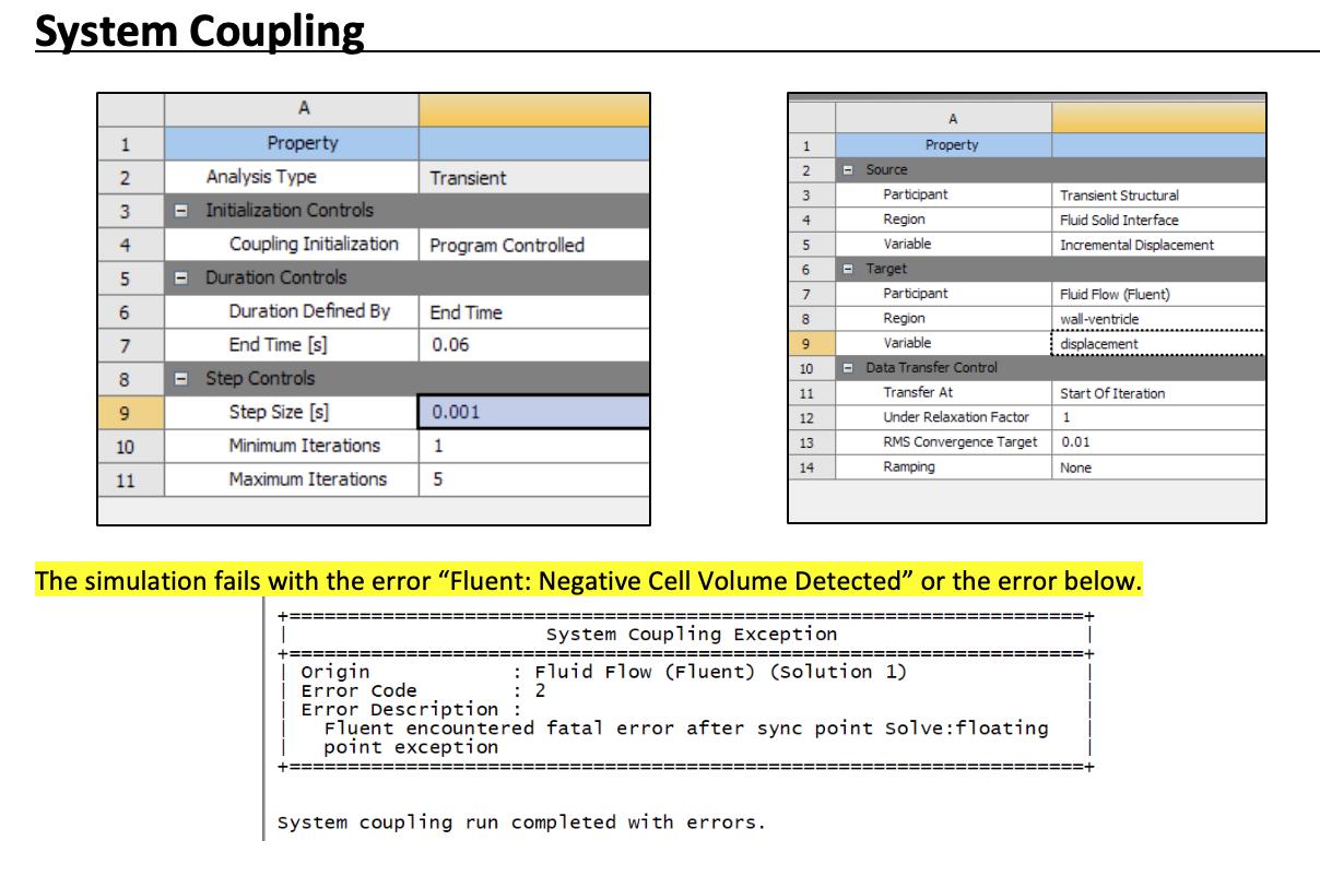

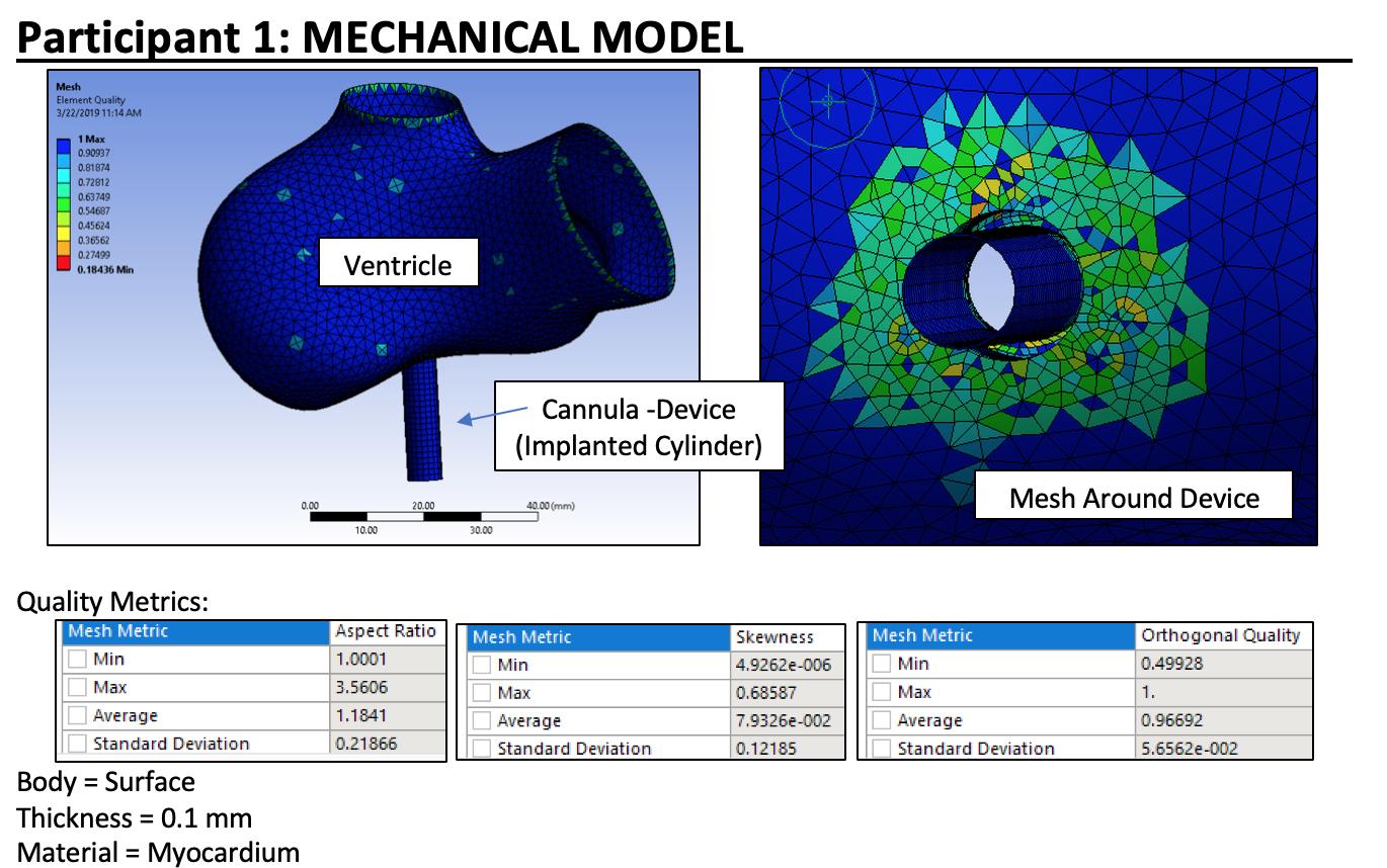

      I am trying to simulate a moving heart with an implanted device using both fluent and mechanical as a fluid-structure interface simulation (i.e. passing imported displacements from mechanical to fluent). The mechanical simulation works as expected, but the fluent simulation fails (floating point exception and negative cell error).
      Details are below. Any help would be appreciated - thanks!

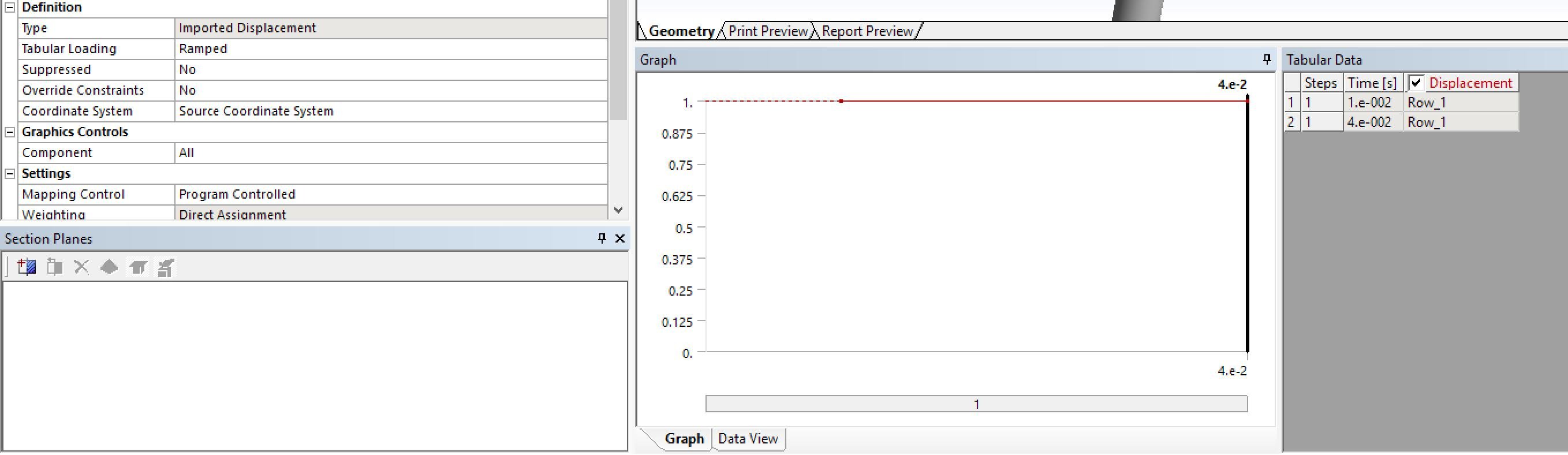

      According to my excel file, the maximum displacement is 0.995mm. As shown in the above posts, in mechanical I chose "ramped" for tabular loading. I was hoping this would apply the load over time at a slower rate.
      It might be important to add that even though I chose "ramp" on my tabular loading, my load graph does not appear to be ramped as shown below.
      For system coupling, my time step is 0.001s.
      In Fluent, I added the following body sizing to the mesh for my fine mesh:
      Element size: 1.0mm
      Defeature Size: Default 2.9902e-002mm
      Size Function: Curvature
      Growth Rate: Default (1.2)
      Curvature Normal Angle: Default (18.0)
      Local Min Size: 1.0mm
      How would you recommend I change this to avoid twisting cells?

      Update: I was able to fix the tabular loading in Mechanical so that the ramping looks correct. However, I am still struggling with the FSI simulation.

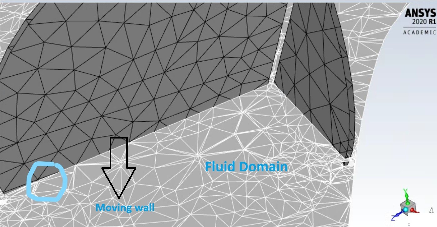

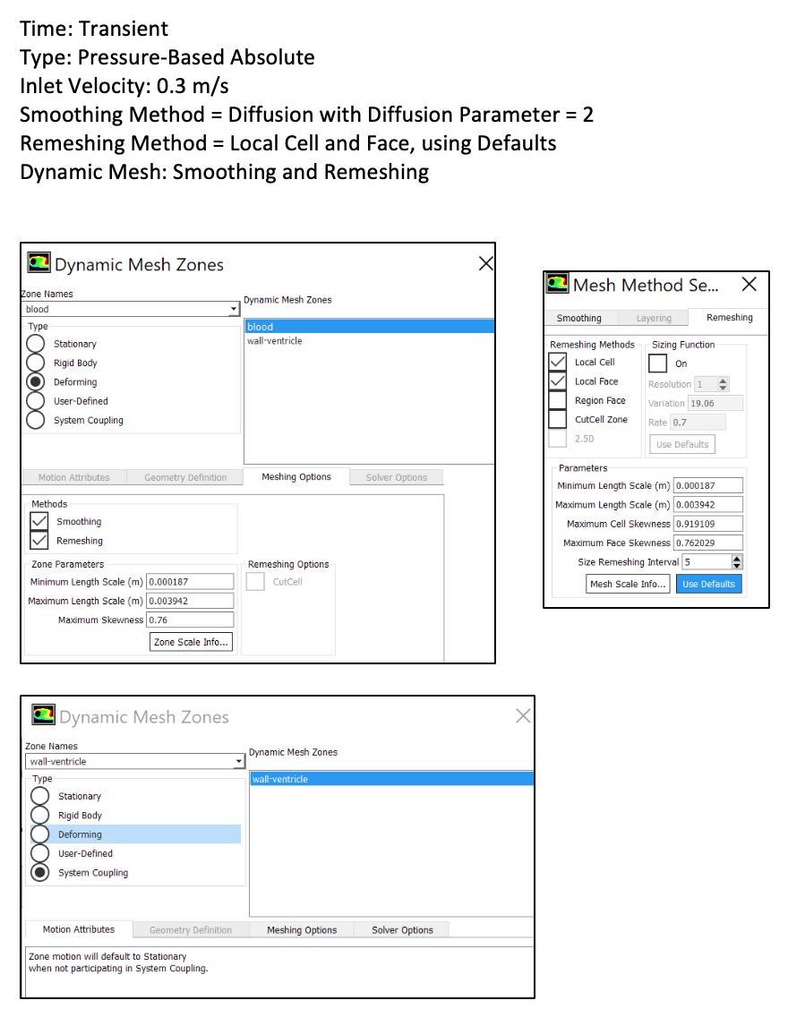

      Hello,nI am also trying to run a 3D 1-way FSI model in Fluent and after few time steps negative cell volume error shows up. the mesh is all tetrahedral and I am trying to apply remeshing on top of smoothing. I have been adjusting different parameters in smoothing and remeshing windows but still, it is not working despite having small time steps. nif I check the local cell option in remeshing, model becomes super slow and even when I do preview mesh motion, it takes forever to proceed just one timestep. while without local cell it goes through time steps very fast (and fails at some point). I have 110000 elements and it is not a really fine mesh. I am wondering why after checking local cell model becomes so slow? (one to four of cpu cores usage increase drastically and my whole cpu usage goes to 100% when I have local cell activated)nnthank youn
    • YasserSelima

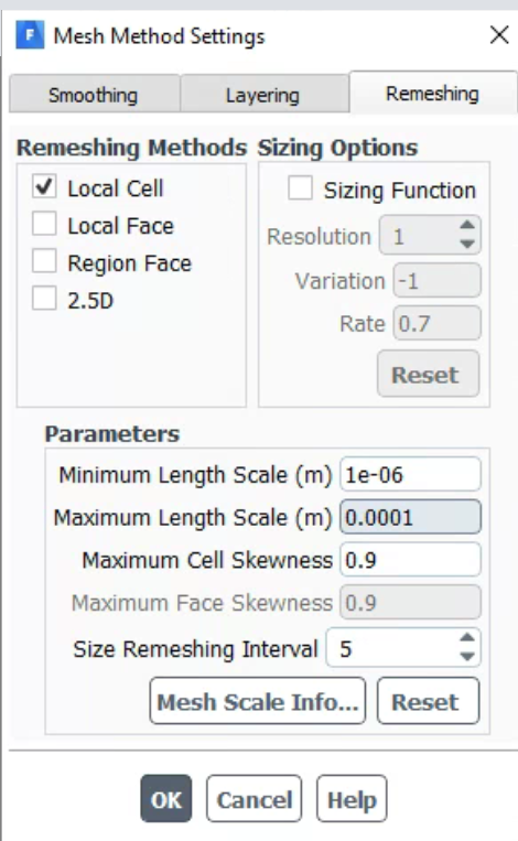

      nIf you have large displacement, only smoothing will not work as the mesh will have very high skewness and most probably you will end up by negative volume. nCan you show the parameters of remeshing? nAlso what do you consider small time step?n
    • student90
      nthank you for your message. below is the setting I have considered for remeshing:nnnnwith the above setting, it took about 20 hours (100% CPU usage) to proceed 57 timesteps and Fluent crashed at some point. (it was remeshing)nwithout activating Local cell, preview mesh motion proceed up to 46 timesteps in few minutes and it fails with negative cell volume (I could not see any remeshing)nnMy question is why by activating Local Cell Fluent becomes incredibly slow and CPU usage goes up to 100%? (and without activating local cell it seems no remeshing happens)nnand by small timesteps, I mean leaflet displacement at each timestep is very small compared to the mesh element size. below is the fluid domain mesh and moving leaflet (moving wall):nnn
    • YasserSelima

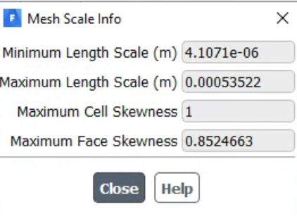

      Can you press mesh scale info and post a photo of what you get?nAlso look here. Is this the original mesh or after smoothing?.n
    • student90
      above is the mesh scale info. nabout the mesh image, it is the original mesh. what we see in that image is a cross-section of the 3D mesh. since my moving wall is inside the fluid domain I needed to define a plane to show the moving part of the moving 3D mesh.nnthank youn
    • YasserSelima
      What happens is that FLUENT mark all the mesh that does not meet the criteria and remesh them in 5 timesteps intervals.nMake the minimum length scale 0 and decrease the maximum to be in the same order of other mesh. and decrease the skweness ... I think this is what makes fluent mark most of your mesh to be remeshed. nIf you have fine mesh close to the wall, once the wall moves, they get a length scale below your minimum and get skewed .. and get marked for remesh. nHowever, remeshing should not be slow as you describe unless you run out of memory. Remeshing requires large memory , in addition to the simulation DATA that stays in memory, you might run out of memory ... And in this case, FLUENT uses the HDD drive as memory .. and this makes everything slow as you describe. Monitor the memory, if you go out of memory, consider running the simulation on a different computer if possible.n
