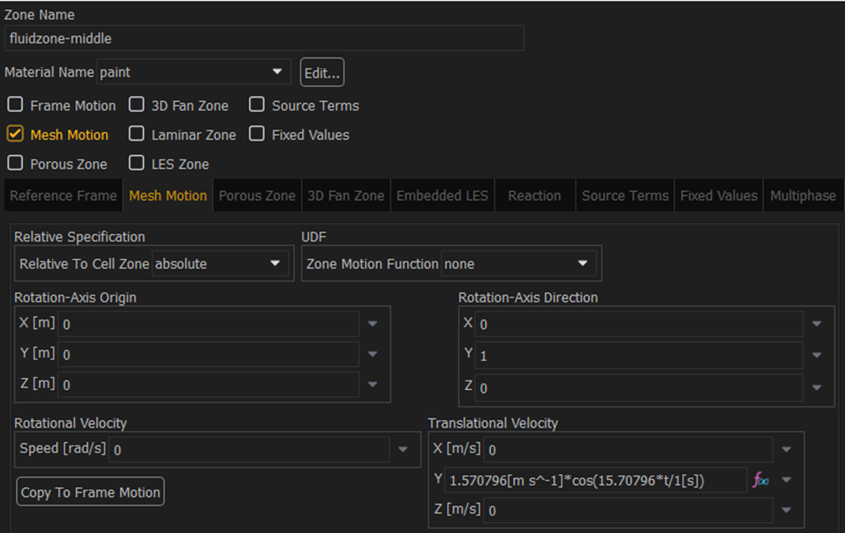

      Mesh Motion has been defined on the middle-static zone and an expression causes the middle static zone to translate along the Y axis.

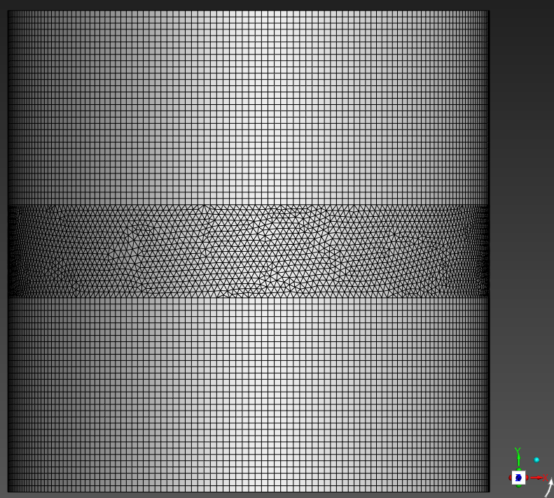

      Here is the initial mesh.

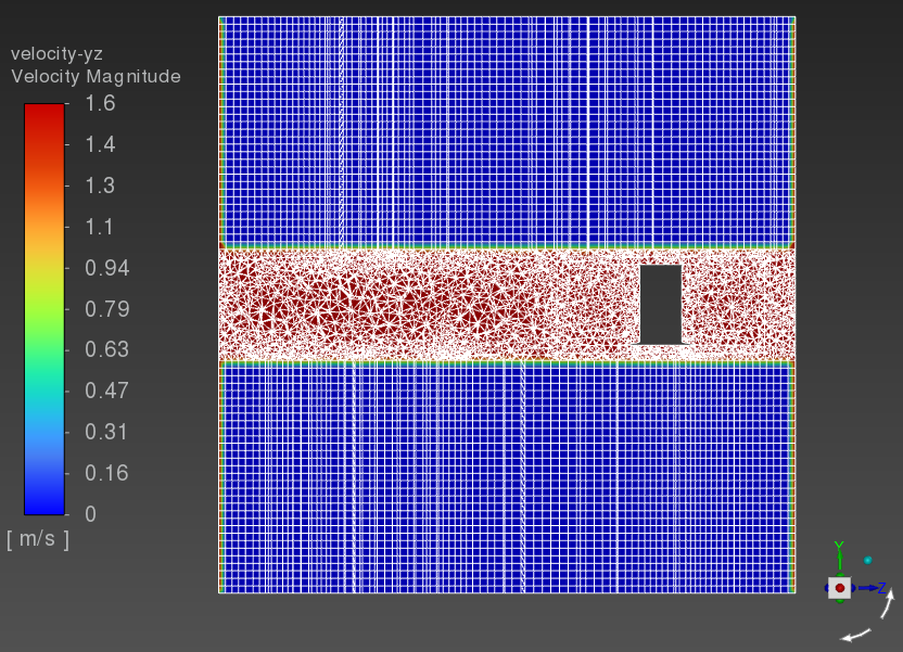

      Here is the mesh at a later time step.
      Top and bottom tanks zones are deforming, and the propellers are moving up with the middle zone. Notice the compressed thickness of the bottom row of the top and the stretched thickness of the top row of the bottom. The next time step results in a negative cell volume error. Dynamic Mesh was edited to try Smoothing and Remeshing but the negative cell volume error persisted.

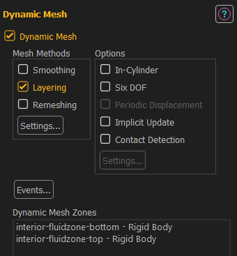

      I created two Dynamic Mesh Zones, one for the top and one for the bottom fluid zone and chose Layering only.
      When I click on the Settings for Mesh Methods, I see the Layering constants.

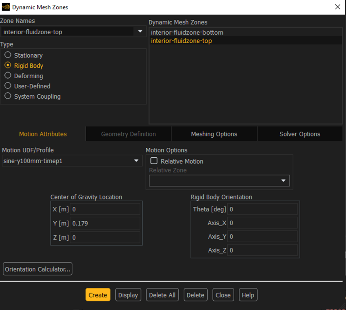

      The motion of the middle zone follows a sine expression. When I add a Dynamic Mesh Zone for the fluidzone-top-static and set it to Rigid Body, there is a box for Relative Motion, but it does not allow me to see any zones in the pull down.
      I don’t have a Motion UDF/Profile because I used an expression directly in the Translational Velocity Y component for the middle zone condition.

      Each layering cell zone should be set as Rigid Body Motion (with the motion following the oscillating sin expression). It will move the entire cell zone according to that expression.

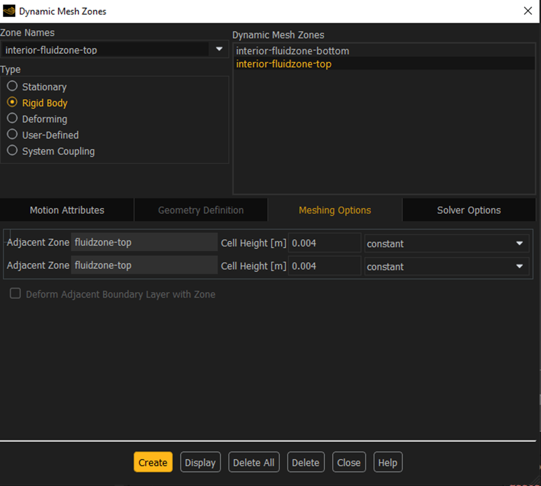

      To set the location of the Layering collapse/split, you need to have a boundary zone for the Top wall and a second for the Bottom wall. Set them as Stationary in the Dynamic Mesh zone settings. When you do, go to their corresponding Meshing Options (still in the Dynamic Mesh Zone settings page) and define the Layer cell height.
      The mesh motion set for the inner zone with the sliding mesh can remain as you had previously set it up.

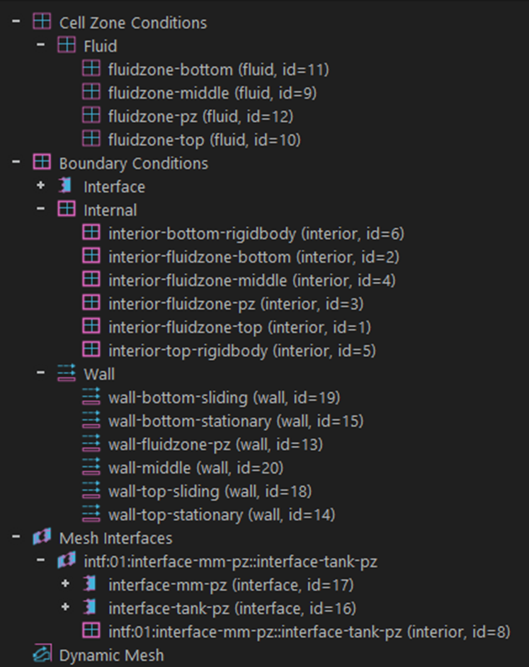

      I have a clean model with revised zone names as shown below. The fluidzone-pz is contained within the middle zone but with a non-congruent mesh, so there is an interface defined. For this first attempt, I will not define Mesh Motion for the pz relative to the middle.
      Here is the Mesh Motion with an expression on the fluidzone-middle.

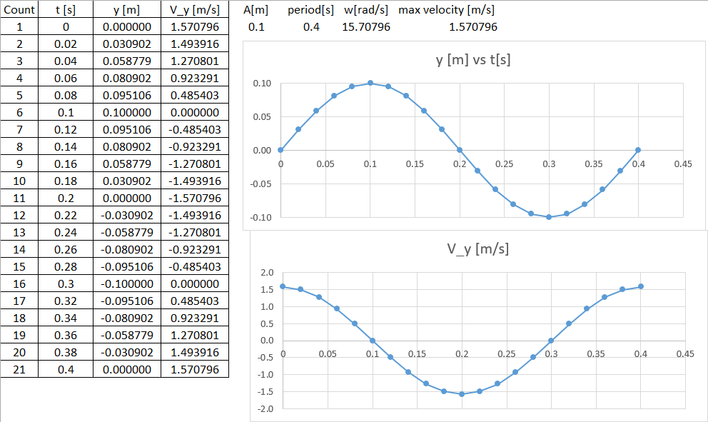

      I created a Rigid Body Dynamic Mesh Zone for interior-bottom-rigidbody and interior-top-rigidbody and they are assigned a Motion Profile that is the Y position vs time. Is it okay to use a Y velocity expression on the middle zone, and a Y position profile for the interior-top-rigidbody surface or is it better to create a Y velocity profile for the Motion Profile of the interior surfaces?
      Is it true that Profile data should be in meters even if the mesh is in mm?

      I was able to define a Cell Height for the fluidzone.  I don’t understand why there are two rows.

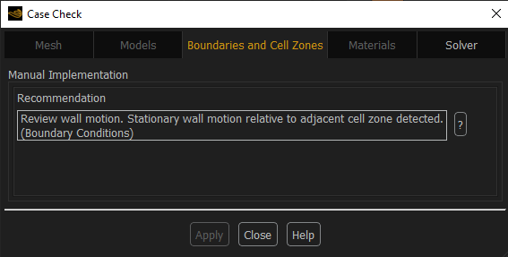

      When I Check Case, I get this recommendation.
      Does this suggest there is an issue?

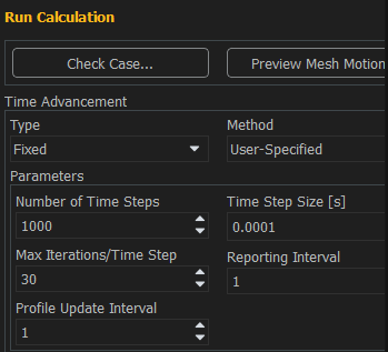

      I tried to Run Calculation with these parameters.

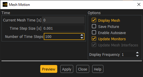

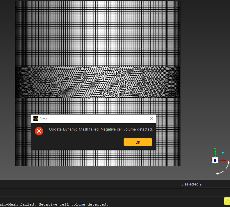

      I tried to Preview Mesh Motion… using 100 steps to get to a time of 0.1 s that should be 100 mm of upward motion of the middle section in a tank 300 mm tall.
      Unfortunately, I got a Negative Cell Volume detected error.
      I’m not sure what needs to be set to deforming, is it the top and bottom fluidzones or is it the wall-top and wall bottom cylidrical faces?
      Please advise.
