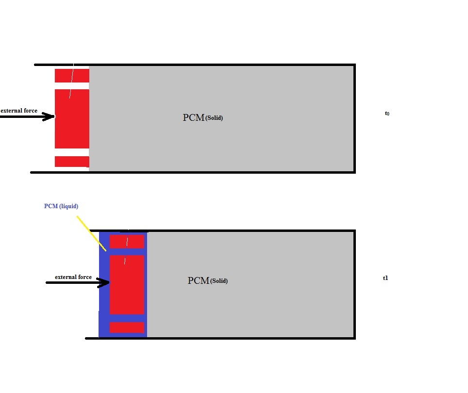

      I want to simulate the process of melting a PCM in a cylinder. By melting the PCM, the melted PCM exit from the cylinder and the piston move inward.

      It depends on what you're expecting to see. The melting model uses a viscosity approach to "freeze" the solid part so it doesn't move so depending on how/where you're applying the compression you may find nothing happens. Please can you post images of what you're trying to do in with some text giving more details? ANSYS staff can't open/download files.

      initially the PCM has solid phase. By heating the piston (the piston has a electronic element), the PCM will melt and the melted PCM exit from cylinder due to external force.
      I want to see the movement of piston.
      thank you
      That should work, you'll just need to be careful how you define the motion and mesh the domain to make sure the fluid can exit the cylinder.
