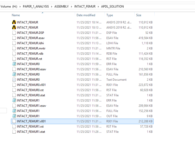

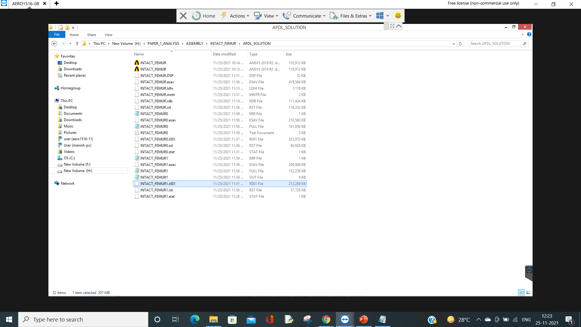

      Once i solved my analysis, More than one result file, log file and some other except .db and .dbb generated and saved.
      file name for duplicate files is differ by only ------0.rst, ------1.rst like this. Please find the image attached for better understanding. It increased my simulation folder as well as simulation time. Please help me out.

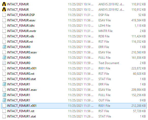

      Are you using distributed solver with 2 CPU's? This will result in two split result files. Example file0.rst, file1.rst (split result file for each CPU)
      You can turn off distributed solution and solve the model again
      remove the -dis from the command line (4.1. Starting a Mechanical APDL Session from the Command Level (ansys.com))

      See this is image in reference to my question.

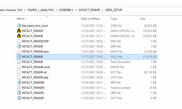

      Thanks My setting was at distributed mode so the problem of two or more duplicate files is resolved but still there are duplicate files generated by ansys for few file format as .err, .txt document as you can see from this image
      Can you please tell me anything to resolve it?
