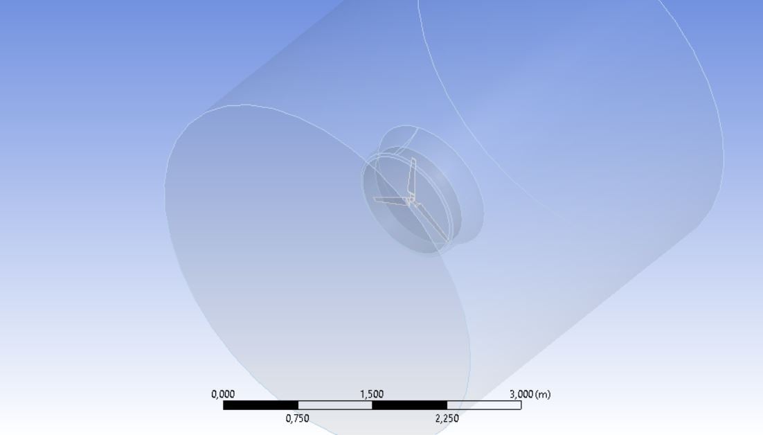

      Dear all,
      I'm currently working on a ducted wind turbine for a university project where the aim is to evaluate the torque of the turbine inside the duct.
      As the first step, I created a rotating domain that includes the turbine and an external domain that includes the duct. Then, I created three booleans: one between the external domain and the rotating domain where I preserved the body, one between the rotating domain and the blades where I didn't preserve the blades and the other between the external domain and the duct where I didn't preserve the duct.
      After that, I created an automatic mesh and in the image below you can see the problem:
      In the yellow zone (the zone between the rotating domain and the duct) I don't have more than one layer so when I try to run a simulation in Fluent I cannot obtain any results due to the quality of the mesh in that zone.
      I tried to use inflation layer or refinement around the duct but the problem seems to not be solved.
      I don't know how to attach here my workbench file, so if someone desire to work on it, please just tell me how can I do and I'll do it as soon as possible.
      I hope that someone can give me the solution / int to solve this problem.
      Thank you very much!

      Dear all,
      I attach here my ansys workbench file
    • Keyur Kanade
      you will need to give face sizing at that location to get more no. of elements.
      please see
      https://www.youtube.com/watch?v=ODJ11YDC6ac
