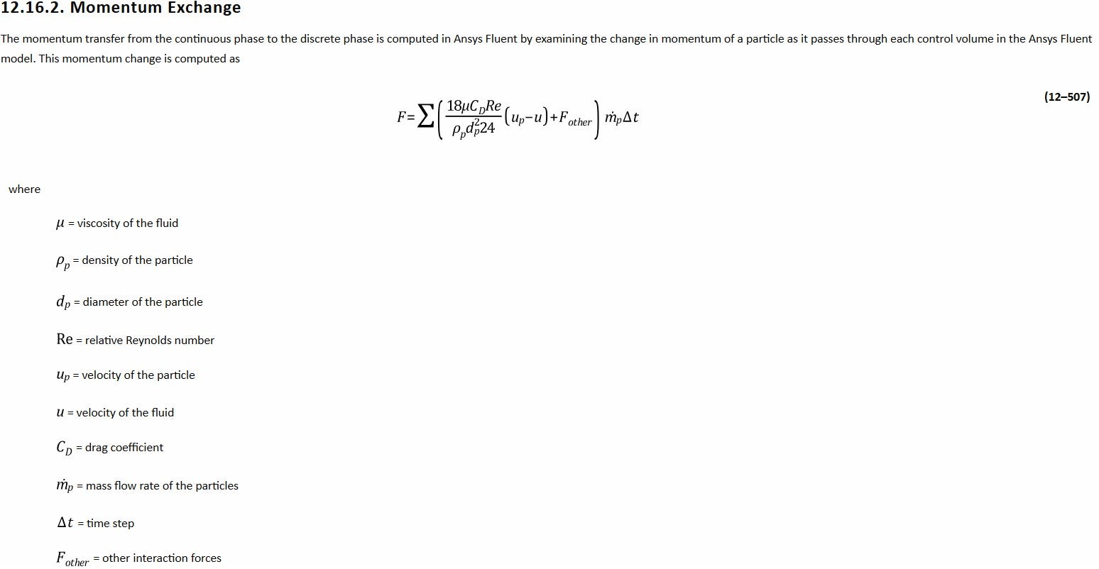

        I understand. Another thing: I’m sending you a screenshot of Fluent’s documentation regarding the momentum source in a two-way coupled simulation using DPM. What are meant by “other interaction forces”? Are the buoyancy (the force appearing on the particle when gravity is enabled) and virtual-mass (the one that can be checked directly in the GUI) considered as such forces? I tried putting a bubble in a quiescent fluid and only activating either the gravity or the virtual-mass (the later while giving a little kick to the particle’s y velocity), and the y-momentum source values returned were in the order of 1e-24 to 1e-27 Newtons, which is incredibly small. Those values were obtained by summing the y-momentum DPM source terms over the entire domain (so I supposed they are still Newtons). Bottom line: I have a lot of trouble concluding wether those 2 forces participate in the momentum source term. Also, there’s this line in section 24.9.6 of the User Guide, version 2024R2: “The exchange terms are reported as the rate occurring in each cell” which confuses me a little regarding the units of the reported DPM source terms.
      Other forces will be gravity, collision effects, "other" DPM models and whatever else isn't covered by drag. Most models have a "other stuff" term to account for any user coding (UDFs) or future development work.
      Not sure about the result, how quickly was the particle moving?
