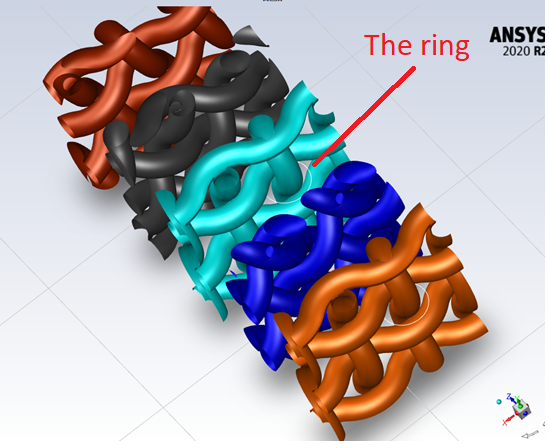

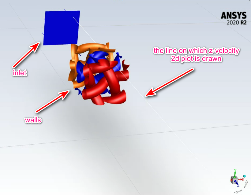

      In the following problem, I have a geometry consisting of multiple layers of screens that are supposed to filter out the particles from the incoming contaminated flow.
      A steady K-Omega SST turbulent model is used to solve the flow. The duct dimensions are 0.4*0.4*15 mm. There is a one-way interaction between the particles and the flow. Therefore, the flow is solved first. After convergence (errors down to 1e-10 or lower), the particles are injected at the inlet using the group feature (3 groups of 20 parcels) with the same velocity as the flow at the inlet. the particle size is 1 micron and their mass flow rate is 1e-20 (infinitesimal).
      In the following, you can see a screenshot of the CFD mesh. 7 layers of inflation are added. The cell size close to the walls zone is 4e-6m and away from that (I call it downstream and upstream of the domain) is 8e-6 in one case and 16e-6m in the other. The problem is that the number of trapped particles on the walls is dramatically different in these two cases while the CFD mesh is different only away from the walls. I have checked the Z-velocity (the velocity along the duct) as a grid study parameter and the graphs align very well. So, the grid resolution seems to be sufficient. However, DPM results are different and we know that for Lagrangian solutions, as long as the flow is converged and consistent (for the drag forces), DPM results should not vary with the grid size since it just calculates the particles' trajectories by solving F=ma for each particle along its path.
      additional information: BCs: velocity inlet (1.7 - 3 m/s) pressure outlet (0 gauge) Symmetry walls on 4 side walls of the duct,  no-slip walls for the screen walls.

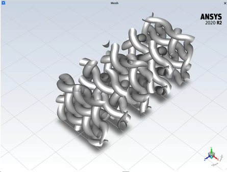

        I have cylindrical walls (representing screen wires) that are subtracted from the bulk air duct. The wire diameter is 100 microns and the screen opening is 200 microns. My domain is purely made of air with the walls subtracted. The walls are solid and not porous and a "trap" DPM boundary condition is applied to them. Therefore, neither the flow nor the particles pass through them. Yes, I am trying to count the number of the particles that will hit the walls and then will be eliminated from the domain and will be counted as captured in the report.

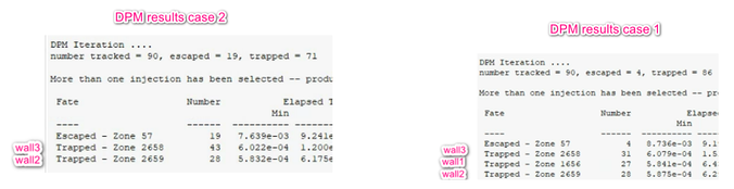

        All the walls (screen wires) are set to "trap" the particles in their DPM setting tab. They are solid walls and neither the flow nor particles penetrate them.

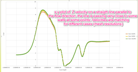

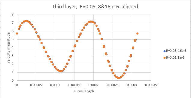

        The issue is that even though the flow parameters show an identical trend with all the different mesh resolutions (scatter plot of flow z-velocity on a line according to one of the uploaded photos or skin friction factor on the walls), I am getting different numbers of trapped particles at the walls with different mesh resolutions in either vicinity of the walls or away from the walls. As I explained earlier in the previous posts, using the "body of influence" meshing feature, I give fluent meshing two mesh element sizes: one in the vicinity of the walls (called vicinity region) and one away from that (which I call up/downstream)

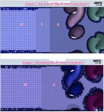

        Here are some of the particle trap results for different mesh resolutions:
        1- up/downstream 16e-6 , vicinity 4e-6.   # trapped= 50/60
        2- up/downstream 8e-6 , vicinity 4e-6.   # trapped= 35/60
        3- up/downstream 4e-6 , vicinity 4e-6.   # trapped= 26/60
        In the studies above, I kept a constant mesh size for the vicinity region and changed the mesh size in the up/downstream region only. Also, in another study that I carried out earlier, I kept the up/downstream mesh size constant and changed the vicinity mesh size and the DPM results still change drastically. In the photo below, you can see better what I mean by vicinity and up/downstream regions.

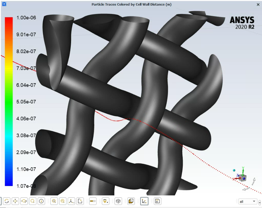

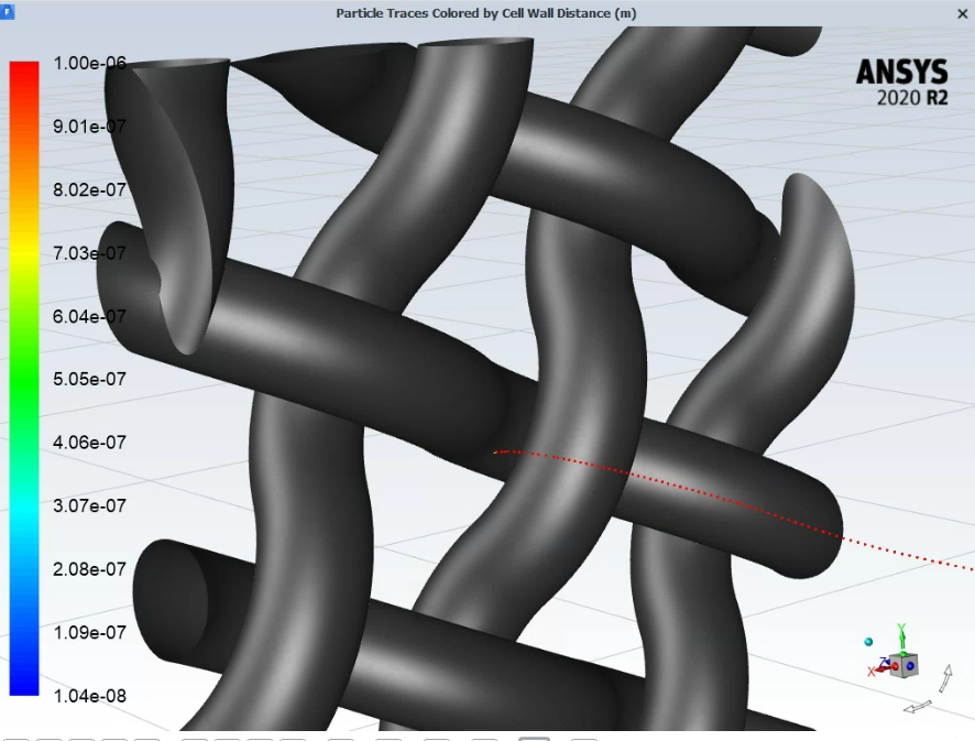

        As you can see in the photos, the wires are not straight cylinders and are curved. This is what the particle track looks like for a group injection of 5 parcels for 2 different cases. The body of influence feature has been used for mesh generation and CFD mesh size close to the walls is 4e-6m for both cases and the mesh size up/downstream of the walls is 8e-6m in one case and 16e-6m in the other. All the other settings are the same for both cases and only mesh size has changed)
        in the images below, you can see that a specific particle injected at the same location and velocity and ... in both cases ends up getting trapped in one of the cases and in the other one it maneuvers and passes the wall and ends up escaping the domain at the outlet.
        Please note that what you see in the photo is the 4th screen layer and the particle track is coloured by its distance from the wall in the range of [1e-8 to 1e-6m].

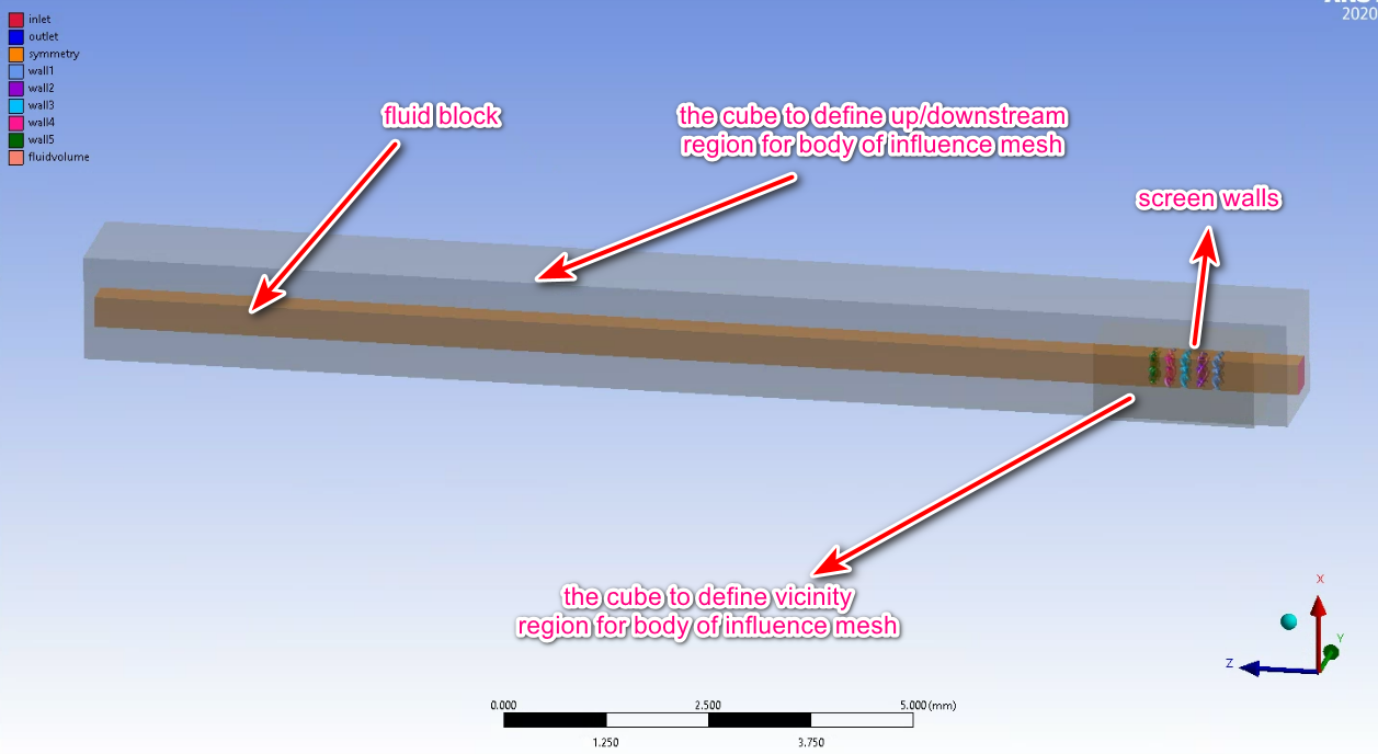

      Using the "Body of influence" feature in meshing, I have created a denser mesh in the vicinity of the walls (screens) but by changing the mesh resolution either in that area close to the walls or far away from them, I get different numbers of trapped particles after particle tracking.

      OK, with 90 particles you're also subject to statistical issues. Assuming it's turbulent switch on turbulent dispersion and number of tries to 10-100. You need alot more particles.
      The difference may be mesh/flow related, but could just be injection position and luck, hence putting in many more parcels.

      2- the flow (velocity and pressure field) may actually not be fully resolved. As described earlier, I see an identical trend of the Z-velocity plot on a line drawn parallel to the flow direction (please refer to the following images). However, when I report Z-velocity on a specific point in the domain, I see up to a 10% difference in z-velocity for different mesh resolutions. These local differences may change the particle path since it will appear in the drag force on the particle in F=ma.
      If this is the reason for my issue and I still need to decrease my mesh element size, what is a better criterion to check whether the flow parameters are fully resolved?

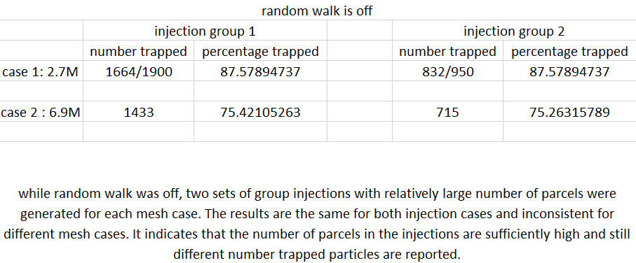

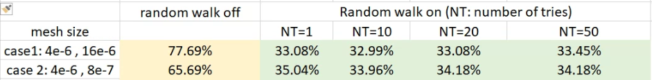

        I am injecting 716 particles using the surface injection. To test whether it is enough or not based on what you suggested, using the group injection feature, I once injected 1900 particles and then injected half of that number, 950 particles. The percentage of trapped particles was exactly the same for both of the injections. Please refer to the screenshot. therefore, I believe the number of injected particles is sufficient.
        With the Random walk model activated, I used to get different results each time I tracked particles, but I get the same number of trapped particles. The good news is that this number is not changing for the different mesh sizes. So, I'll keep the model activated for my future studies. however, I would still like to know why my results are changing with mesh when this model is not active since one part of my research is studying the impact of the random walk model on the particle capture results.
        For the mesh independence, as you can see in the previous posts, for different mesh size cases, I plotted flow Z-velocity on a line that is parallel to the flow and I can see that the results are matching very well. Moreover, in order to study the velocity close to the wire walls, I created rings around a wire and plotted the velocity magnitude on this ring for different mesh size cases. Again, the velocities are perfectly matching for the 2 mesh sizes (8e-6 and 16e-6m) You can find the relevant photos in the following. Consequently, I believe my flow is mesh-independent and the problem must be coming from the DPM settings. I would be glad to further analyze it if you have any suggestions to investigate the mesh independency in a better way. By the way, the skin friction factor is also identical for the two mesh cases (up to the third decimal digit).
        I think DPM is considering the particles point-wise and doesn't consider their radius in the capture criterion. The reason I say so is that I can see that some of my particles get closer than a radius distance to a wall but won't be considered captured and escape away eventually. please let me know if you found any documents on how "trap" on walls works and whether I'm wrong. Although my particles are small and this won't be a big deal for my case, it's good to know how the model works.
        Thanks for your time
      • reza121
      • reza121
      • reza121
      • reza121
        By the way, I also tried the Random walk model whit number of tries = 1, 10, 20, and 50 and I get similar results for all of these cases for different mesh sizes- ~33% for all of them (As I said, with the Random walk model activated, there seems to be no problem with the mesh sizes). So, again, I think that I am injecting a sufficient number of particles, and whatever the problem is for the random walk-off case, it must be with my DPM settings. Do you have any thoughts on that?

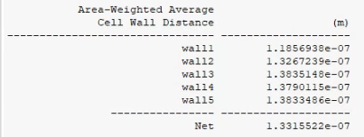

      How large are the cells (wall normal distance) relative to the particle size? We only check for wall proximity in the near wall cell.
      Put your Reply in the “Reply To: DPM results changing with CFD mesh resolution” box.
    • reza121
      Hello Rob,
      The particle size has always been 1 micron for all the cases I have studied so far. The smallest I will ever track later will be 0.1 microns.

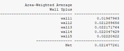

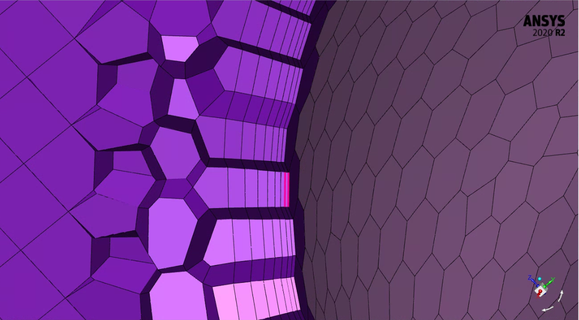

      here's a screenshot of the Cell Wall Distance reported in fluent on my walls. I got it using the following path:
      reports>Area-weighted average>mesh>cell wall distance> All my walls
      Also, Using Fluent meshing, I selected one random near-wall element on one of the walls and measured its height. it was: Distance = 2.016724e-07 as you can see in the following photo.
      I couldn't find any better way to report near-wall cell height in fluent meshing. If you know any, please let me know.
      And if you are interested, here is my Y+ reported as Area-weighted average on my walls again. Based on these values, I guess my near-wall cells are too thin. I purposefully created a fine mesh to make sure that I am in a safe zone on the Eulerian side of the solution.

      You probably overlooked previous posts. The number of trapped particles is changing a LOT for different mesh sizes I have run so far. As you can see in the photo below, I get 77% for one mesh size and 65% for another. The purpose of this study is to investigate the impact of some parameters like wire diameter in my screens, screen layer distances, velocity and … on the particle capture rate. If I can’t get consistent results for one particular case, I won’t be able to compare my results for different cases when I am studying these parameters. Please double-check the previous posts and let me know what you think and where the problem could be.
      Thanks in advance
    • DrAmine
      But you are getting proper results when random walk is on and that what one is aming for.
      Do you know the goal of random walk? Do you know why increasing the number of trajectories is important whenver one wants to make a mesh sensitvitiy analysis?
