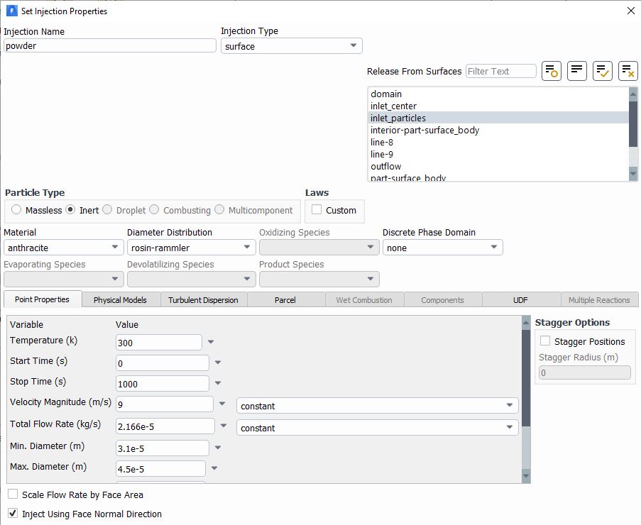

      Please Add some screenshot if injection and DPM panel and tell us what you want to visualise.

      I inject the particles from a surface, in a continuous flow, that's why I have put stop at 1000s.

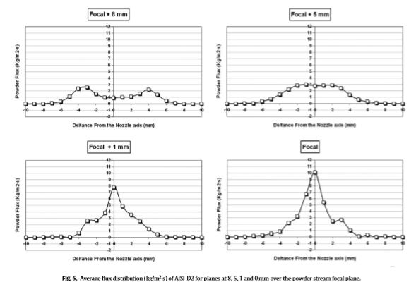

      I would like to do something like that (from the article "Numerical simulation and experimental validation of powder flux distribution in coaxial laser cladding.") :

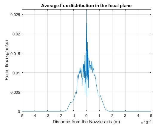

      I have exported my datas with File>Export>Solution data> ANSCII and by multiplying DPM by the velocity I have
      But to have that, I have needed to take the values for all the planes between 0.04975 and 0.05025 . If I take only the plane at 0.0500 m from my injection I only have two values. It is maybe because there is not enough particles injected or not continuously, but I have put the flow rate...

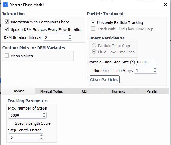

      If you're running transient particles it's very possible that they've not got anywhere in your model: the oldest have only been in the system 0.006s!
    • DrAmine
      1/Why unsteady particle tracking? I guess steady streams being injected makes a sense here with the flow being steady-state
      2/Post-Processing: Either you create a sample at the planes and then read the sampled data back into Fluent fgo to histogramm and get the mass flow of all particles and divide by the area. Or do all via UDF. Or do it by enabling mean values under DPM Panel: then you will get DPM Mean quantities which can be used to get a sort of mass flow. Divide then by area.

      Rwoolhou, Yes they don't stay for a long time in my domain but it is not a problem beacause I whant to know if there are a lot of particles going through one point after my injection. I want to have a particle flow at one point. Do you suggest I should do a steady particle tracking ?
      Abenhadj, I have used Unsteady beacause I wanted a continuous injection. With unsteady I can say the start and stop time of my injection while I can't in steady. Did I do a mistake ? Just to know, my continuous gas flow is turbulent.

      In steady-state you will also a steady continuous injection.
      With plane I really mean a plane and not an iso-surface. You can create that under Results. Perhaps you have already defined the planes where you need exporting already as interior so that you do not need to create anything just make a sampling there.
