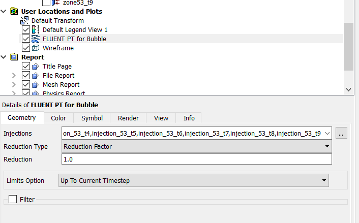

I'm working on two phase DPM (water as continious phase, air as dispersed phase) DPM simulation of a bubble column (Fluent v19.2.)
The issues are as follow
1) Exported Particle Histry data from fluent [file type CFD post, .xml file].Importing this file in CFD Post, it is not showing any particle tracking, blank.
2) Varibles such as DPM volume fraction, Mean DPM volume fraction, custom field function varibles are selected in data file quantities. Howver, when the data file is read in CFD post, those varibles are not showing, only defaults varible are showing.
How to visualize Particel tracking using CFD Post?

September 3, 2021 at 6:21 amAmine Ben Hadj Ali
Ansys EmployeeI am not sure if there were some issues in the past when reading particle tracks in CFD-Post but as far as I remember it should work. Please export on injection track and check if it is shown in CFD-Post. Also try to change the method from "Reduction Factor" to Number of Tracks.
All other "Euler" variables: you need to export into CFD-Post Compatible format (*.cdat). Fluent dat files are restart files for Ansys Fluent.
