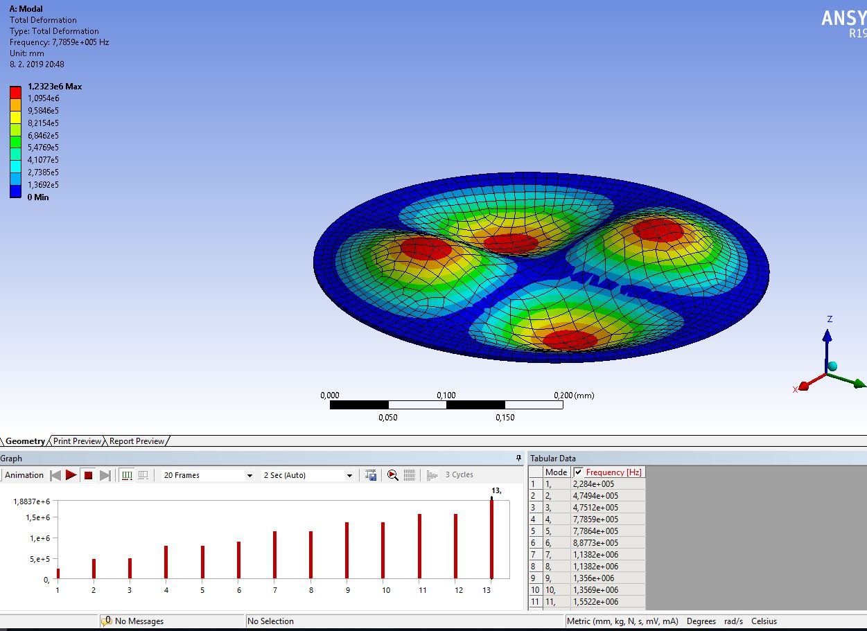

      i am trying to find normal modes of simple ideal circular membrane.
      I chose strecutral steel as material, and geoemtry is: diamater is 0,391mm, thickness is 0,0035mm.
      However, i got "double" modes: every two modes are very very similar - with the almost same value of frequency.
      i got same answer with other commercial program.
      I tried to chcange mesh, i tried do model my geomtry as solid and also as a shell/surface but i got the same problem.
      see pictures: mode 4 and mode 5 is only ONE mode in reality. Why i got this result?
      mode_4
      mode_5
      To a mathematician, there is only one mode since they generalize that the orientation of the mode in the circle is arbitrary.
      To ANSYS, there are two modes since it treats X and Y axes as separate and it can't recognize that these two modes are just offset by some rotation about the center.
    • kravky
      Thank You for explanation.
      Should i define polar coordination system in order to get mathematically correct solutions? (not to have double modes)
      No, you just have to recognize the pairs are the same mode separated by a rotational angle.
