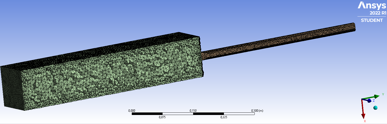

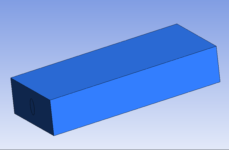

I am working on two different injection shapes, After both solutions i grouped it in "Results" to compare it, but it's not showing my complete geometry.
GEOMETRY:
May 5, 2022 at 4:24 pmRob
Forum ModeratorAssuming the pipe has a mesh in it, what happens if you display the surface as opposed to the wireframe?
May 5, 2022 at 5:13 pmMay 6, 2022 at 3:58 pmRob

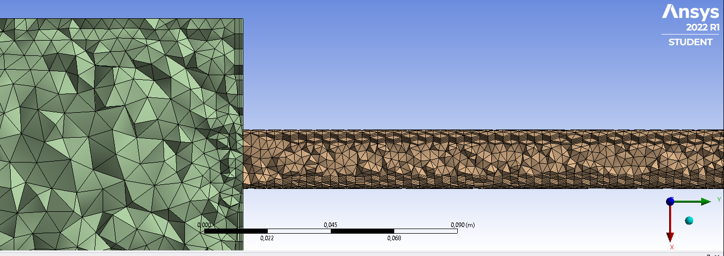

Forum ModeratorNo, it means something went wrong at the geometry or meshing stage. In meshing put a cut plane along the centreline to see if you have the pipe, I suspect you lost the volume at the geometry stage.
May 9, 2022 at 7:45 pmMay 10, 2022 at 11:04 amRob
Forum ModeratorYou've got a mesh, and it looks to be filling the volume. Are you running in CFX or Fluent? In Fluent check the Display, in CFX-Pre you should see everything too.

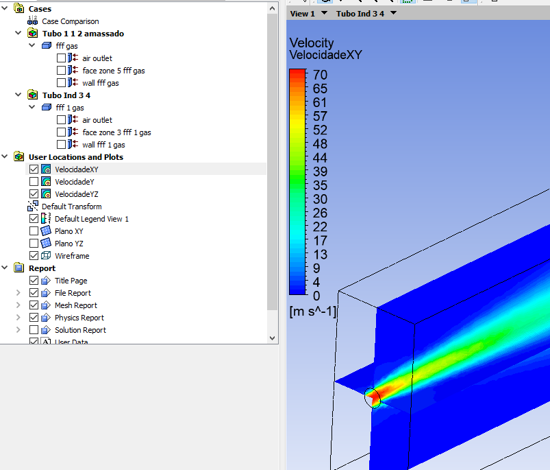

SubscriberI am running in Fluent. Ploting contours in Fluent, this region appears, while using Results (from Custom System Tree) to compare 2 different geometry flows, it doesn't appear.
May 10, 2022 at 11:22 amRob
Forum ModeratorOK, that's CFD Post. Can you check you have both fluid zones in Post, and when you create contours etc that both are picked/visible?

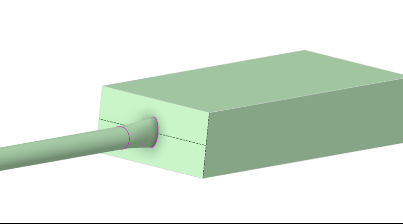

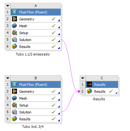

Subscriber1st (A): Modeled (SC), meshed, Fluent run and linked to CFD Post.
2nd (B): copy A and remodeled geometry (SC), update meshes, Fluent: update meshes and surfaces (match zones), update solution and linked to CFD Post.
Both doesn't show inlet pipe.
May 11, 2022 at 12:22 pmRob
Forum ModeratorIf you open the Results in the A-block and B-block separately does the inlet show up?
May 11, 2022 at 1:20 pmelisio
SubscriberIt doesn't.
