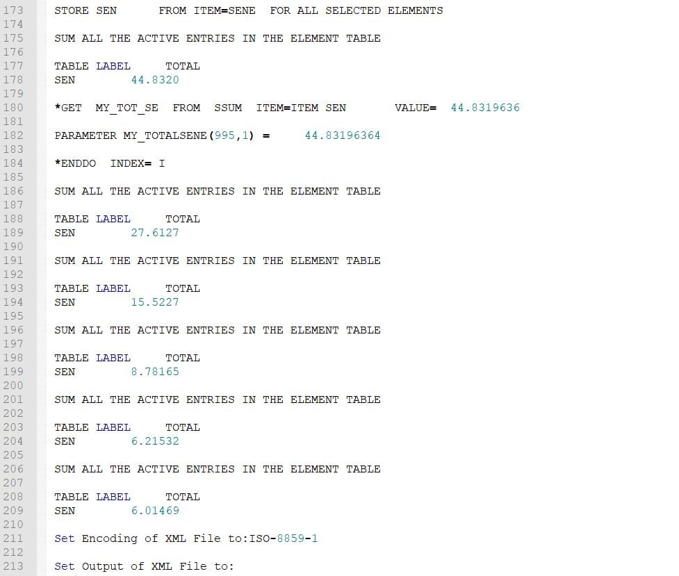

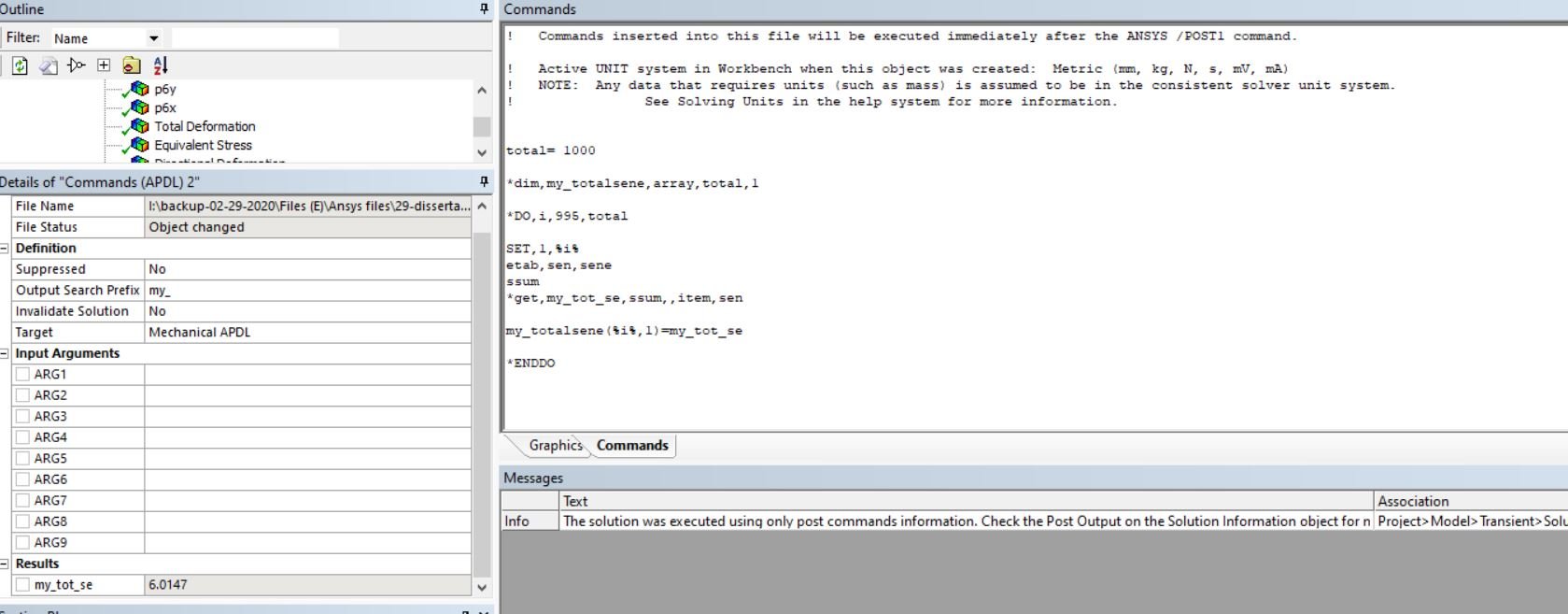

      1) so first, apparently "%i%" in the "*get" line doesn't work, so, I just removed it, no problem so far. .
      2) then I added "my_" term to the beginning of the parameter "totalsene" as the "Output Search Prefix" is set to "my_", but after solving the command, it still only recognize "my_tot_se". Please see the first picture attached. Do you have any idea?
      3) Searching for the "my_totalsene" array, I could only find the results in the "post.out" file as shown in the second attached picture which are the results of sets 995 to 1000. Is there any way that I can write or save the parameter somewhere so that I can only copy and paste the results, not all other information?
