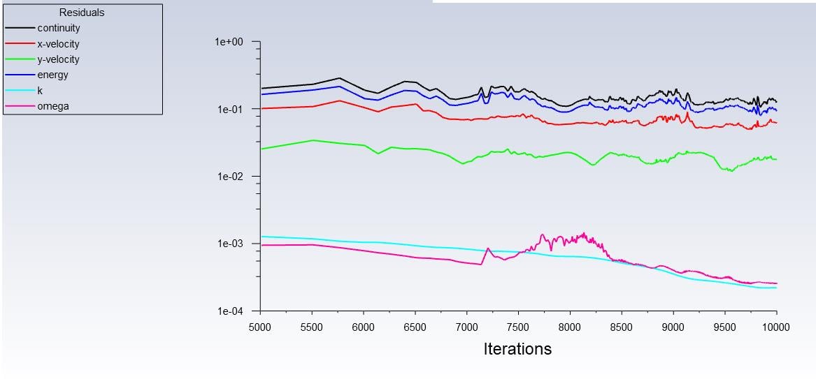

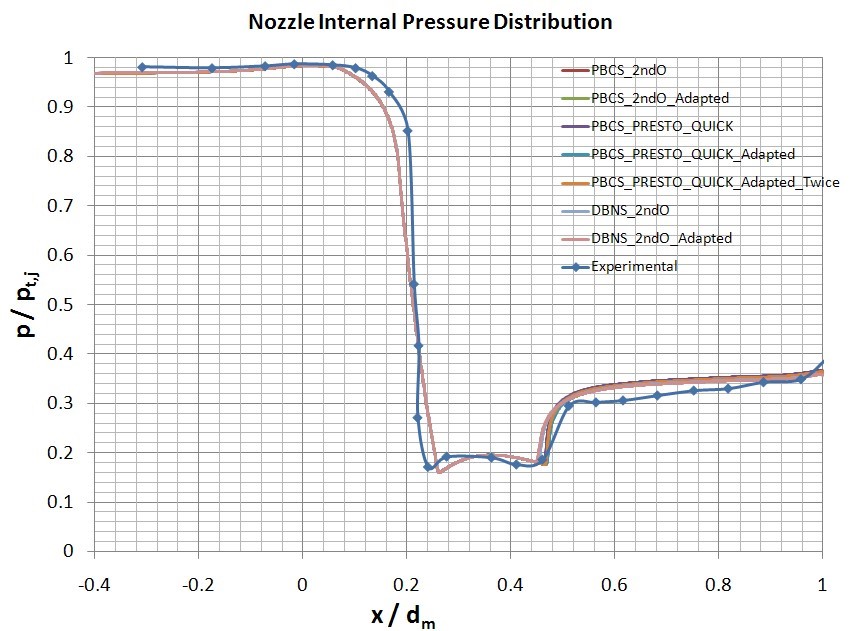

I successfully represented the model with the Pressure-based solver both for 2nd order and PRESTO/QUICK as you can see below:

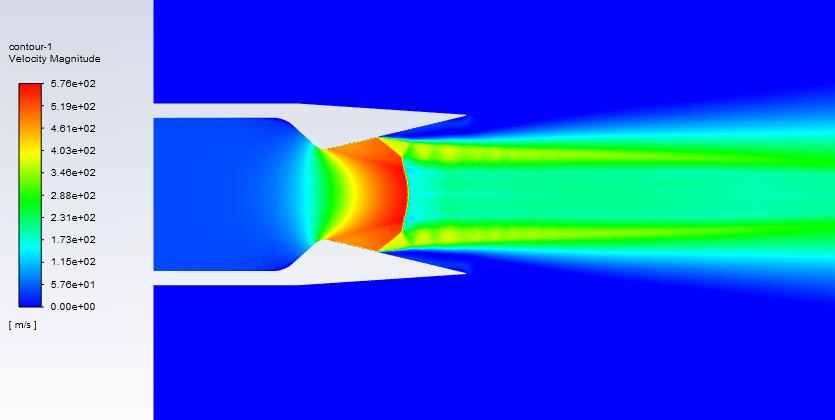

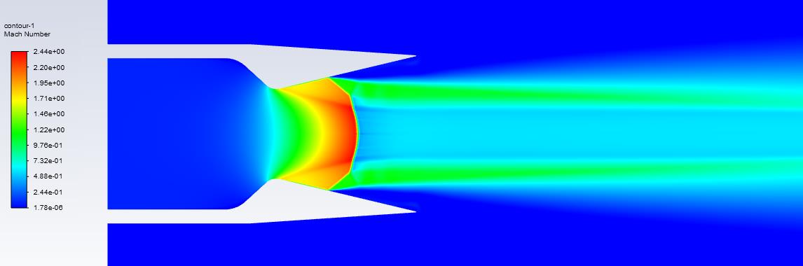

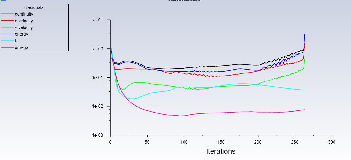

But as soon as I move to the Density based solver, I get a diverging solution, even if I change the Hybrid initialization to the Standard initialization. It always starts pretty well but diverges after around 250 iterations, when the mach disk appears. As you can see on these pictures (I stopped the simulation right before the divergence):
I tried to change settings such as turbulent model (going from k-omega to k-epsilon etc.) and also inlet pressure, pseudo transient on/off... but it always diverges. I have the same problem on other projects but here, I don't understand why I have good results with Pressure based solver and not with Density based solver.
At first, I thought it was related to Mesh quality but I tried on an other project (with good results on density based solver) to move from a good mesh (with a converged solution) to coarse mesh, and the solution still converges. I think the problem is related to the shocks, but I can't verify it.
Have you any thoughts about from where does the problem comes from?

When you using the Density based approach, can you try running it with AUSM as the flux type?Â
RahulÂ
April 21, 2020 at 11:13 am
killian153
SubscriberHello Rahkumar,
I already tried to run it with AUSM, nothing worked. But yesterday I found the solution (which is very simple): when I was moving from PBCS to DBNS, Fluent changed the CFL from 1 to 5 (I don't know why) and I didn't noticed, since it was previously set to 1.
I ran the simulation with CFL=1, Implicit and AUSM and here are the results:

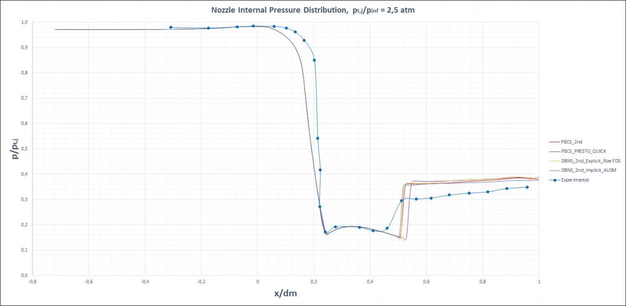

But do you know why I get steeper curves than the paper when talking about the pressure coefficient near the nozzle wall? Is it related to my mesh?
My results:
Their results:
April 21, 2020 at 9:19 pm
Rahul Kumar
Ansys EmployeeGlad you got it sorted out.Â
Yes, it could be because of your mesh and also, reduce the CFL number further and try with the simulation.Â
