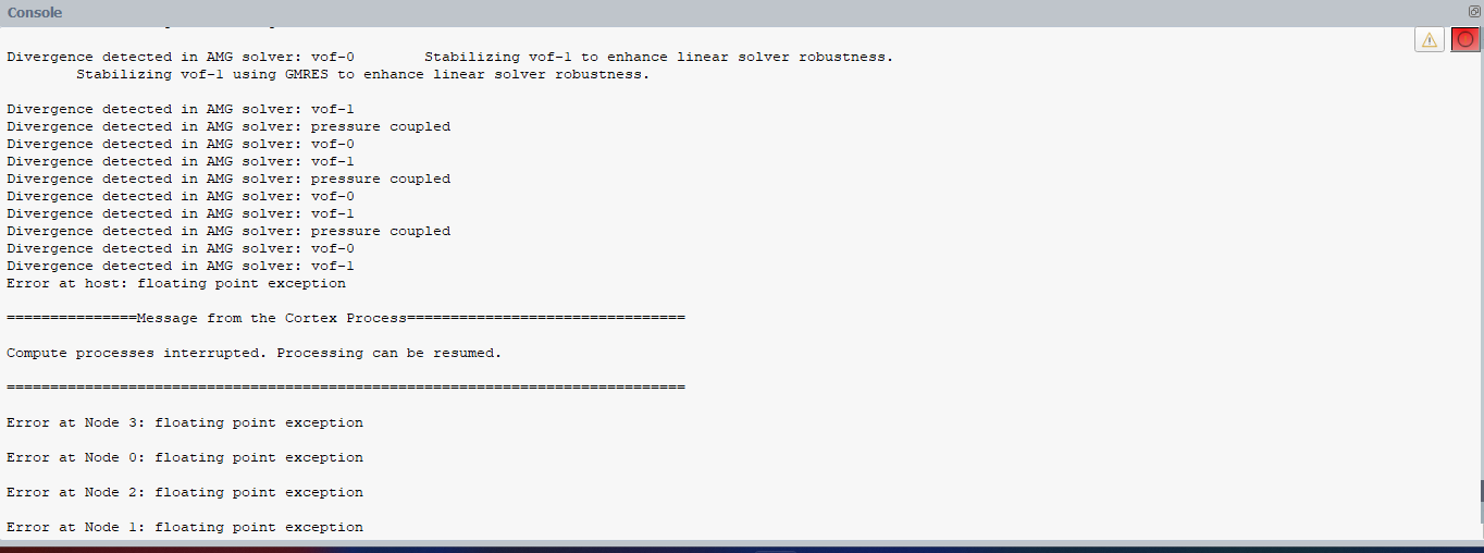

      Hi. I am trying to simulate the G-L reactive flow in ANSYS Fluent. As a first approach I have considered H2O+O2 (L) and air (G).
      I am modeling a falling film flow (where the microchannel is situated at 35 degree from the horizontal position)
      I have selected the Mixture Multiphase model. I have set the O2 mass transfer from G to L (Henry's law).
      When the  Surface Tension Force Modeling  >>Continuum Surface Force is enabled, I have Floating point exception and divergence problems.
      I have modified the convergence criteria, the under relaxation factor, however unfortunately the problem is still unsolved.
      Can you please offer me some hints why this divergence issue occured?
      Thank you in advance!
    • Nikhil N
      Can you share the screenshot of the divergence message that you are getting in the console window?

    • Biborka Boga
    • Biborka Boga

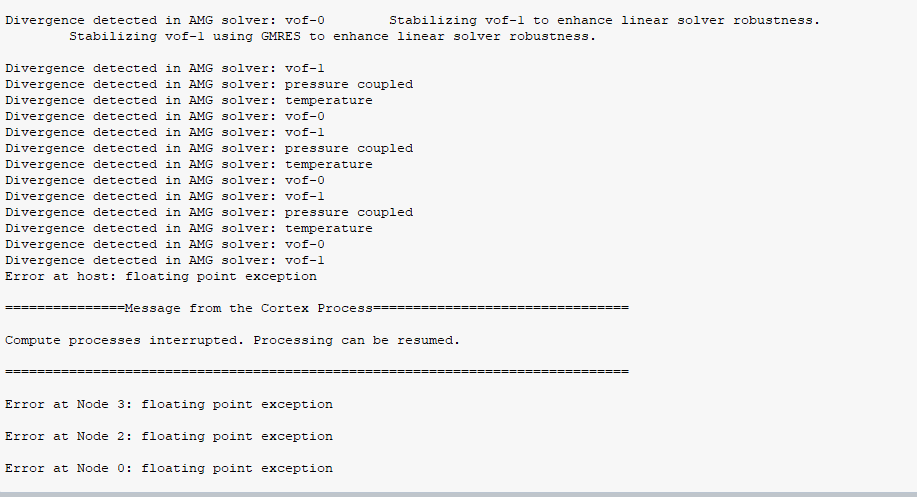

      First of all thank you very much your quick response. This divergence appears almost imediately after starting the simulation. I have also decreased the time step (1e-5), the Courant number and the under relaxation factors as it was suggested in the Ansys' Guide.
      Furthermore, I have performed the simulation by disabling the surface tension force modeling. In this case no divergence issues appeared until a certain point, however afterwards the same error has appeared. Please find below. Thank you in advance your suggestion/help.

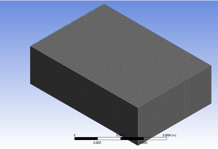

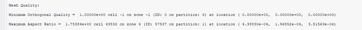

      I suggest to please check your mesh (Please share screenshot of mesh) and share the mesh quality details too. Usually this error occurs when the mesh have small elements in contact with others bigger. The transitions of the elements must be soft to avoid instability in continuity and momentum balance equations.
      Thank you
      Saurabh
      • Biborka Boga
        Hi! Thank you very much your response and suggestion!
        Please find bellow the mesh and the details. I am trying to simulate a portion of microchannel (just as  information for the length scale)

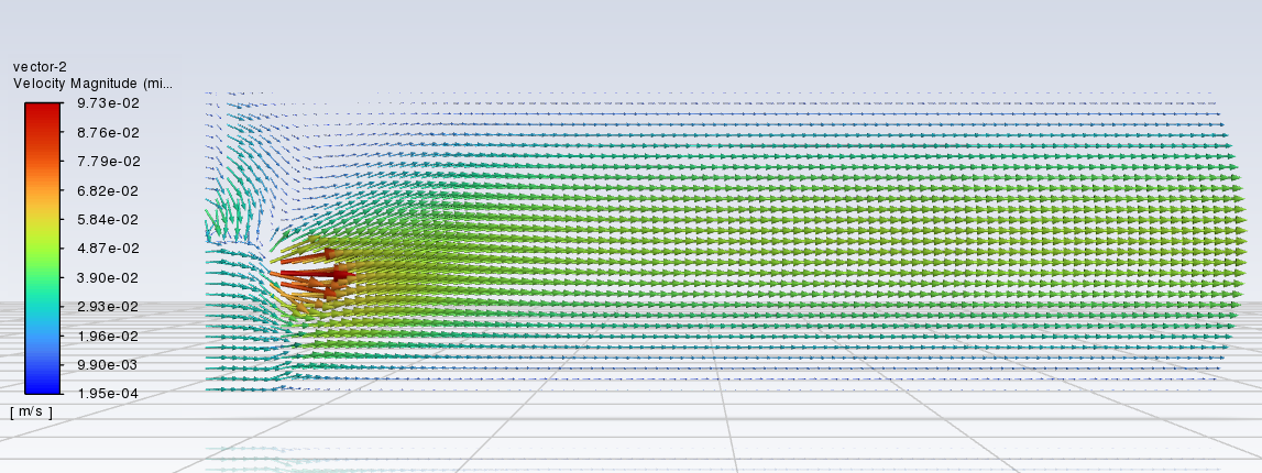

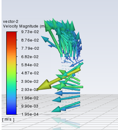

      How does the velocity look? You might need to patch in some liquid to help the solver in the boundary region.
    • Biborka Boga
      Thanks for your reply. Can you please let me know: should I perfrom the patching of the lq in the boundary region? Thank you in advance your response!
      Please find below the velocity along the symmetry plane.
      Velocity magnitude (phase 1) - air
      Velocity magnitude - phase 2 (water). This I can't really interprete...
      Velocity magnitude (mixture)
      P.S. The velocity of the gas phase and liquid film was set to be equal (0.0294 m/s)
      That looks like the surface tension is causing an acceleration. With Mixture that could get interesting. Why not VOF?
