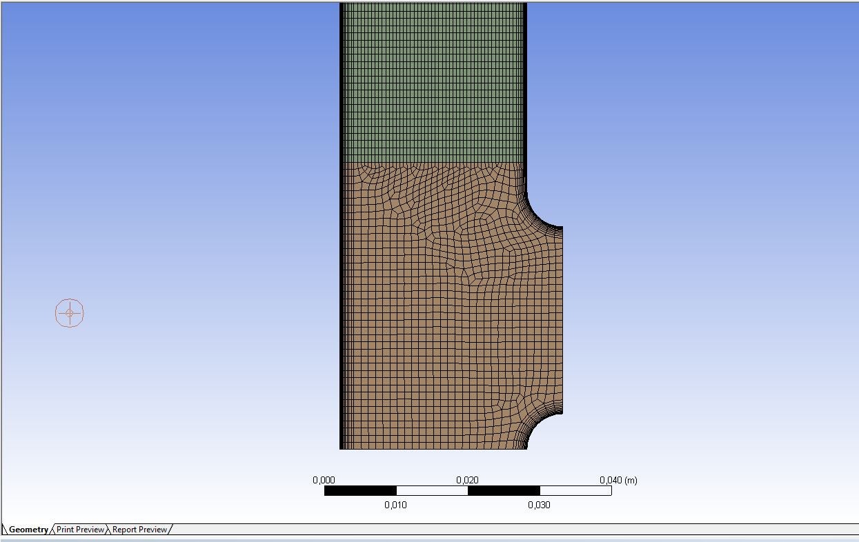

      Hi guys. I'm simulating air-water flow through a T pipe with 26mm inner diameter. The pipe was created in a 2D domain, there are two inlets (one for air and the other for water) and one outlet. The two inlets have velocity inlet conditions and the outlet has pressure outlet conditions. The pipe is filled with water and then water and air start to flow from the inlets with their respective inlet velocities. The time-step was calculated based on the CFL condition and the total flow time is 6 seconds. The simulation is presenting the following problems after the bubbles reach the outlet (which occurred approximately in 2,3 seconds):

      I checked the mesh quality and it looks good (min orthogonal quality = 0.73; max skewness = 0.53; max aspect ratio = 21.16). I tried to solve the problem by reducing the time step in half and decreasing the relaxation factors, but it didn't work. I don't know how to fix this problem, so I really need some help and I'm open to answering any questions. I'm going to list every piece of information I find relevant about the simulation.
      General:
      Parallel
      Solver type: Pressure-Based
      Time: Transient
      Planar 2D space
      Gravity on
      Models:
      Multiphase VOF with explicit formulation and Surface Tension Force Modeling (CSF)
      Default Courant number: 0,25
      Implicit Body Force
      Turbulence Model: SST k-omega
      Cell Zone Conditions:
      Specified Operating Density: 1.225 kg/m³ (air density)
      Boundary conditions:
      air inlet velocity = 0.936 m/s
      water inlet velocity = 0.37
      m/s
      outlet Gauge Pressure (pascal) = 0
      pipe wall: stationary, no slip
      Solution Methods:
      PISO Scheme
      Least Squares Cell Based Gradient
      PRESTO! Pressure
      volume fraction: Geo-Reconstruct
      Momentum, Turbulent Kinetic Energy and Specific Dissipation Rate = Second order upwind
      Transient Formulation = First order implicit
      Solution Controls: Default
      Residuals = 10e-5
      Standard initialization with default initial values

      I assume you have patched the volume before start of iterations.
      Please make sure that you reduce your timestep as 6 sec looks too large.
      Please search through forum and you will find many posts on VOF.
      Regards Keyur
    • Anakin
      Thank for your reply What do you mean by "patched the volume"? I think i did it, just want to be sure that we are talking about the same thing.
      The total flow time i'm going for is 6 sec, not my time step.
      Regards Anakin.
