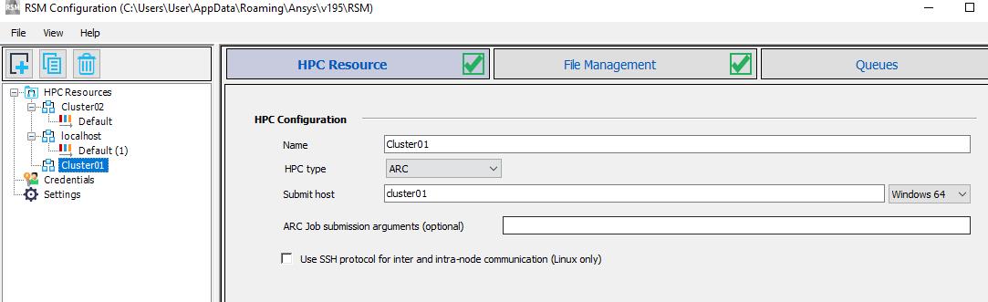

    • kolyan007

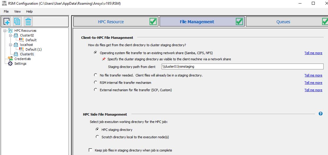

      Thanks for your reply. I was thinking there is some incompatibility between my 3 machine cluster and R2, so I did reinstall OS on master machine (maincad) that using to send tasks to slaves in cluster, install R3 on it and install R3 on slaves, then replicate settings.
      I don't have my own scheduler. All machines connecting to each other.
      There are a screenshots with my config below.

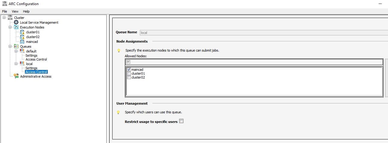

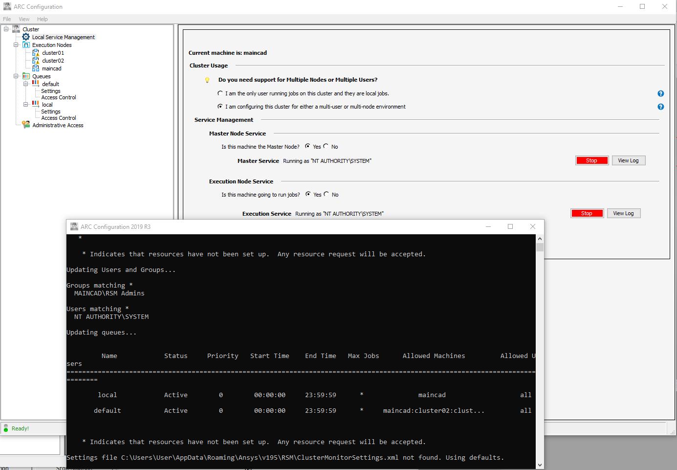

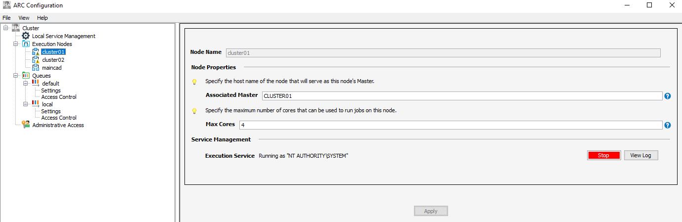

      ARC configuration on master
      ARC configuration on masterARC configuration on masterARC configuration on master
      Note: I'm not sure why, but Service Management running by cluster02user. Not sure how to change to default.

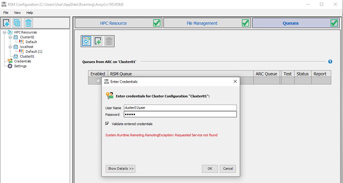

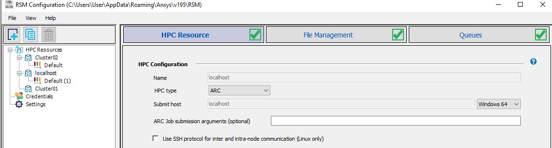

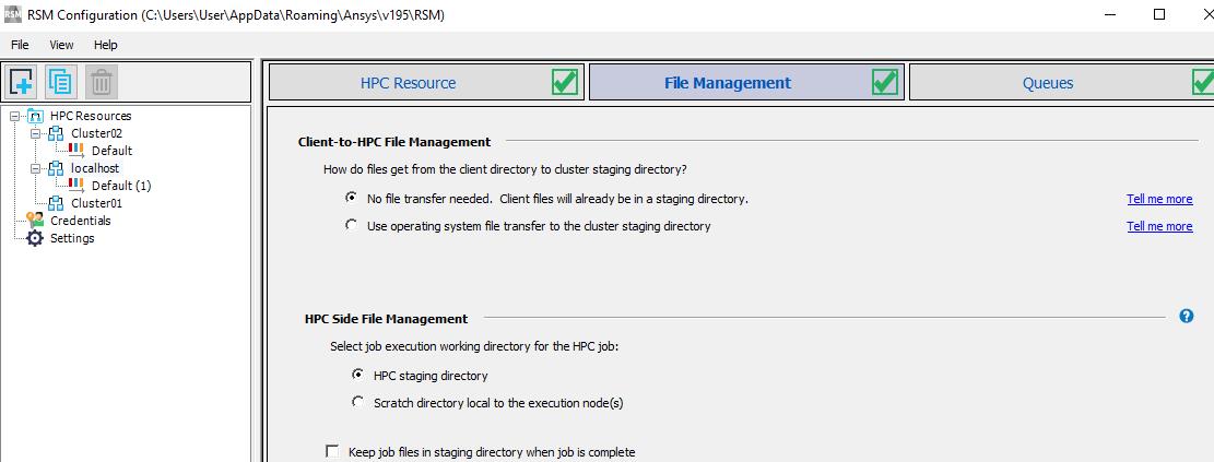

      RSM config on master:
      RSM configuration on master
      RSM configuration on masterRSM configuration on master

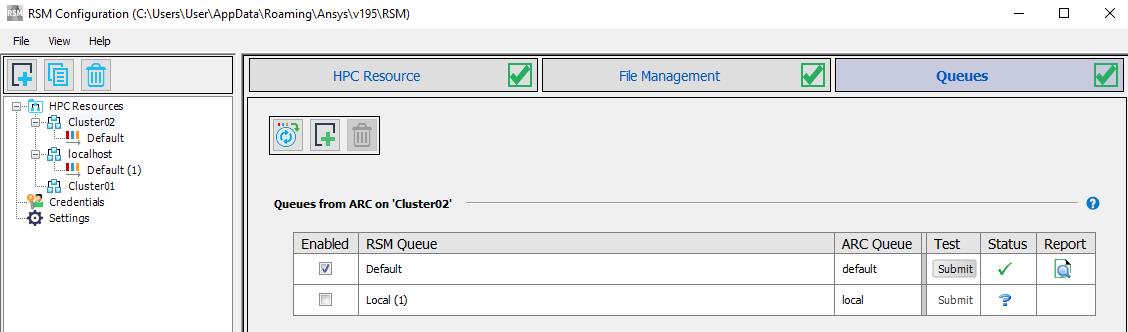

      Somehow Queues refresh fails.
      This is after I deleted credentials for cluster01

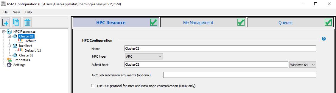

      RSM config for cluster02
      And RSM config for localhost

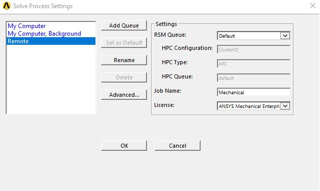

      My Solve Process settings:
      Solve settings
      Solve in mechanical

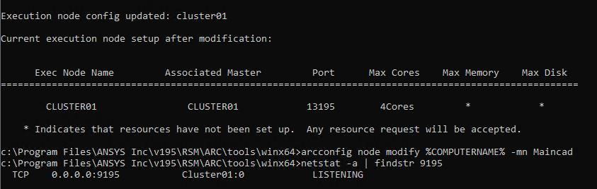

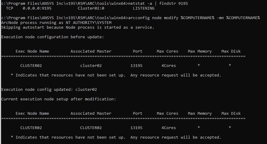

      Also I've tested telnet to port 9195 and SMB in Windows, there is no issues from OS perspective. All machines using same credentials.
      Additionally I've found that if I run: arcconfig node modify %COMPUTERNAME% -mn maincad                  so test in RSM will go in schedule mode, but if I replace my master node with %COMPUTERNAME%, a test will go through fine. What options is correct?
      Cluster01 port 9195 listening
      Cluster02 port 9195 listening

      Hi Nick,
      There seems to be a number of different issues to look at here.
      First, please uninstall the ARC Master and RSM Launcher services from the two machines that are NOT the head node.
      You can do this from the command line by doing the following:
      Start -> Type cmd -> Right click on Command Prompt and select Run As administrator
      At the prompt type:
      cd /d "c:program filesansys incv195RSMbin"
      ansunconfigrsm -launcher
      cd /d "c:program filesansys incv195RSMARCtoolswinx64"
      uninstallservice -arcmaster
      This should leave the ARC Node service running on MainCad,Cluster01,Cluster02
      This should leave the ARC Master and Launcher service running on MainCad only.
      Once that is done, go to MainCad and run the admin command prompt as state above, then type:
      cd /c "c:program filesansys incv195RSMARCtoolswinx64"
      arcnodes
      arcqueues
      Then please paste a screenshot of that.

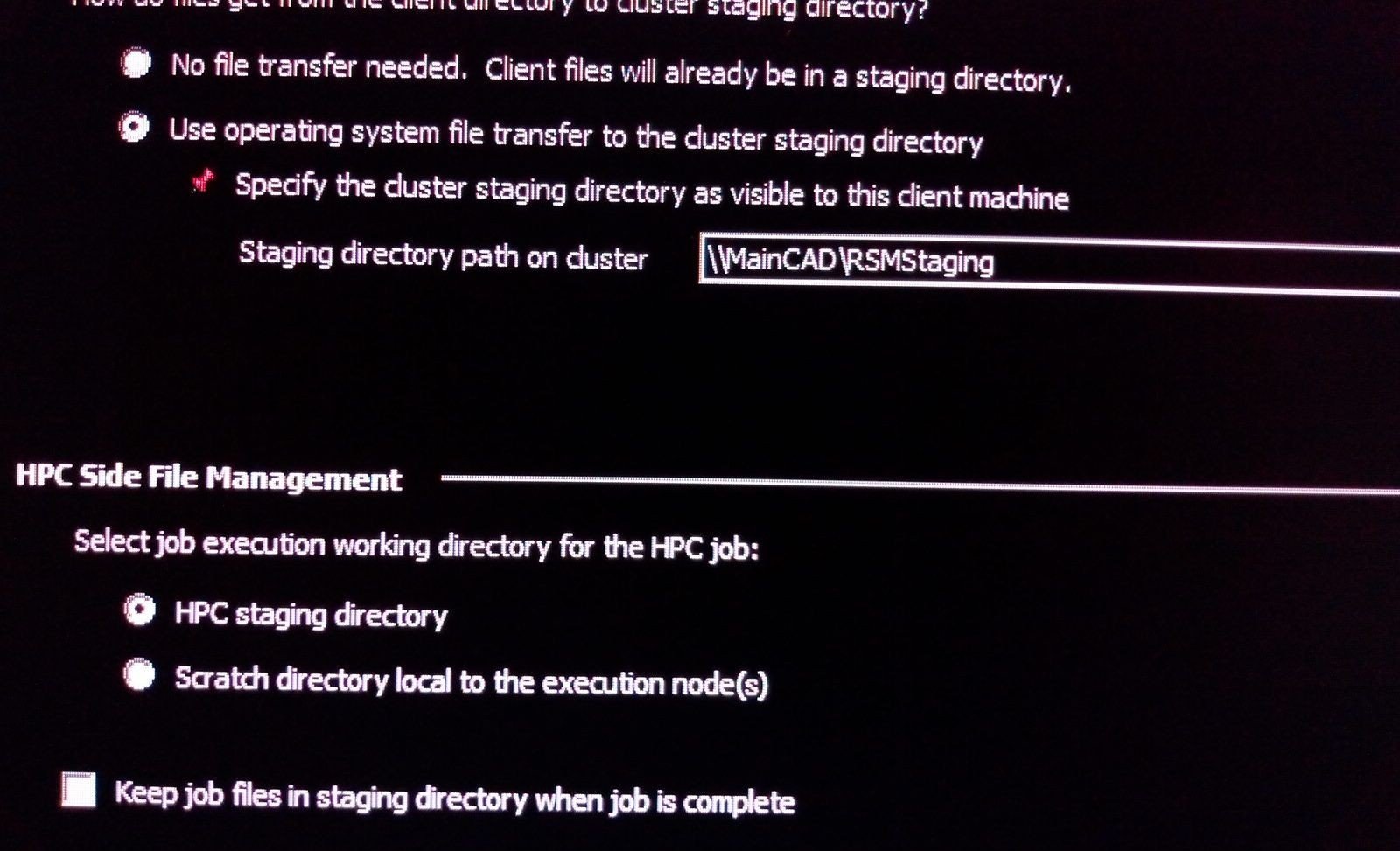

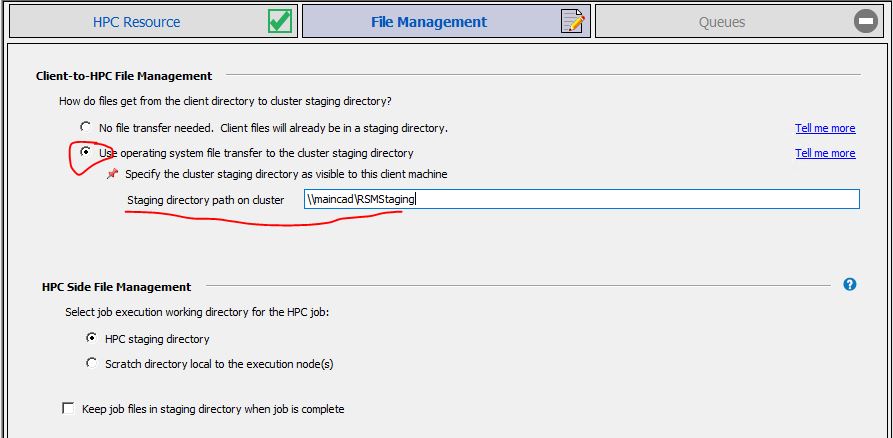

      On client machines. Note All info here is the same on any client machine. The Submit Host is the dedicated node above. Do not use local machine information.
      Launch RSM Configuration GUI
      Once you are in the GUI, click the plus sign on the top left then fill out name or its IP address of the Submit Host machine and OS.
      Once, this is done, click “Apply”
      Go to “File Management” tab , Select "Operating System File Transfer" , Put in the share path to the RSMStaging directory you shared earlier (again, this is the same UNC path that you setup to share above, do not use local machine information)
      Then, Go to “Queues” tab , click “Import/Refresh Cluster Queues” , then specify your login username and password. This will bring up all the queues. You can enable and disable any queue that you like.
      Then make sure that port 9195 is open between the client and the ‘submit host’ machines.

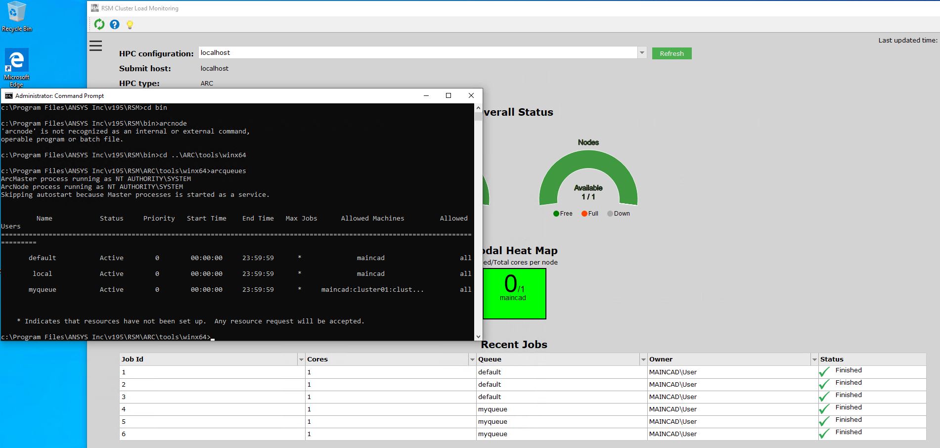

      Just checked RSM Cluster Load Monitoring on HEAD node, it shows only 1 node, not 3. I've manually created another queue and added another nodes to it, but it doesn't help.
      My queues and RSM Cluster output on HEAD node is below:

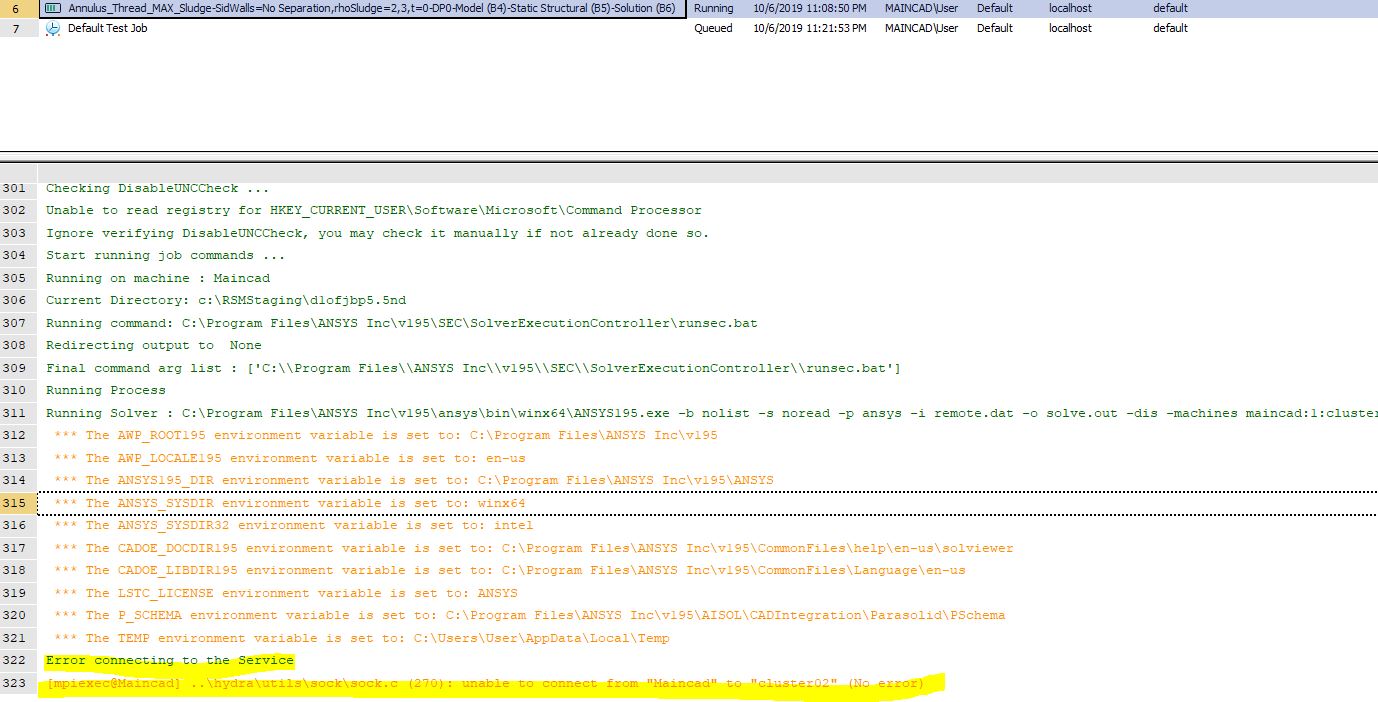

    • kolyan007
      Followed ANSYS RSM user guide to finalize my cluster setup.
      Got 3 nodes under RSM Cluster Monitoring and tests were fine, but there is an error when I tried to solve my project. Maincad is my Submit Host+solver, Cluster02 is only solver. Please advise what could be wrong?
    • JakeC
      Looks like something is blocking the IntelMPI processes.
      Firewall / User Account Control / Antivirus / etc...
      You could try IBM MPI instead.
      First make sure IBM/Platform MPI is installed on all machines.
      Then In Mechanical go to Solve Process Settings -> Select your config -> Advanced
      In the Additional Command Line Arguments add:
      -mpi ibmmpi
      Then try it again.

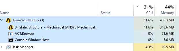

      If you open up Task Manager on solving machines do you see any ANSYS.exe or ANSYS195.exe ?
    • kolyan007
      Only Submit host has some activity with ANSYS, solvers don't show it. Weird.
      This screenshot from Submit host:

      Start running job commands ...
      Running on machine : Maincad
      Current Directory: C:RSMStagingaokqqj0p.5k1
      Running command: C:Program FilesANSYS Incv195SECSolverExecutionControllerrunsec.bat
      Redirecting output to  None
      Final command arg list :
      Running Process
      Running Solver : C:Program FilesANSYS Incv195ansysbinwinx64ANSYS195.exe -b nolist -s noread -acc nvidia -na 1 -p ansys -mpi intelmpi -i remote.dat -o solve.out -dis -machines maincad:4:cluster01:4:cluster02:4 -dir "CRSMStaging/aokqqj0p.5k1"
       *** The AWP_ROOT195 environment variable is set to: C:Program FilesANSYS Incv195
       *** The AWP_LOCALE195 environment variable is set to: en-us
       *** The ANSYS195_DIR environment variable is set to: C:Program FilesANSYS Incv195ANSYS
       *** The ANSYS_SYSDIR environment variable is set to: winx64
       *** The ANSYS_SYSDIR32 environment variable is set to: intel
       *** The CADOE_DOCDIR195 environment variable is set to: C:Program FilesANSYS Incv195CommonFileshelpen-ussolviewer
       *** The CADOE_LIBDIR195 environment variable is set to: C:Program FilesANSYS Incv195CommonFilesLanguageen-us
       *** The LSTC_LICENSE environment variable is set to: ANSYS
       *** The P_SCHEMA environment variable is set to: C:Program FilesANSYS Incv195AISOLCADIntegrationParasolidPSchema
       *** The TEMP environment variable is set to: C:UsersUserAppDataLocalTemp
       *** FATAL ***
        Invalid working directory value= CRSMStaging/aokqqj0p.5k1
        (specified working directory does not exist)
       *** NOTE ***
        USAGE: C:Program FilesANSYS Incv195ANSYSbinwinx64ANSYS.EXE
                           [-d device name] [-j job name]
                           [-b list|nolist] [-m scratch memory(mb)]
                           [-s read|noread] [-g] [-db database(mb)]
                           [-p product] [-l language]
                           [-dyn] [-np #] [-mfm]
                           [-dvt] [-dis] [-machines list]
                           [-i inputfile] [-o outputfile]
                           [-ser port] [-scport port]
                           [-scname couplingname] [-schost hostname]
                           [-smp] [-mpi intelmpi|ibmmpi|msmpi]
                           [-dir working_directory ]
       *** FATAL ***
       *** NOTE ***
                           [-acc nvidia] [-na #]
       *** FATAL ***
       *** NOTE ***
       *** FATAL ***
       *** NOTE ***
       *** FATAL ***
       *** NOTE ***
       *** FATAL ***
       *** NOTE ***
       *** FATAL ***
       *** NOTE ***

    • JakeC
      If you are trying to distribute across multiple machines your staging directory can't be a local drive "c:"
      You will need to share that directory and in the staging directory setting use the unc path to that shared directory eg:
      \maincadRSMStaging
      Please be sure to set the RSMStaging share security to be open to all users and machines.
      Thank you,
      Jake
    • kolyan007
      That shared folder exists on maincad and has full access to everyone.
      >If you are trying to distribute across multiple machines your staging directory can't be a local drive "c:" - Does it applies to Submit Host as well? I.e. on Submit host in RSM configuration do I need to use OS file transfer and put UNC path to shared folder \maincadRSMStaging? Like below:
      Remote solvers already using it.
    • kolyan007
      The localhost HPC Resource has been changed to use operating system file transfer to the cluster staging directory, as on the screenshot above, to use UNC folder: \maincadRSMStaging.
      Solve process has failed with the error message below:
      1
      11/10/2019 1:580 pm
      RSM Version: 19.5.420.0, Build Date: 30/07/2019 57:06 am

      JakeC
      For this log it appears as though running CMD from a UNC path is blocked.
      To unblock it please do the following on each machine:
      Start a registry editor (e.g., regedit.exe).
      Navigate to theHKEY_LOCAL_MACHINESOFTWAREMicrosoftCommand Processor registry subkey.
      From the Edit menu, select New, DWORD Value; enter the name DisableUNCCheck; then press Enter.
      Double-click the new value, set it to 1, then click OK.
      Close the registry editor.
      Reboot the machine
      Thank you,
      Jake
    • kolyan007
      Thank you Jake. The UNC has been disabled on all machines using steps above.
      See below my RSM configuration settings for localhost on Submit Host and most recent error log. Please advise what else is wrong in my configuration.

      68     13/10/2019 12:01:15 am     Behavior code: Ansys.Rsm.ClusterOperations.Behaviors.MechanicalAnsysBehaviors
      69     13/10/2019 12:01:15 am     Loading Cluster Customization file C:Program FilesANSYS Incv195RSMConfigxmlClusterJobCustomization.xml.
      70     13/10/2019 12:01:15 am     No customization found for cluster machineName Maincad, type ARC
      71     13/10/2019 12:01:15 am     HPC Commands Files Used:
      72     13/10/2019 12:01:15 am        hpc_commands_ARC.xml
      73     13/10/2019 12:01:15 am     Environment variables:
      74     13/10/2019 12:01:15 am        RSM_PYTHON_HOME=C:Program FilesANSYS Incv195commonfilesCPython2_7_15winx64Releasepython
      75     13/10/2019 12:01:15 am        RSM_IRON_PYTHON_HOME=C:Program FilesANSYS Incv195commonfilesIronPython
      76     13/10/2019 12:01:15 am        RSM_PYTHON_EXE=C:Program FilesANSYS Incv195commonfilesCPython2_7_15winx64Releasepythonpython.exe
      77     13/10/2019 12:01:15 am        RSM_TASK_WORKING_DIRECTORY=\MainCADRSMStagingeubgp21n.ezb
      78     13/10/2019 12:01:15 am        RSM_USE_SSH_LINUX=False
      79     13/10/2019 12:01:15 am        RSM_QUEUE_NAME=default
      80     13/10/2019 12:01:15 am        RSM_CONFIGUREDQUEUE_NAME=Default
      81     13/10/2019 12:01:15 am        RSM_COMPUTE_SERVER_MACHINE_NAME=Maincad
      82     13/10/2019 12:01:15 am        RSM_HPC_JOBNAME=Mechanical
      83     13/10/2019 12:01:15 am        RSM_HPC_DISPLAYNAME=Annulus_Thread_MAX_Sludge-SidWalls=No Separation,rhoSludge=2,3,t=0-DP0-Model (B4)-Static Structural (B5)-Solution (B6)
      84     13/10/2019 12:01:15 am        RSM_HPC_CORES=12
      85     13/10/2019 12:01:15 am        RSM_HPC_DISTRIBUTED=TRUE
      86     13/10/2019 12:01:15 am        RSM_HPC_NODE_EXCLUSIVE=FALSE
      87     13/10/2019 12:01:15 am        RSM_HPC_QUEUE=default
      88     13/10/2019 12:01:15 am        RSM_HPC_USER=MAINCADUser
      89     13/10/2019 12:01:15 am        RSM_HPC_WORKDIR=\MainCADRSMStagingeubgp21n.ezb
      90     13/10/2019 12:01:15 am        RSM_HPC_JOBTYPE=Mechanical_ANSYS
      91     13/10/2019 12:01:15 am        RSM_HPC_ANSYS_LOCAL_INSTALL_DIRECTORY=C:Program FilesANSYS Incv195
      92     13/10/2019 12:01:15 am        RSM_HPC_VERSION=195
      93     13/10/2019 12:01:15 am        RSM_HPC_STAGING=\MainCADRSMStagingeubgp21n.ezb
      94     13/10/2019 12:01:15 am        RSM_HPC_LOCAL_PLATFORM=Windows
      95     13/10/2019 12:01:15 am        RSM_HPC_CLUSTER_TARGET_PLATFORM=Windows
      96     13/10/2019 12:01:15 am        RSM_HPC_STDOUTFILE=stdout_9f9da426-822a-4234-a55a-2a8fc2bef7c8.rsmout
      97     13/10/2019 12:01:15 am        RSM_HPC_STDERRFILE=stderr_9f9da426-822a-4234-a55a-2a8fc2bef7c8.rsmout
      98     13/10/2019 12:01:15 am        RSM_HPC_STDOUTLIVE=stdout_9f9da426-822a-4234-a55a-2a8fc2bef7c8.live
      99     13/10/2019 12:01:15 am        RSM_HPC_STDERRLIVE=stderr_9f9da426-822a-4234-a55a-2a8fc2bef7c8.live
      100     13/10/2019 12:01:15 am        RSM_HPC_SCRIPTS_DIRECTORY_LOCAL=C:Program FilesANSYS Incv195RSMConfigscripts
      101     13/10/2019 12:01:15 am        RSM_HPC_SCRIPTS_DIRECTORY=%AWP_ROOT195%RSMConfigscripts
      102     13/10/2019 12:01:15 am        RSM_HPC_SUBMITHOST=localhost
      103     13/10/2019 12:01:15 am        RSM_HPC_STORAGEID=    2e240152-9c98-4c8b-b806-5ccbbda6db14    Mechanical=LocalOS#localhost$\MainCADRSMStagingeubgp21n.ezb    Saturday, October 12, 2019 11:01:15.288 AM    True
      104     13/10/2019 12:01:15 am        RSM_HPC_PLATFORMSTORAGEID=\MainCADRSMStagingeubgp21n.ezb
      105     13/10/2019 12:01:15 am        RSM_HPC_NATIVEOPTIONS=
      106     13/10/2019 12:01:15 am        ARC_ROOT=C:Program FilesANSYS Incv195RSMConfigscripts....ARC
      107     13/10/2019 12:01:15 am        RSM_HPC_KEYWORD=ARC
      108     13/10/2019 12:01:15 am     JobType is: Mechanical_ANSYS
      109     13/10/2019 12:01:15 am     Final command platform: Windows
      110     13/10/2019 12:01:15 am     RSM_PYTHON_HOME=C:Program FilesANSYS Incv195commonfilesCPython2_7_15winx64Releasepython
      111     13/10/2019 12:01:15 am     RSM_HPC_JOBNAME=Mechanical
      112     13/10/2019 12:01:15 am     Distributed mode requested: True
      113     13/10/2019 12:01:15 am     RSM_HPC_DISTRIBUTED=TRUE
      114     13/10/2019 12:01:15 am     Running 1 commands
      115     13/10/2019 12:01:15 am     Job working directory: \MainCADRSMStagingeubgp21n.ezb
      116     13/10/2019 12:01:15 am     Number of CPU requested: 12
      117     13/10/2019 12:01:15 am     AWP_ROOT195=C:Program FilesANSYS Incv195
      118     13/10/2019 12:01:15 am     Checking queue default exists ...
      119     13/10/2019 12:01:15 am     External cluster command: queryQueues
      120     13/10/2019 12:01:15 am        Cluster command before expansion: %ARC_ROOT%binArcQueues.exe
      121     13/10/2019 12:01:15 am        Final cluster command: C:Program FilesANSYS Incv195RSMConfigscripts....ARCbinArcQueues.exe
      122     13/10/2019 12:01:15 am        Working directory : \MainCADRSMStagingeubgp21n.ezb
      123     13/10/2019 12:01:15 am        Variables:
      124     13/10/2019 12:01:15 am            RSM_PYTHON_HOME=C:Program FilesANSYS Incv195commonfilesCPython2_7_15winx64Releasepython
      125     13/10/2019 12:01:15 am            RSM_IRON_PYTHON_HOME=C:Program FilesANSYS Incv195commonfilesIronPython
      126     13/10/2019 12:01:15 am            RSM_PYTHON_EXE=C:Program FilesANSYS Incv195commonfilesCPython2_7_15winx64Releasepythonpython.exe
      127     13/10/2019 12:01:15 am            RSM_TASK_WORKING_DIRECTORY=\MainCADRSMStagingeubgp21n.ezb
      128     13/10/2019 12:01:15 am            RSM_USE_SSH_LINUX=False
      129     13/10/2019 12:01:15 am            RSM_QUEUE_NAME=default
      130     13/10/2019 12:01:15 am            RSM_CONFIGUREDQUEUE_NAME=Default
      131     13/10/2019 12:01:15 am            RSM_COMPUTE_SERVER_MACHINE_NAME=Maincad
      132     13/10/2019 12:01:15 am            RSM_HPC_JOBNAME=Mechanical
      133     13/10/2019 12:01:15 am            RSM_HPC_DISPLAYNAME=Annulus_Thread_MAX_Sludge-SidWalls=No Separation,rhoSludge=2,3,t=0-DP0-Model (B4)-Static Structural (B5)-Solution (B6)
      134     13/10/2019 12:01:15 am            RSM_HPC_CORES=12
      135     13/10/2019 12:01:15 am            RSM_HPC_DISTRIBUTED=TRUE
      136     13/10/2019 12:01:15 am            RSM_HPC_NODE_EXCLUSIVE=FALSE
      137     13/10/2019 12:01:15 am            RSM_HPC_QUEUE=default
      138     13/10/2019 12:01:15 am            RSM_HPC_USER=MAINCADUser
      139     13/10/2019 12:01:15 am            RSM_HPC_WORKDIR=\MainCADRSMStagingeubgp21n.ezb
      140     13/10/2019 12:01:15 am            RSM_HPC_JOBTYPE=Mechanical_ANSYS
      141     13/10/2019 12:01:15 am            RSM_HPC_ANSYS_LOCAL_INSTALL_DIRECTORY=C:Program FilesANSYS Incv195
      142     13/10/2019 12:01:15 am            RSM_HPC_VERSION=195
      143     13/10/2019 12:01:15 am            RSM_HPC_STAGING=\MainCADRSMStagingeubgp21n.ezb
      144     13/10/2019 12:01:15 am            RSM_HPC_LOCAL_PLATFORM=Windows
      145     13/10/2019 12:01:15 am            RSM_HPC_CLUSTER_TARGET_PLATFORM=Windows
      146     13/10/2019 12:01:15 am            RSM_HPC_STDOUTFILE=stdout_9f9da426-822a-4234-a55a-2a8fc2bef7c8.rsmout
      147     13/10/2019 12:01:15 am            RSM_HPC_STDERRFILE=stderr_9f9da426-822a-4234-a55a-2a8fc2bef7c8.rsmout
      148     13/10/2019 12:01:15 am            RSM_HPC_STDOUTLIVE=stdout_9f9da426-822a-4234-a55a-2a8fc2bef7c8.live
      149     13/10/2019 12:01:15 am            RSM_HPC_STDERRLIVE=stderr_9f9da426-822a-4234-a55a-2a8fc2bef7c8.live
      150     13/10/2019 12:01:15 am            RSM_HPC_SCRIPTS_DIRECTORY_LOCAL=C:Program FilesANSYS Incv195RSMConfigscripts
      151     13/10/2019 12:01:15 am            RSM_HPC_SCRIPTS_DIRECTORY=%AWP_ROOT195%RSMConfigscripts
      152     13/10/2019 12:01:15 am            RSM_HPC_SUBMITHOST=localhost
      153     13/10/2019 12:01:15 am            RSM_HPC_STORAGEID=    2e240152-9c98-4c8b-b806-5ccbbda6db14    Mechanical=LocalOS#localhost$\MainCADRSMStagingeubgp21n.ezb    Saturday, October 12, 2019 11:01:15.288 AM    True
      154     13/10/2019 12:01:15 am            RSM_HPC_PLATFORMSTORAGEID=\MainCADRSMStagingeubgp21n.ezb
      155     13/10/2019 12:01:15 am            RSM_HPC_NATIVEOPTIONS=
      156     13/10/2019 12:01:15 am            ARC_ROOT=C:Program FilesANSYS Incv195RSMConfigscripts....ARC
      157     13/10/2019 12:01:15 am            RSM_HPC_KEYWORD=ARC
      158     13/10/2019 12:01:15 am            RSM_HPC_PARSE_MARKER=START
      159     13/10/2019 12:01:15 am
      160     13/10/2019 12:01:16 am     ArcMaster process running as NT AUTHORITYSYSTEM
      161     13/10/2019 12:01:16 am     ArcNode process running as NT AUTHORITYSYSTEM
      162     13/10/2019 12:01:16 am     Skipping autostart because Master processes is started as a service.
      163     13/10/2019 12:01:16 am             Name            Status     Priority   Start Time    End Time   Max Jobs      Allowed Machines         Allowed Users
      164     13/10/2019 12:01:16 am     ================================================================================================================================
      165     13/10/2019 12:01:16 am           default           Active        0        00:00:00     23:59:59      *     maincad:cluster01:clust...         all
      166     13/10/2019 12:01:16 am            local            Active        0        00:00:00     23:59:59      *              maincad                   all
      167     13/10/2019 12:01:16 am        * Indicates that resources have not been set up.  Any resource request will be accepted.
      168     13/10/2019 12:01:16 am     External cluster command: checkQueueExists
      169     13/10/2019 12:01:16 am        Cluster command before expansion: %RSM_PYTHON_EXE% -B -E "%RSM_HPC_SCRIPTS_DIRECTORY_LOCAL%/arcParsing.py" -queues %RSM_HPC_PARSE_MARKER%
      170     13/10/2019 12:01:16 am        Final cluster command: C:Program FilesANSYS Incv195commonfilesCPython2_7_15winx64Releasepythonpython.exe -B -E "C:Program FilesANSYS Incv195RSMConfigscripts/arcParsing.py" -queues START
      171     13/10/2019 12:01:16 am        Working directory : \MainCADRSMStagingeubgp21n.ezb
      172     13/10/2019 12:01:16 am        Variables:
      173     13/10/2019 12:01:16 am            RSM_PYTHON_HOME=C:Program FilesANSYS Incv195commonfilesCPython2_7_15winx64Releasepython
      174     13/10/2019 12:01:16 am            RSM_IRON_PYTHON_HOME=C:Program FilesANSYS Incv195commonfilesIronPython
      175     13/10/2019 12:01:16 am            RSM_PYTHON_EXE=C:Program FilesANSYS Incv195commonfilesCPython2_7_15winx64Releasepythonpython.exe
      176     13/10/2019 12:01:16 am            RSM_TASK_WORKING_DIRECTORY=\MainCADRSMStagingeubgp21n.ezb
      177     13/10/2019 12:01:16 am            RSM_USE_SSH_LINUX=False
      178     13/10/2019 12:01:16 am            RSM_QUEUE_NAME=default
      179     13/10/2019 12:01:16 am            RSM_CONFIGUREDQUEUE_NAME=Default
      180     13/10/2019 12:01:16 am            RSM_COMPUTE_SERVER_MACHINE_NAME=Maincad
      181     13/10/2019 12:01:16 am            RSM_HPC_JOBNAME=Mechanical
      182     13/10/2019 12:01:16 am            RSM_HPC_DISPLAYNAME=Annulus_Thread_MAX_Sludge-SidWalls=No Separation,rhoSludge=2,3,t=0-DP0-Model (B4)-Static Structural (B5)-Solution (B6)
      183     13/10/2019 12:01:16 am            RSM_HPC_CORES=12
      184     13/10/2019 12:01:16 am            RSM_HPC_DISTRIBUTED=TRUE
      185     13/10/2019 12:01:16 am            RSM_HPC_NODE_EXCLUSIVE=FALSE
      186     13/10/2019 12:01:16 am            RSM_HPC_QUEUE=default
      187     13/10/2019 12:01:16 am            RSM_HPC_USER=MAINCADUser
      188     13/10/2019 12:01:16 am            RSM_HPC_WORKDIR=\MainCADRSMStagingeubgp21n.ezb
      189     13/10/2019 12:01:16 am            RSM_HPC_JOBTYPE=Mechanical_ANSYS
      190     13/10/2019 12:01:16 am            RSM_HPC_ANSYS_LOCAL_INSTALL_DIRECTORY=C:Program FilesANSYS Incv195
      191     13/10/2019 12:01:16 am            RSM_HPC_VERSION=195
      192     13/10/2019 12:01:16 am            RSM_HPC_STAGING=\MainCADRSMStagingeubgp21n.ezb
      193     13/10/2019 12:01:16 am            RSM_HPC_LOCAL_PLATFORM=Windows
      194     13/10/2019 12:01:16 am            RSM_HPC_CLUSTER_TARGET_PLATFORM=Windows
      195     13/10/2019 12:01:16 am            RSM_HPC_STDOUTFILE=stdout_9f9da426-822a-4234-a55a-2a8fc2bef7c8.rsmout
      196     13/10/2019 12:01:16 am            RSM_HPC_STDERRFILE=stderr_9f9da426-822a-4234-a55a-2a8fc2bef7c8.rsmout
      197     13/10/2019 12:01:16 am            RSM_HPC_STDOUTLIVE=stdout_9f9da426-822a-4234-a55a-2a8fc2bef7c8.live
      198     13/10/2019 12:01:16 am            RSM_HPC_STDERRLIVE=stderr_9f9da426-822a-4234-a55a-2a8fc2bef7c8.live
      199     13/10/2019 12:01:16 am            RSM_HPC_SCRIPTS_DIRECTORY_LOCAL=C:Program FilesANSYS Incv195RSMConfigscripts
      200     13/10/2019 12:01:16 am            RSM_HPC_SCRIPTS_DIRECTORY=%AWP_ROOT195%RSMConfigscripts
      201     13/10/2019 12:01:16 am            RSM_HPC_SUBMITHOST=localhost
      202     13/10/2019 12:01:16 am            RSM_HPC_STORAGEID=    2e240152-9c98-4c8b-b806-5ccbbda6db14    Mechanical=LocalOS#localhost$\MainCADRSMStagingeubgp21n.ezb    Saturday, October 12, 2019 11:01:15.288 AM    True
      203     13/10/2019 12:01:16 am            RSM_HPC_PLATFORMSTORAGEID=\MainCADRSMStagingeubgp21n.ezb
      204     13/10/2019 12:01:16 am            RSM_HPC_NATIVEOPTIONS=
      205     13/10/2019 12:01:16 am            ARC_ROOT=C:Program FilesANSYS Incv195RSMConfigscripts....ARC
      206     13/10/2019 12:01:16 am            RSM_HPC_KEYWORD=ARC
      207     13/10/2019 12:01:16 am            RSM_HPC_PARSE_MARKER=START
      208     13/10/2019 12:01:16 am            RSM_HPC_PRIMARY_STDOUT=ArcMaster process running as NT AUTHORITYSYSTEM
      209     13/10/2019 12:01:16 am     ArcNode process running as NT AUTHORITYSYSTEM
      210     13/10/2019 12:01:16 am     Skipping autostart because Master processes is started as a service.
      211     13/10/2019 12:01:16 am             Name            Status     Priority   Start Time    End Time   Max Jobs      Allowed Machines         Allowed Users
      212     13/10/2019 12:01:16 am     ================================================================================================================================
      213     13/10/2019 12:01:16 am           default           Active        0        00:00:00     23:59:59      *     maincad:cluster01:clust...         all
      214     13/10/2019 12:01:16 am            local            Active        0        00:00:00     23:59:59      *              maincad                   all
      215     13/10/2019 12:01:16 am        * Indicates that resources have not been set up.  Any resource request will be accepted.
      216     13/10/2019 12:01:16 am            RSM_HPC_PRIMARY_STDERR=
      217     13/10/2019 12:01:16 am
      218     13/10/2019 12:01:17 am     Executing command: %AWP_ROOT195%SECSolverExecutionControllerrunsec.bat   (Ansys Solver)
      219     13/10/2019 12:01:17 am
      commands.xml file: \MainCADRSMStagingeubgp21n.ezbcommands.xml
      220     13/10/2019 12:01:17 am
      221     13/10/2019 12:01:17 am
      222     13/10/2019 12:01:17 am
      223     13/10/2019 12:01:17 am          true
      224     13/10/2019 12:01:17 am
      225     13/10/2019 12:01:17 am          12
      226     13/10/2019 12:01:17 am
      227     13/10/2019 12:01:17 am
      228     13/10/2019 12:01:17 am
      229     13/10/2019 12:01:17 am
      230     13/10/2019 12:01:17 am
      231     13/10/2019 12:01:17 am              %AWP_ROOT195%SECSolverExecutionControllerrunsec.bat
      232     13/10/2019 12:01:17 am              %AWP_ROOT195%/SEC/SolverExecutionController/runsec.sh
      233     13/10/2019 12:01:17 am
      234     13/10/2019 12:01:17 am
      235     13/10/2019 12:01:17 am
      236     13/10/2019 12:01:17 am
      237     13/10/2019 12:01:17 am
      238     13/10/2019 12:01:17 am
      commands.xml file END

      427     13/10/2019 12:01:22 am     Job is running on hostname Maincad
      428     13/10/2019 12:01:22 am     Job user from this host: User
      429     13/10/2019 12:01:22 am     Starting directory: \MainCADRSMStagingeubgp21n.ezb
      430     13/10/2019 12:01:22 am     Reading control file \MainCADRSMStagingeubgp21n.ezbcontrol_9f9da426-822a-4234-a55a-2a8fc2bef7c8.rsm ....
      431     13/10/2019 12:01:22 am     Correct Cluster verified
      432     13/10/2019 12:01:22 am     Cluster Type: ARC
      433     13/10/2019 12:01:22 am     Underlying Cluster: ARC
      434     13/10/2019 12:01:22 am        RSM_CLUSTER_TYPE = ARC
      435     13/10/2019 12:01:22 am     Compute Server is running on MAINCAD
      436     13/10/2019 12:01:22 am     Reading commands and arguments...
      437     13/10/2019 12:01:22 am        Command 1: %AWP_ROOT195%SECSolverExecutionControllerrunsec.bat, arguments: , redirectFile: None
      438     13/10/2019 12:01:22 am     Running from shared staging directory ...
      439     13/10/2019 12:01:22 am        RSM_USE_LOCAL_SCRATCH = False
      440     13/10/2019 12:01:22 am        RSM_LOCAL_SCRATCH_DIRECTORY =
      441     13/10/2019 12:01:22 am        RSM_LOCAL_SCRATCH_PARTIAL_UNC_PATH =
      442     13/10/2019 12:01:22 am     Cluster Shared Directory: \MainCADRSMStagingeubgp21n.ezb
      443     13/10/2019 12:01:22 am        RSM_SHARE_STAGING_DIRECTORY = \MainCADRSMStagingeubgp21n.ezb
      444     13/10/2019 12:01:22 am     Job file clean up: True
      445   &nb
    • JakeC
      Please go to the staging directory from the command line on maincad (using the local path/drive letter) and run the following from the command line:
       C:Program FilesANSYS Incv195ansysbinwinx64ANSYS195.exe -b nolist -s noread -p ansys -mpi intelmpi -i remote.dat -o solve.out -dis -machines maincad:4:cluster01:4:cluster02:4 -dir "//MainCAD/RSMStaging/eubgp21n.ezb"
      Please send a screenshot of the output.
      Also make sure that IntelMPI is installed on all machines, and that you have cached the IntelMPI password on each machine.
      Are these machines on domain? (It doesn't look like it from the log)
      You could also try IBM MPI instead of IntelMPI (that won't require a password to be cached)
      To do that, go into the Mechanical Solve Process Settings, select the setting you are using to submit the job with, click Advanced...
      In "Additional Command line arguments" enter:
      -mpi ibmmpi
      Then try resubmitting.
      Make sure that IBM MPI is installed on each machine.
      If it is not, you can run the installer from:
      C:Program FilesANSYS Incv195commonfilesMPIIBM9.1.4.5WindowsPlatform_MPI-9.1.4.5-hpc.x64.exe
      Thank you,
      Jake
    • kolyan007
      Thanks Jake, I got it working with IBM MPI and non-localhost HPC resource. All good now
