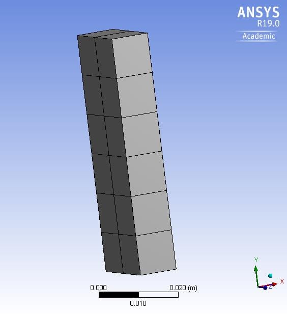

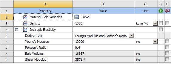

      I have a simple plate made of a linearly elastic material, that is fixed on top and has a force acting on it from the side. I want to have a very soft material and large deformation.
      For quicker testing, I used a very coarse mesh.
      I need to use fixed time step. I tried out some step sizes.

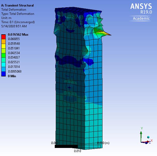

      With step size 0.01 sec, this error occurs instantly:
      Element 1 located in Body "SYSSolid" (and maybe other elements) has become highly distorted.  You may select the offending object and/or geometry via RMB on this warning in the Messages window.  Excessive distortion of elements is usually a symptom indicating the need for corrective action elsewhere.  Try incrementing the load more slowly (increase the number of substeps or decrease the time step size).  You may need to improve your mesh to obtain elements with better aspect ratios.  Also consider the behavior of materials, contact pairs, and/or constraint equations.  If this message appears in the first iteration of first substep, be sure to perform element shape checking. Named Selections for the offending element can be created via the Identify Element Violations property on the Solution Information Object.
      Also the solution has not converged. Total Deformation output:

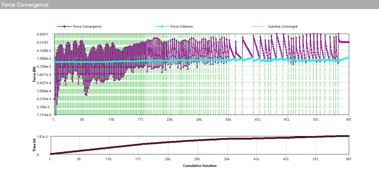

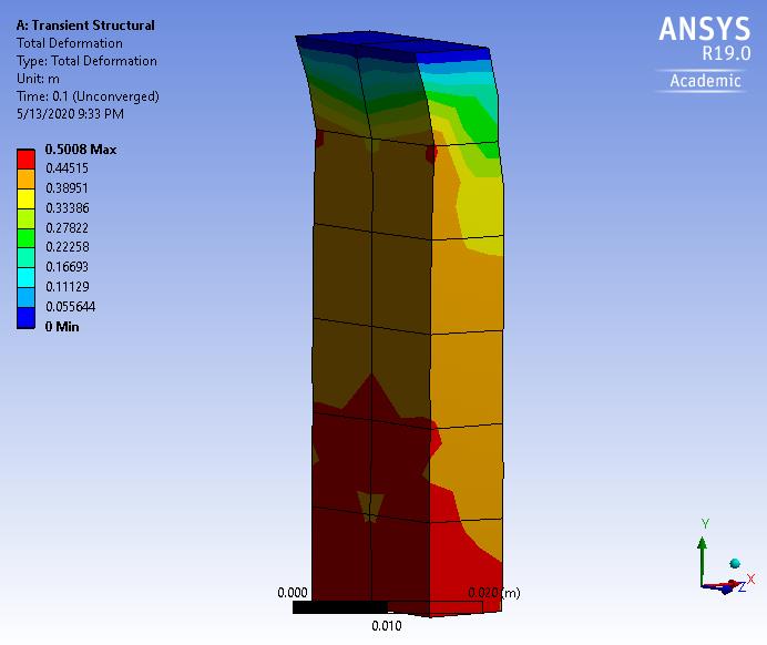

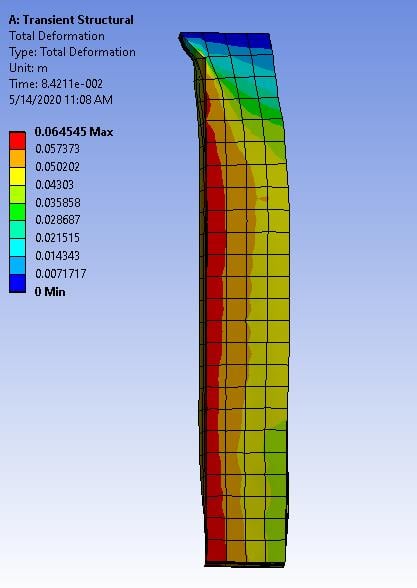

      With step size 0.0001 sec, the simulation stops converging at step 167.
      The shape has not even much deformed yet. Shown below is Total Deformation of latest result.
      With step size 0.00001 sec, it stops converging after step 4238 and still not much deformation.
      So I now reach 0.042 real time seconds instead of 0.017, but I have a ten times smaller step size and the simulation took about half an hour instead of ten minutes. It did not seem reasonable to me to keep reducing the step size.

      Please take into account that I am a complete novice and may have set an unphysical material or loading or such a bad mesh that it can not work.
      How can I know, how small does the time step have to be?
      Are there other ways to improve stability of the simulation?
      Can I expect a case like this to simulate one real time second in less than ten minutes on a 2018 AMD Ryzen 6 Core processor?
      If the error is in my setup: Can one calculate from the linearly elastic material what force is needed for a certain amount of deflection?
      Your elements are way too large!
      Set the default element size to 1/2 that size and rerun. Then set it to 1/4 that size and rerun. Compare the results between the two runs.

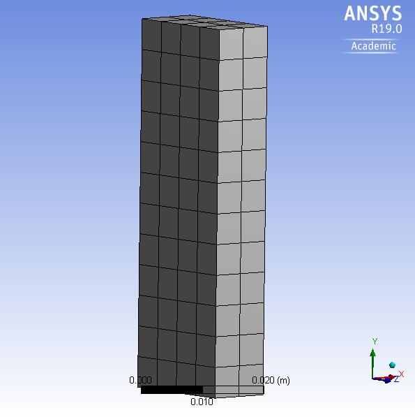

      Ok this is 1/2 element size:
      Step size 0.01 sec and 0.001 sec: Still high distortion error in first step.
      Same goes for 1/4 element size and above step sizes. I don't understand, why the mesh distorts like this.

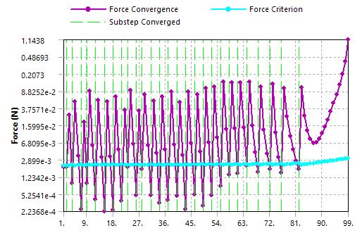

      1/2 element size and step size 0.0001 sec makes a new error appear after step 88:
      The solver engine was unable to converge on a solution for the nonlinear problem as constrained.  Please see the Troubleshooting section of the Help System for more information.
      Could some constraint or measure to account for the non-linearity be missing from my setup?

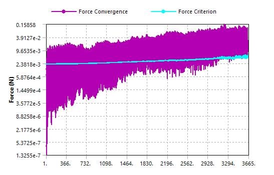

      1/4 element size and step size 0.0001 sec: high distortion error after step 27. Force convergence stopped like this:
      I did not try step size 0.00001 sec yet because such a small step cannot be tested quickly anymore.
      How can I know, how fine my mesh has to be for transient case and linearly elastic material?

      The last image looks like I may need stiffer material in the upper part. Although I am not sure how to do that. Might that be one thing to try?
       Thanks for the GIF, that was helpful.

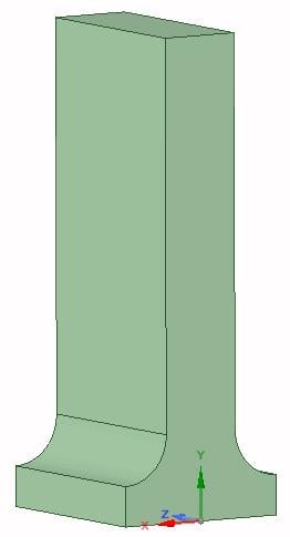

      The problem is the combination of the Fixed Support and the straight geometry, which together cause high distortion in the first element attached to the fixed face.  You can resolve this problem by either changing the Fixed Support to allow some deformation to occur there, while still holding the part. That means deleting the Fixed Support and replacing it with a Remote Displacement on that same face.  In the Remote Displacement, set all six constraints to 0. Most importantly, at the bottom of the Details window, on the Behavior line, change the behavior to Deformable.
      Another approach is to keep the Fixed Support, but change the shape of your part so that the first fixed element doesn't experience so much deformation. That means a shape like this.

      Here is my result using your tip with fixed support and altered shape: https://imgur.com/a/NfIDac4
      With step size 0.001 sec, I simulated 76 steps until it stops converging. That is a progress as I was only able to achieve that with smaller steps before.
      Deformation is happening now at the bottom first, resulting in a smooth bending that I wanted to achieve.
      However the deformation is still very small at the time it stops. I hoped for at least a 45 degree angle between the direction of the bottom end and the fixed support. Is there an approach that you would try to achieve that?

      EDIT: I also changed the force location to the lower left edge, which was the main reason it looked smooth. When I don't do this, and else have the same settings in above gif, I get a highly distored element error after 200 steps and this result: https://imgur.com/Tp7fsIw. I do not understand why a force acting on the whole left lower face, causes this and it seems like I am non the wiser.
