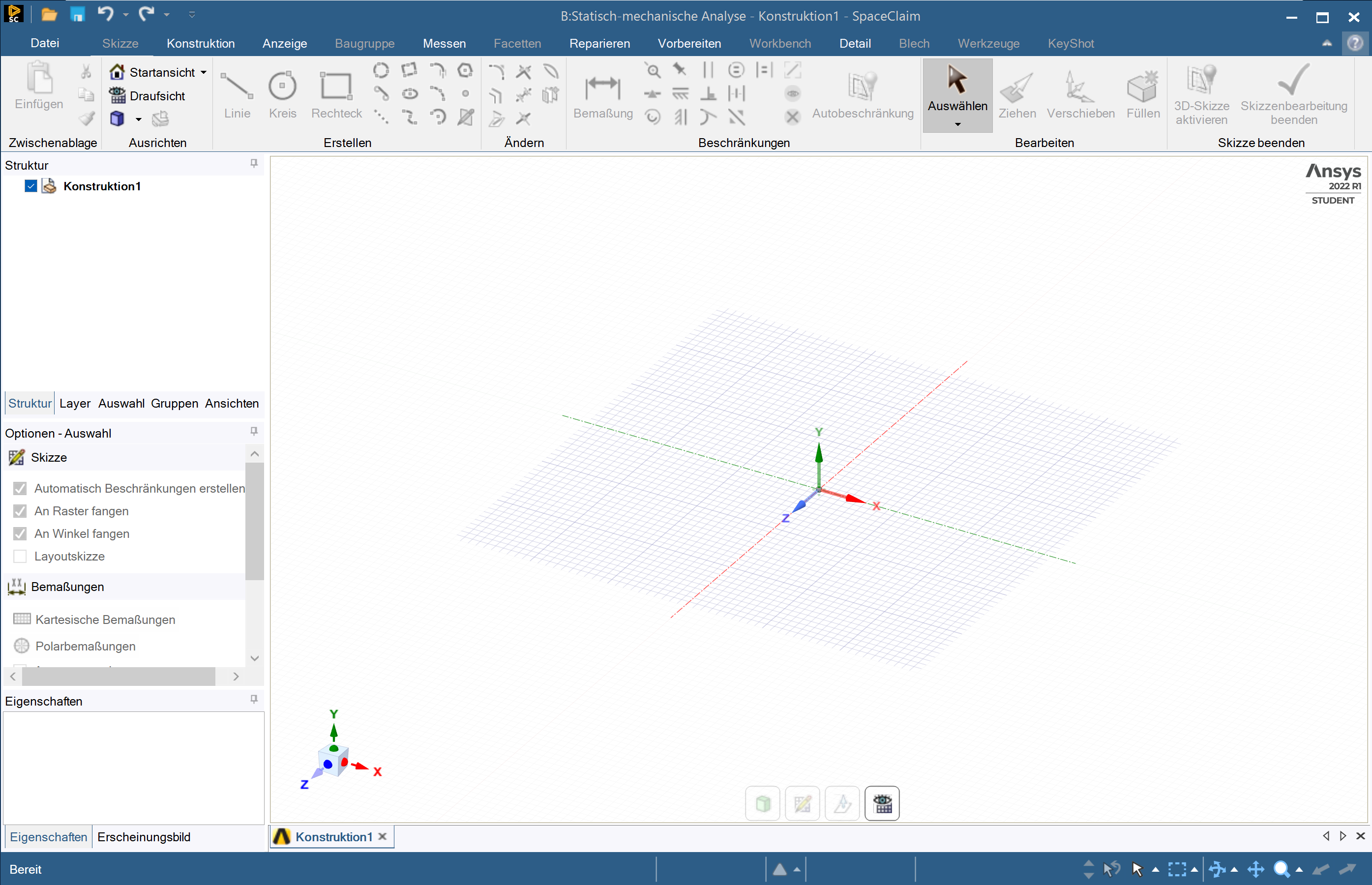

I am facing a display error when I try to use workbench. Other Ansys applications seem to be displayed correctly. I noticed nothing special in the install log. It was no error log created.
Ansys cannot be found among the installed applications of windows and I get Api-errors with dll-files of Spaceclaim when I launch Workbench (event viewer applications of windows).
Event viewer log messages look like this:
System.IO.FileNotFoundException: Could not load file or assembly 'SpaceClaim.Api.V3.dll' or one of its dependencies. The system cannot find the path specified. File name: 'SpaceClaim.Api.V3.dll' ---> System.IO.DirectoryNotFoundException: The system cannot find the path specified. (Exception from HRESULT: 0x80070003) at System.Reflection.AssemblyName.nGetFileInformation(String s) at System.Reflection.AssemblyName.GetAssemblyName(String assemblyFile) at System.EnterpriseServices.Internal.AssemblyManager.InternalGetGacName(String fName)
Removal of an assembly from the global assembly cache failed:Â C:Program FilesANSYS IncANSYS Studentv221SCDMSpaceClaim.Api.V4SpaceClaim.Api.V4.dllÂ
Please have a look at the attached screenshots and help me to find a solution.
