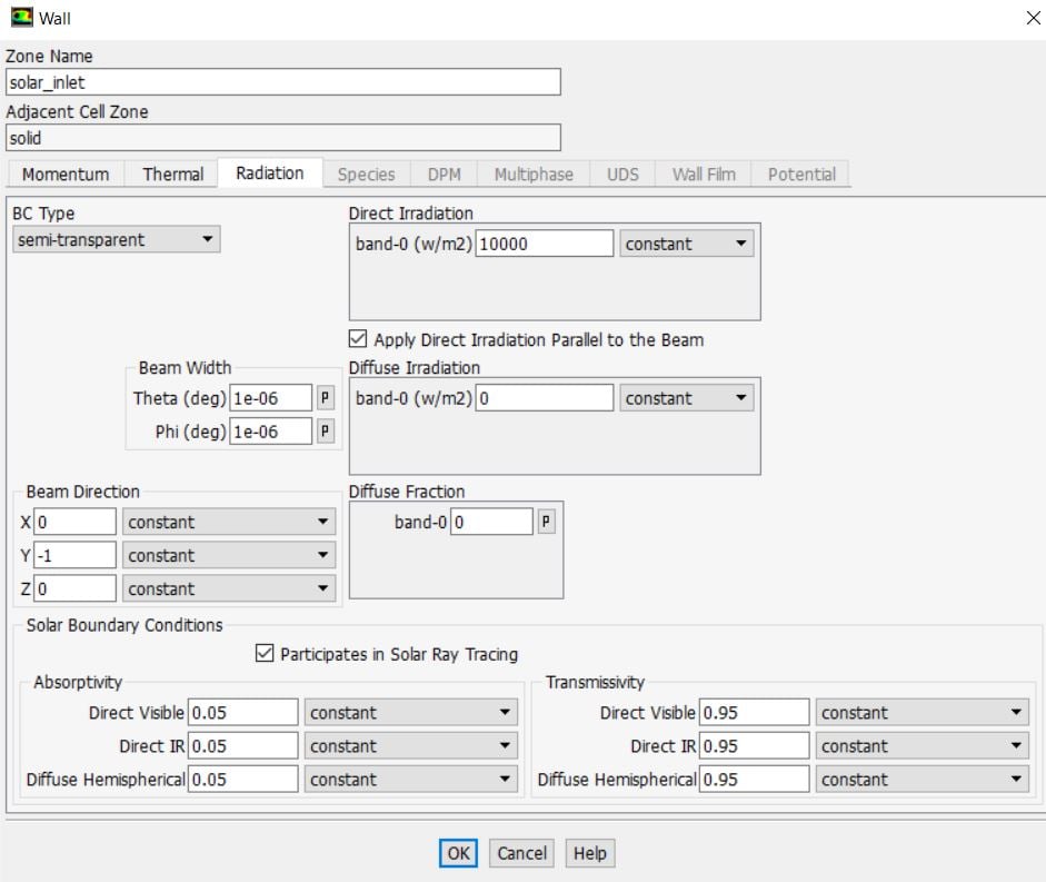

I'm trying to simulate the solar radiation for the solar collector using the DO radiation model available in ANSYS-Fluent. I'm using the solar ray tracing model as a solar load, and thus solar ray is converted to heat, and absorbed by the working fluid. I'm using the incident solar radiation value, 10,000 W/m^2 (, which is equivalent to 10 suns) as an input to the collector's top surface (Jusy a Face, not body), which is expected to be uniform on the face. I considered the non-gray surface and solar wavelength was in a range between 0.5um to 1.5 um.Â
I've checked with angular discretization, mesh study. Then, I've done the set up of the DO model following the above criteria, like as follows:Â
After that, I followed the necessary fluid properties, and set up for the solar inlet face as follows:
I found a good convergence, but I'm not sure about the outcome (Wall flux--->surface incident radiation, /m^2), as it shows not exactly the same value that I input as incoming solar radiation. Moreover, wall flux--->sun heat flux is zero on the top face.Â
andÂ
I suspect the reason for such a curve rather than a uniform manner is the absorption coefficient value of the working fluid. In fact, there is no solid body considered for glass (solar window) but only face.Â
Could you please guide me, whether my DO model set up is ok or not?
Is the direction value ok in terms of Sun direction vector, beam direction?
And, which solar radiation value (surface incident radiation/incident radiation) represents my actual incoming radiation?Â

Non-gray DO model has been applied in order to solve the radiative transport equation (RTE) for the solar collector system. Meanwhile, I've to use wavelength-dependent optical properties of working fluid in simulation. The full details of this method can be found in many references.
Again, the sun’s rays that enter the computational domain can be modeled by the ray tracing algorithm. By applying the solar load in ANSYS-Fluent, the calculated heat by the ray tracing algorithm is coupled to the energy equation via a heat source term.
What happens in simulation in terms of energy equation If I (1) check only the DO and uncheck the solar ray tracing (2) uncheck of the DO and check with only solar ray tracing, and (3) checking both DO and solar ray tracing in the radiation model?
Is radiation in DO model, and solar heat flux in solar load represent the same incoming daylight solar radiation?
Then, how to set up the radiation model for my case?Â
Actually you do not need to set anything apart "Solar Ray Tracing" settings under "Radiation Tab".
Response:
Regarding the radiation tab for the "solar inlet face/solar window", then, how I will define the beam direction as it appears in both cases (DO/solar ray tracing) when checked?

Ansys EmployeeSolar load model calculates for you the thermal load either automatically by providing where you are or explictely by providing the fluxes as you did in the solar load panel. -
November 20, 2019 at 1:30 am
Juwelmojumder1
SubscriberWhat happens if I only check with DO model and nothing in solar load?
If I do so, I get radiative heat flux on the window surface too. But there is no surface incident radiation under 'wall flux'.
