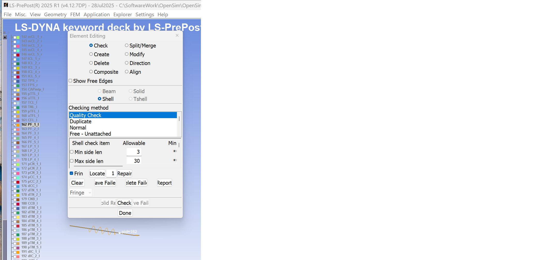

      I have a question about the visualization of discrete elements in LS-PrePost.
      **Situation:**
      I am converting OpenSim ligament PathPoints to LS-DYNA discrete elements.
      For Part 162 (ligament "PF_1_l"), I observe the following:
      **Element Definition (appears correct):**
      - Element Type: Discrete (ELEMENT_DISCRETE)
      - Part ID: 162
      - Section ID: 1 (defined with *SECTION_DISCRETE, dro=0.0)
      - Material: MAT_SPRING_ELASTIC (k=1.0e+02)
      **Node Coordinates (verified correct):**
      *ELEMENT_DISCRETE
           143     162  151482  151483
           144     162  151483  151484
      *NODE
        151482      -87.181466     -548.693127      -81.686165
        151483       42.775456     -540.134008      -63.059371
        151484       51.532392     -535.475940      -60.655600
      The coordinates form a nearly straight path (3 points, 2 segments), which is correct.
      **Issue:**
      In LS-PrePost visualization, the discrete elements appear as a **spiral/helical shape** instead of straight lines between nodes. However, I can also see what appears to be a **darker straight line** in the same location.
      **Question:**
      1. Is this spiral visualization caused by LS-PrePost automatically generating "null beams" for display purposes, as mentioned in the manual?
      2. Will the actual calculation use the correct straight-line discrete elements defined by the node coordinates?
      3. Can I safely ignore the spiral visualization and proceed with the simulation?
      I want to confirm that the element definition is correct before running the analysis.
      Thank you for your help!
