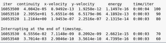

      I am working on a 2-phase flow simulation on an HPC cluster. The simplest case uses a single node with 24 cores and 8gb RAM per core (reserved the entire node). When I start the simulation I see a wall-clock time per iteration of around .017. Visually, the console shows quick residual printouts per iteration that matches this speed. However, over time this visual printout in the console slows down. When I check the Parallel -> Usage tab I see roughly the same wall clock time per iteration. When I time it with a stop watch I get a completely different value (much higher). If I pause and re-start the simulation the console printouts appear to speed up again.

      It is tough to show exactly what I mean since the time/iteration and the Parallel -> Timer -> Usage -> "Avereage wall-clock time per iteration" are roughly the same throughout the simulation. However, when I watch the console in real time it is clear that there is a slow down.
      "Slowed Down" Speed:
      Initial Speed:
      Pause and re-start to me means hitting "stop at the end of time-step" waiting for the simulation to stop and then pressing calculate again. I am sure that we would see the same speed increase by saving the case and data and re-opening another instance of fluent.

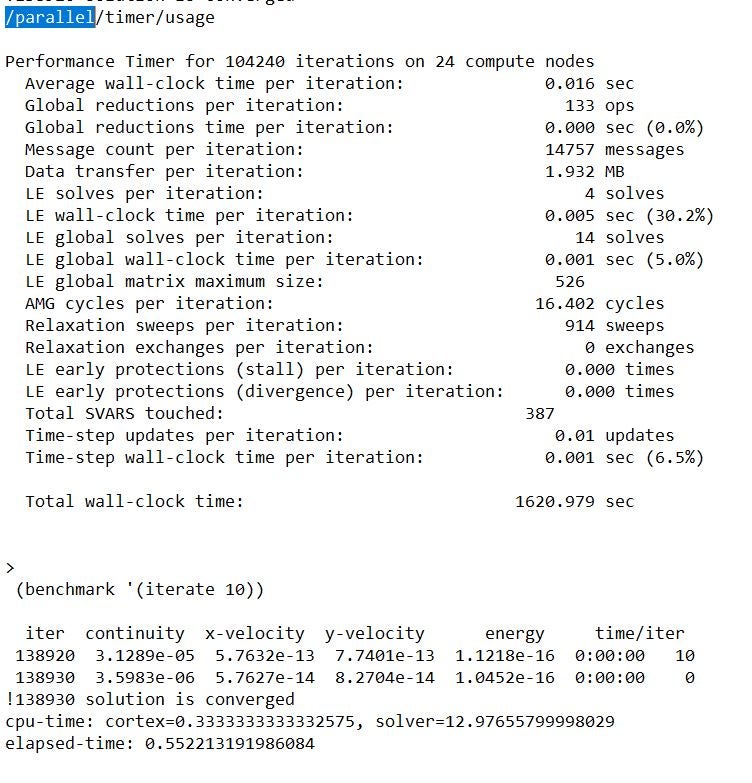

      I attempted to output /parallel/timer/usage and (benchmark'(iterate 10)) every 1000 timesteps to see where the issue could be occurring. I also compared the difference between running in batch mode vs. running in the cluster OpenOnDemand GUI. Typically I have been running interactive Fluent in the cluster GUI since it makes it easier to see simulation progress over time. It seems like the GUI has a similar parallel usage time, but higher benchmark values. The following are done after the same number of timesteps (1999)
      GUI:
      Batch:
      I am not sure on the meaning of the benchmark values (cpu-time, solver, elapsed) - can you please let me know? I haven't found much documentation on this online.
    • Amine Ben Hadj Ali
      That is the time including all I/O and solver time -> Elapsed time. It seems that the batch solution requires much less time compared to the GUI one for the 10 iterations. The other output is not really helpful as you have done it for different number of iterations (or your time steps required completely different number of outer iterations) but does not depict huge differences.
